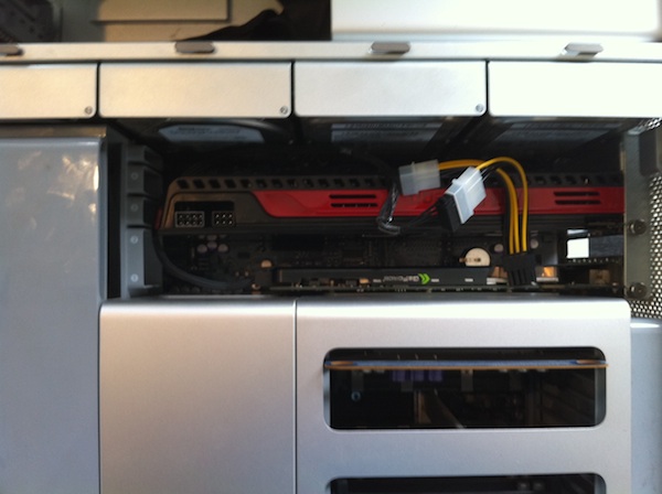

Well, that was super interesting. The HD5970 came with a 2 x 4-pin molex to 8-pin (yay) and I decided to test it in Windows by taking the 6-pin power off my 8800GT and onto the behemoth. Which, by the way, just about fits into the chassis.
With power not yet attached. The midget card below it is the 8800GT.
In the end I removed the hard drives, CPU heatsink cover and front fan assembly to reroute the optical drive power cables to the midsection -- with the cable running across the top, the case wouldn't shut. There's instructions on doing this in the service manual, which I won't repost here for legal reasons. Easy enough, though.

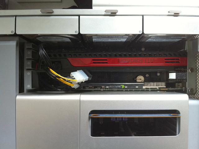

I picked up the extra cable and connected the 8800GT. No issues booting OS X with both cards in it and fully powered -- other that I can't get the display drivers by netkas working yet (not initialized) for the Radeon -- and the EFI. Windows, however...
Windows doesn't like two brands of cards in one computer so I had to remove the nvidia drivers. Still, with the card powered I suspect the EFI tries to hand over display output to the geforce and the ATI gets no signal to the screen. My current solution is to remove the PCI power cable from the geforce, which prevents it from operating, before booting into Windows. The HD5970 then works.
(on flickr)
