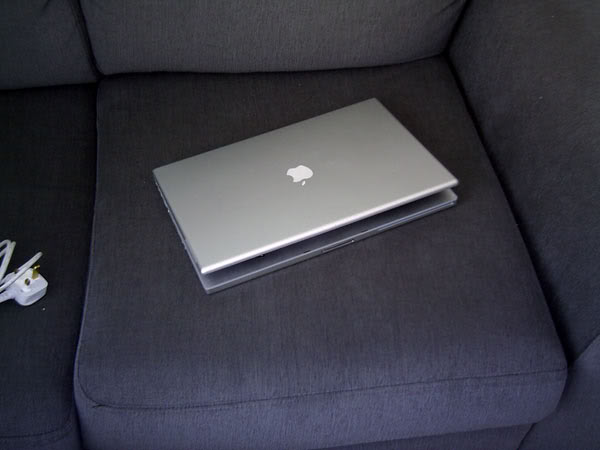

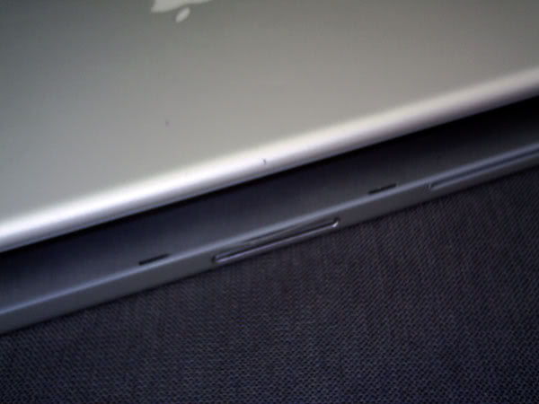

My mate phoned me last night and asked if I could have a look at his 17" PowerBook as it was having trouble starting up.
When I saw it I wept...

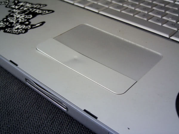

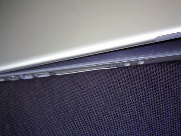

1st the latch no longer works:

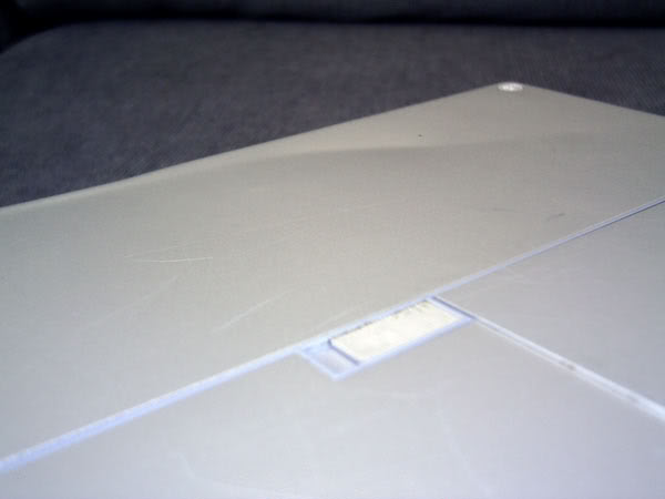

There are dents everywhere!

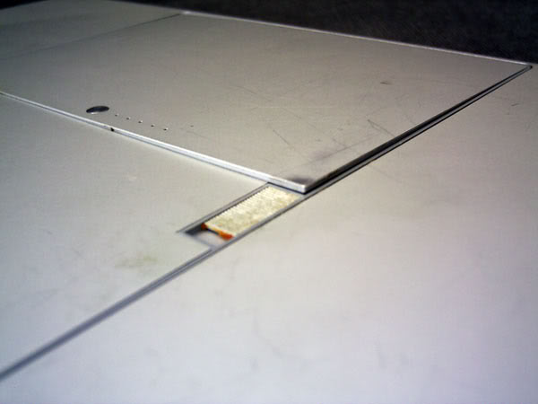

The Battery is loose:
And there's a dent in the lid that affects the screen:

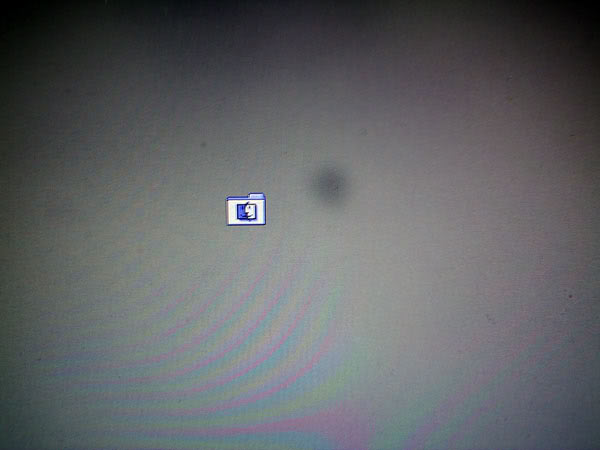

Instead of starting up it goes to the Open Firmware screen. When you type Mac-Boot is just displays the flashing question mark. It won't find any OS folders when you hold Option. Anyone got any ideas?

Is that a STICKER on the left palm rest? He actually put a sticker on it?

There's a sticker on each side.

Have you tried bringing up the HD on it in target disk mode, or booting off an install DVD?

It won't boot off the dvd using 'C' on start up. Does anyone know if there is an Open Firmware command to get it to boot from the DVD?

I've managed to get it to work once, then I tried to use the Hardware test and it won't work at all now.
Yeah, it's most likely HDD failure although considering it's condition you can't rule out some deeper hardware problems. Looking at the way it's been chucked around there could be loose wiring, something overheating, anything really.

Oh, I was never clear... so won't boot off HD, won't boot off DVD. But what about Target Disk as a slave to another (your) mac?
mkrishnan said:
Erm... is your avatar his bloody knee? 😱 🙁
Nope. Won't boot off either. Not sure about Target as I haven't got the right firewire cable.
The HD spins but doesn't seem to read, there's no additional noise except the spinning.

SUCCESS!!!!
IT'S ALIVE!!!
It was a dead Airport Extreme card.
With that removed it works!!!
Now I'll smack him round the head with it!!!
EDIT: That was fun, it's not often you get to mess around with the insides of a 17" PowerBook!
