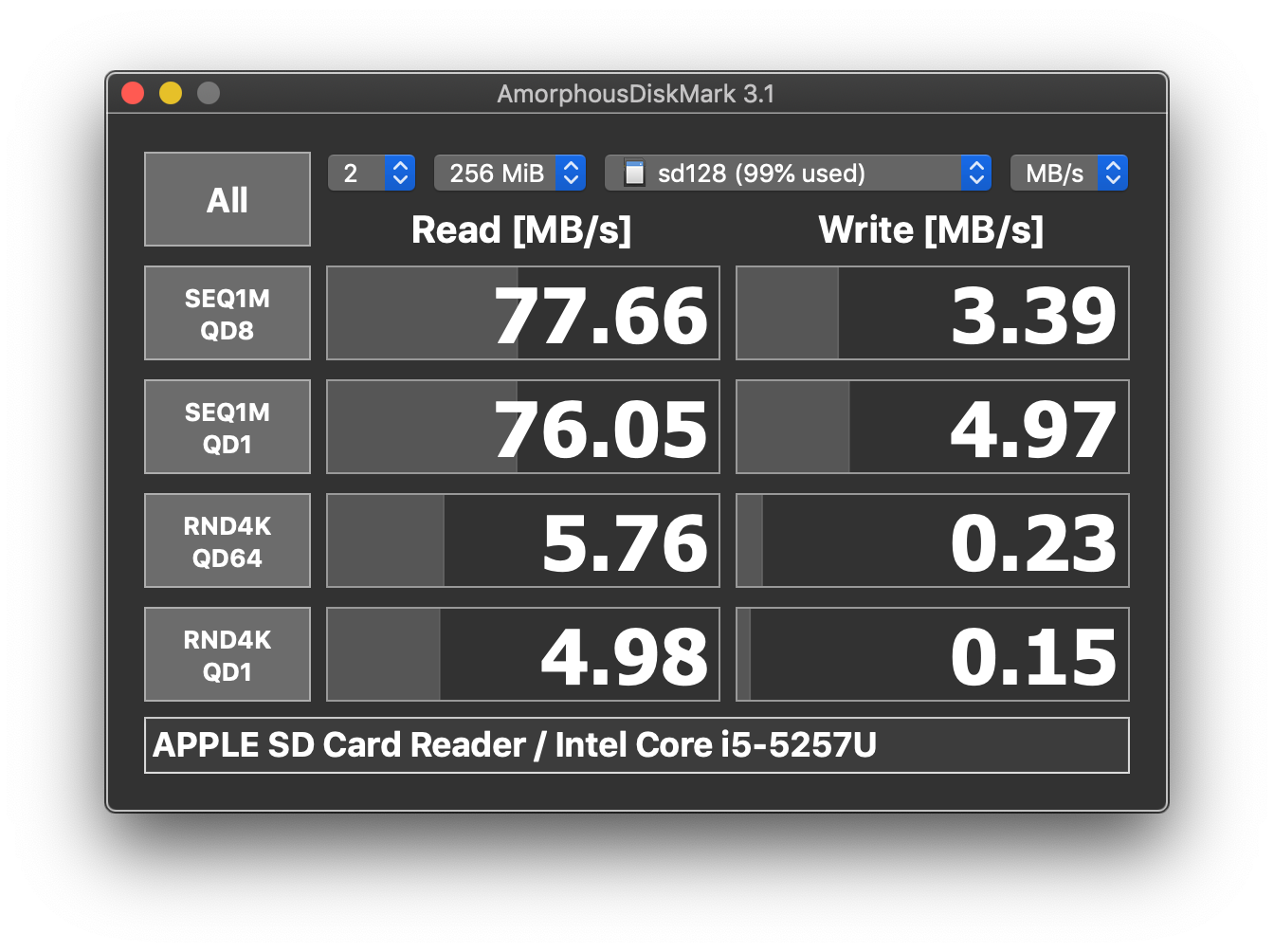

I tried a quick test copying my Documents folder to the SDXC card. That's about 4.5GB with about 15,000 items -- the easiest " full of small files" folder I could find.
That copied over at essentially 80MB/s with a small glitch in the middle. Substantially better than I actually expected -- the combination of APFS and solid state storage is pretty damned impressive!
The drive of interest below is mjh (the one with the little SDXC icon next to it) and the two red areas show
(first one) a bulk write of some large files and
(second one) the write of the 4.5GB with 15,000 items.
Of course to get great performance you want to use at least JHFS+ and ideally APFS.
So many people seem to be using their external storage (whether SD card or SSD or hard drive) as whatever they bought it as, which is usually some version of DOS FAT, and is, of course, TERRIBLE in performance -- but that's all on the file system, not the actual hardware.
A folder full of small files might not be very random, depending on how closely the filesystem lays them out on disk. You're best off using a benchmarking tool like AmorphousDiskMark (since BlackMagic only does sequential) for this. Even though it's solid state, random is a lot slower. SSDs suffer a lot less than HDDs do with random writes, but they still suffer, and I think SD cards suffer even more, just from experience. Online results like this agree for SD cards. They're made for media, so it makes sense.
On my JHFS+ formatted SanDisk Ultra XC1 MicroSD card, albeit one filled with junk. Random write is ~1/20th the speed of sequential write:
