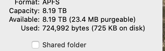

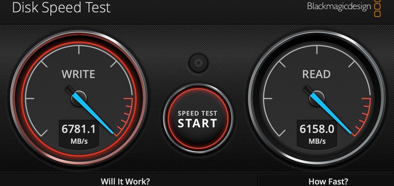

Yeah, my authorized retail supplier in Los Angeles, who got me the Mac Pro and Cinema Display within 24 hours of ordering this week, says that the shipment of the 4x4 has gone from 3 days to sometime in march. I asked them to keep the order and went with 4 of these little PCI adapters to get me by for the time being. (chosen because the black matches that back of the computer #dontjudgemeyoureprobablythiscrazytoo)
Some M.2 heat syncs:
The obvious problem with this set up is that it takes up 4 PCIe slots, but it was the best cheap/temporary solution I could find without using bifurcation or spending the same money on 2 2x slot adapters as the 1 slot sonnet option. Most of the 2x NVME us one 4x port and one data 3 cable as a cheap/slow option. Don't go there.
The results speak for themselves. While not ideal, this setup cost less than $1000.
