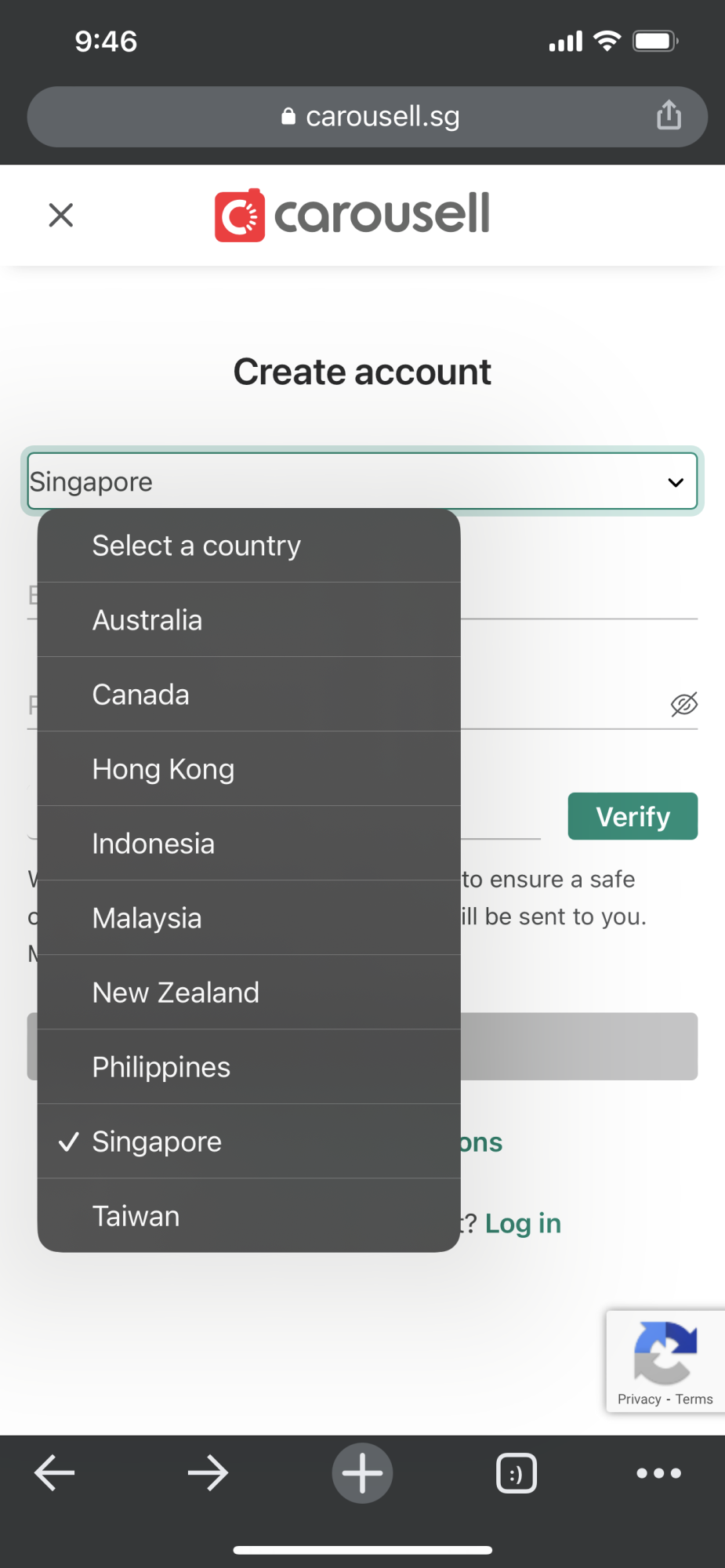

I snagged it! Thanks for the tip!
Now I just need someone to sell me an OG VESA mount for the 30" cinema display...
