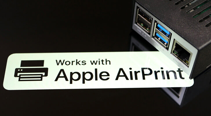

Pretty sure I *used to* have a BT dongle, not sure if it is still with me...
RE: the printer, I am temporarily giving in to the whole AirPrint thing. It seems the simplest solution. Of course it isn't really *that* simple given that the printer doesn't have WiFi installed. But I do have a couple of Raspberry Pi's lying around doing nothing in particular right now, soooo...
