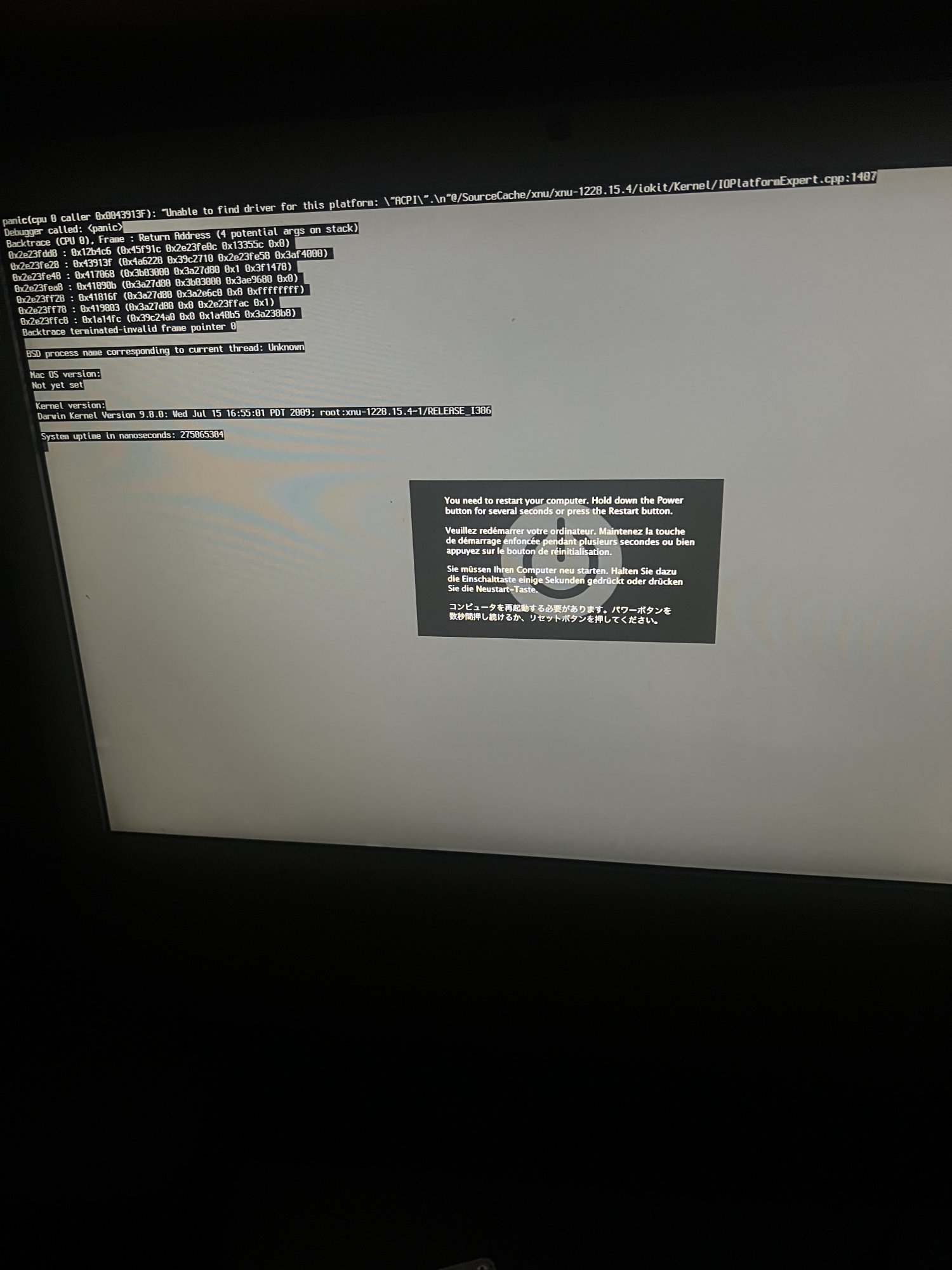

This is the error I been getting ever time.
This is a kernel panic. It can be caused by e.g. a corrupted download or an error while writing the image to the hard drive (or SSD). How big is the image you downloaded after extracting, and how have you been restoring it to the hard drive (or SSD)?

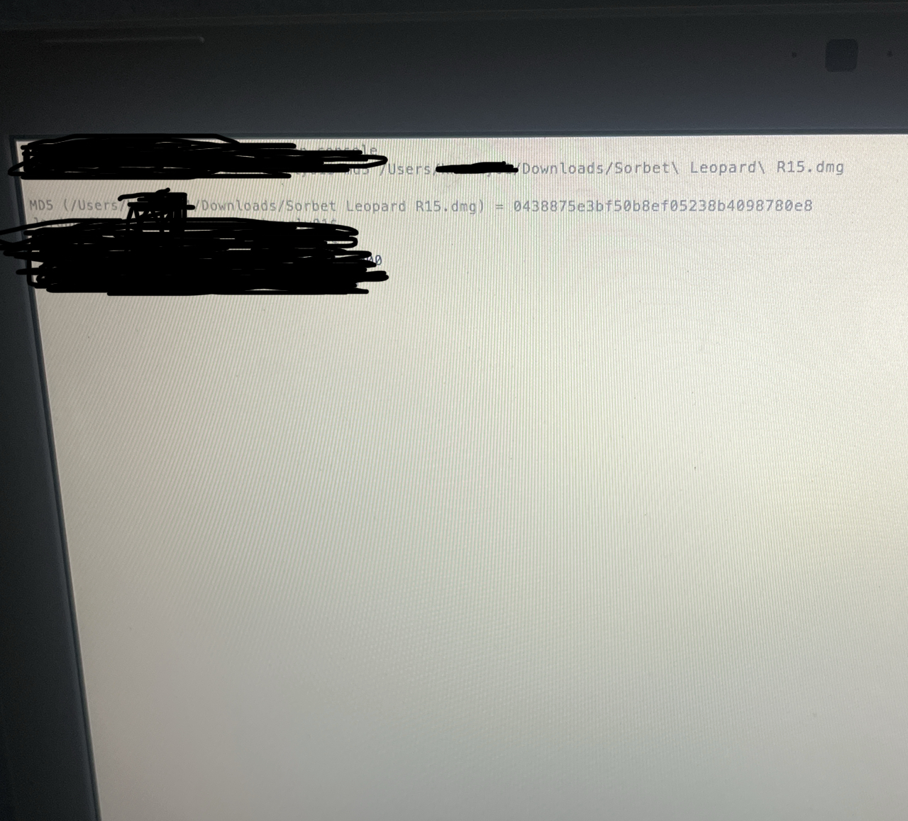

The size sounds right for the R15 dmg. Is the MD5 checksum of the dmg 0438875e3bf50b8ef05238b4098780e8? To check, open Applications > Utilities > Terminal, type md5 followed by a space, drag the dmg into the Terminal window and press Enter. If you get a different checksum, the dmg is corrupted.

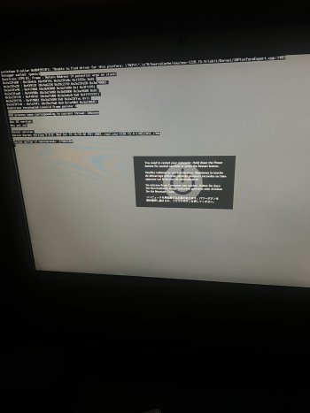

What happens if it’s a hardware problem. And I even tired in my friends PowerBook g4 and the same thing happen. The dmg is not corrupted so it either a hardware problem or the restore process. Is there a way to fix that problem to make it boot?
Wait a moment… are you trying to install Sorbet Leopard on an Intel Mac? That appears to be an A1181 MacBook.

No I use that MacBook to download it since it was downloading slow on the ppc but I tried to get it running in my ppc but used the terminal on MacBook to see if it was corrupted or not.

Are you sure your iMac is in fact a G5? I'm aware of there being iMac G5 models with the built-in iSight camera but I just want to make extra sure it's not a hardware incompatibility, because that RELEASE_I386 identifier in the kernel is very suspicious.

Are you sure your iMac is in fact a G5? [...] that RELEASE_I386 identifier in the kernel is very suspicious.
Whoa! That's a very good point. Giving it a second look, the "Unable to find driver for this platform: ACPI" error message is also very suspicious.
