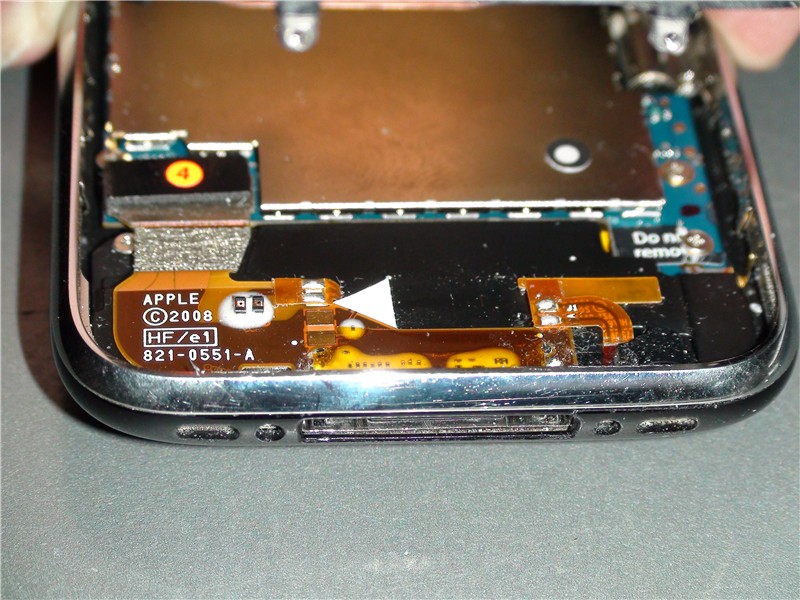

Poor build quality on speaker module
I have an iPhone 3G, and I had the same issue a while ago. It seems that the issue is with the build quality (or lack thereof) of the combination speaker/mic/antenna/buzzer/dock connector module at the bottom of the phone. There it develops a short in the connection, which being intermittent, will result in the external speaker failing to reproduce sound.
I have noticed the following things:
When you squeeze the phone from the sides, in line with the home button, sometimes this will (temporarily) correct the issue.
I found a slightly more permanent fix (lasts days instead of minutes).
I was able to determine that the short is located where the 2 pieces of flex circuit come together, near where the home button makes contact with the module. (The two exposed copper rectangles.)
I cut a piece of business card into a triangle and jammed it under the flex circuit as shown in the picture. This seems to correct the issue, and lasts until the paper gets dislodged by the vibrations in the speaker. I have to 'reset' the paper chip every few months, but it's better than not hearing an incoming call!
Hope this helps.
Cheers!
