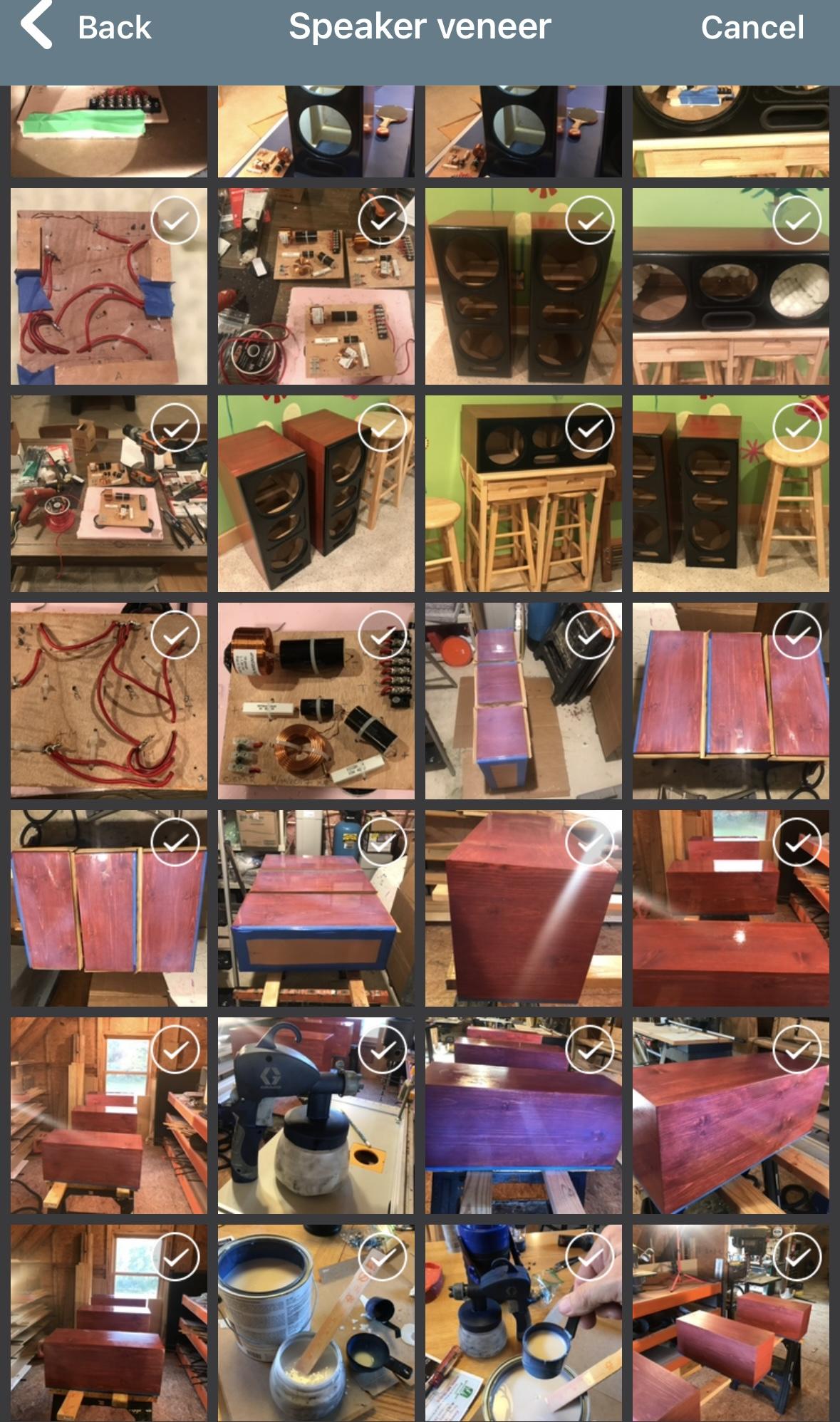

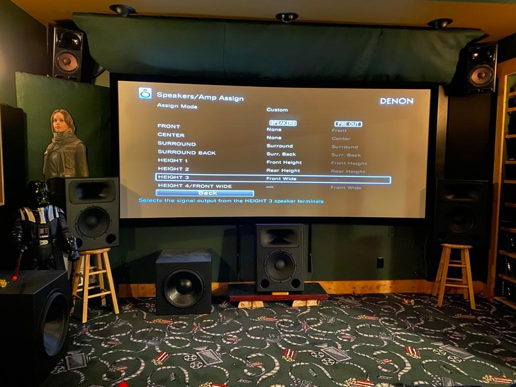

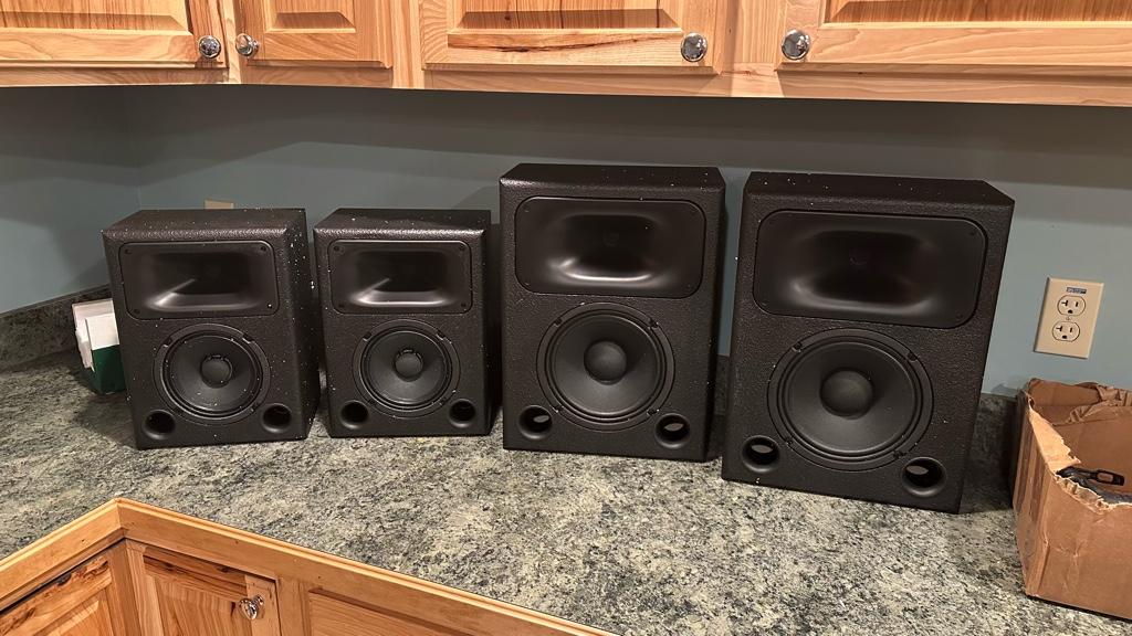

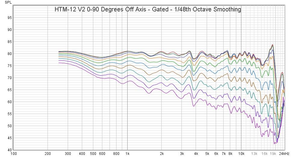

Yea I’ve built my own speakers for both dedicated HT in basement (9.2.6) and family room (5.1.4). Having similar off axis response to on axis does help immensely for many acoustic matters.
These are the front wides (smaller ones) and the larger ones serve rear sides / surrounds and atmos front and rear height duty
This was upon completion the mains, before went AT screen. Those are 15” wide waveguides with 12” woofer. I was trying different locations

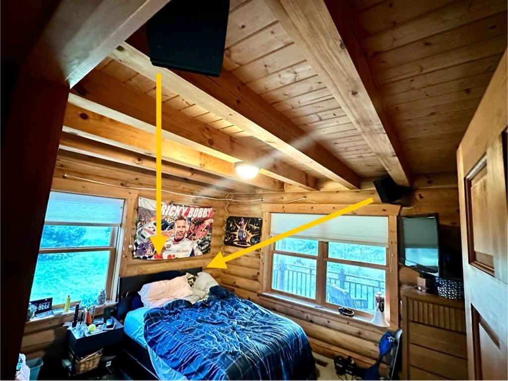

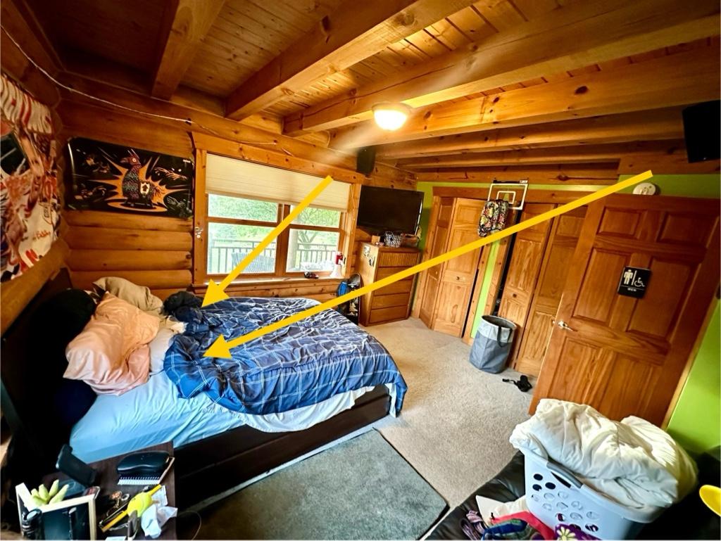

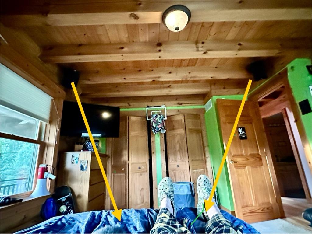

This is my son’s room.
I put decent bookshelves as shown, angled them at MLP, center of bed.
Truly sitting there, watching that 40” TV, you do get very good imaging and it adds to the viewing experience.
Any soundbar tucked there would NOT do same, not possible.
Suggestion for this setup: get that TV mounted on one of the ceiling beams- probably the same one to which you mounted the speakers- roughly centered between the 2 speakers.

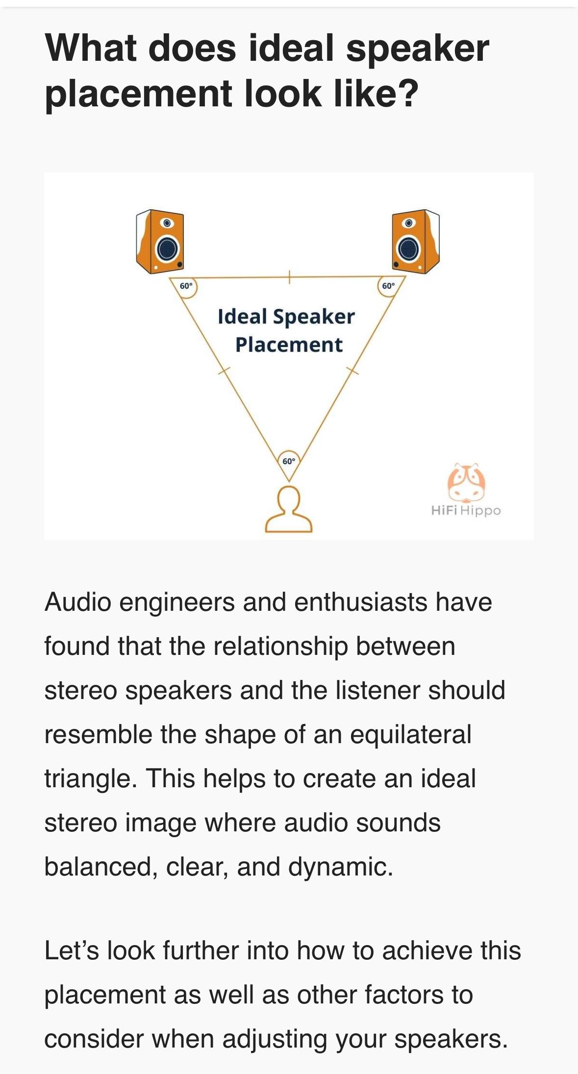

You are right about the "triangle" concept but when set up and used for Home Theater instead of only music- if that's what you are doing here- 2 speakers are going to create a faux center speaker in between them. As is, TV screen far left (under left) speaker is fairly distant from the faux center "channel," which is where most dialogue plays.
It may seem fine as is but it will likely be a noticeable improvement if you ceiling mount the TV roughly between the 2 speakers... as then almost all dialogue will seem to come from the TV instead of off to the right of it.
Now, I don't see how you are getting audio to the speakers. If these are perhaps self-powered speakers not powered by Receiver or AMP, they are only going to play mono each or perhaps stereo as a linked pair... and not create the faux center. But if you are working through a Receiver or Home Theater amp, center channel sound would be faked by them and sound like it is coming from about dead center between them. A viewer's ears from that bed would likely notice... and may even perceive that it seems like audio is improved.
Another option if Receiver is involved is hang the TV in the center as described and mount a true center speaker- perhaps down firing from that ceiling- perhaps a bit in front of TV (perhaps one ceiling beam closer to the bed). This would switch it from what would be a called a 2.0 system now to a 3.0 system (true left + center + right).
Lastly, you could easily put a SUB in such a setup about anywhere in that room too for lower lows, yielding a 2.1 or 3.1 system. And then you are only 2 more wire runs from being able to put a left & right surround speaker back on each side of the bed to make it a true 5.1 surround sound system (which would be VERY noticeable from that bed, when watching anything with surround sound audio).
