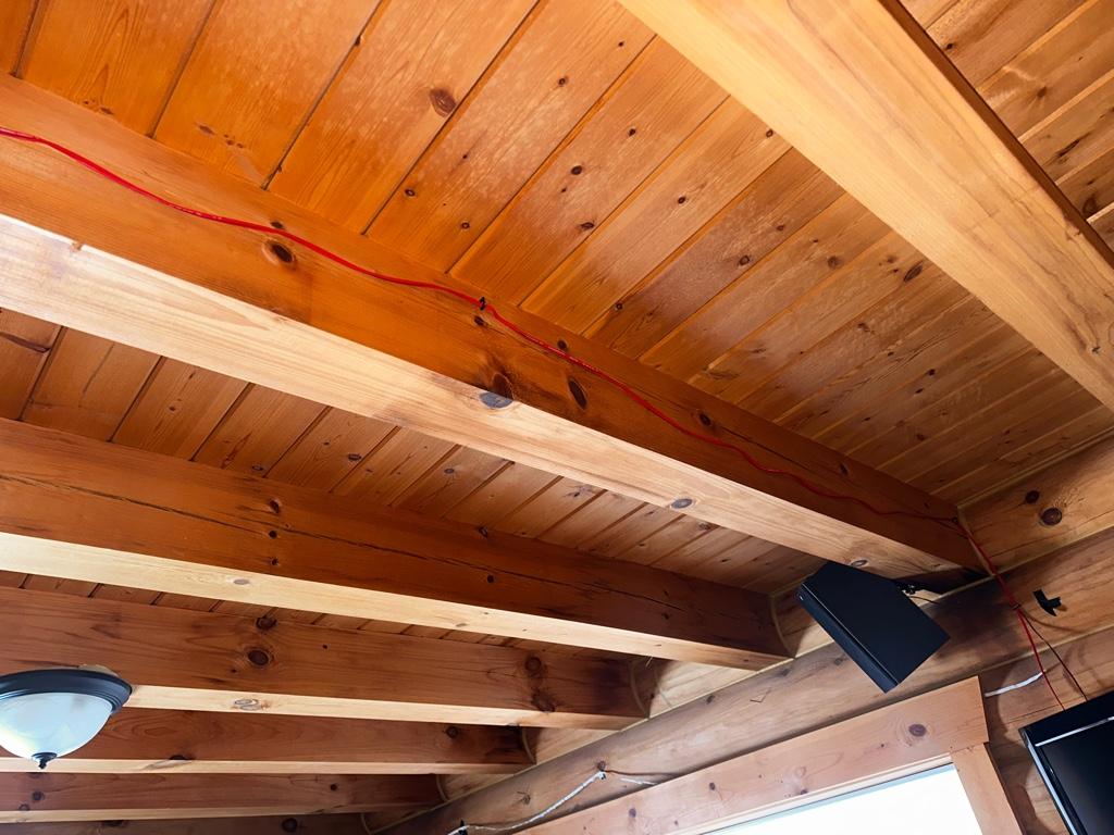

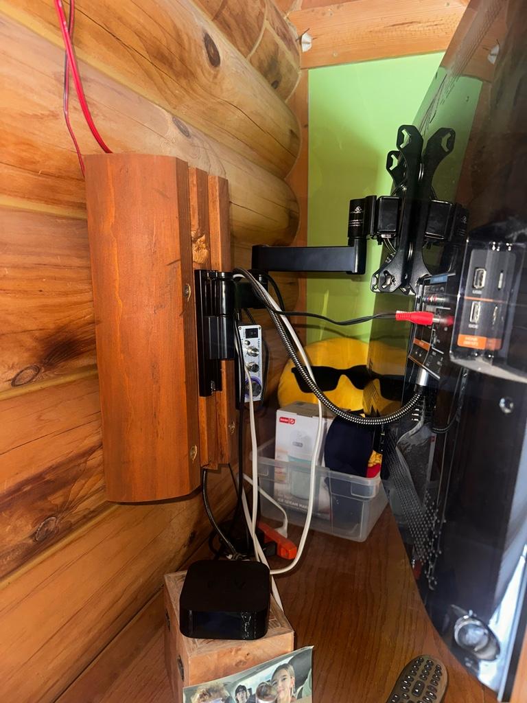

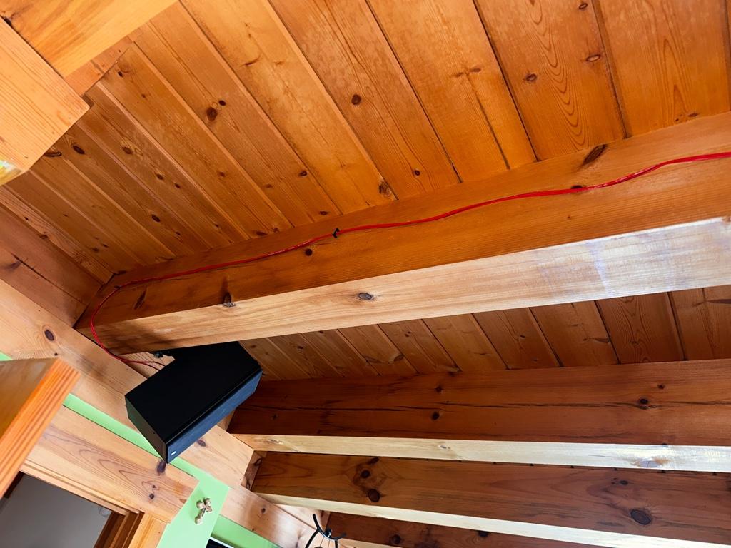

Suggestion for this setup: get that TV mounted on one of the ceiling beams- probably the same one to which you mounted the speakers- roughly centered between the 2 speakers.
You are right about the "triangle" concept but when set up and used for Home Theater instead of only music- if that's what you are doing here- 2 speakers are going to create a faux center speaker in between them. As is, TV screen far left (under left) speaker is fairly distant from the faux center "channel," which is where most dialogue plays.
It may seem fine as is but it will likely be a noticeable improvement if you ceiling mount the TV roughly between the 2 speakers... as then almost all dialogue will seem to come from the TV instead of off to the right of it.
Now, I don't see how you are getting audio to the speakers. If these are perhaps self-powered speakers not powered by Receiver or AMP, they are only going to play mono each or perhaps stereo as a linked pair... and not create the faux center. But if you are working through a Receiver or Home Theater amp, center channel sound would be faked by them and sound like it is coming from about dead center between them. A viewer's ears from that bed would likely notice... and may even perceive that it seems like audio is improved.
Another option if Receiver is involved is hang the TV in the center as described and mount a true center speaker- perhaps down firing from that ceiling- perhaps a bit in front of TV (perhaps one ceiling beam closer to the bed). This would switch it from what would be a called a 2.0 system now to a 3.0 system (true left + center + right).
Lastly, you could easily put a SUB in such a setup about anywhere in that room too for lower lows, yielding a 2.1 or 3.1 system. And then you are only 2 more wire runs from being able to put a left & right surround speaker back on each side of the bed to make it a true 5.1 surround sound system (which would be VERY noticeable from that bed, when watching anything with surround sound audio).

1) The bottom of the log ceiling beams are 8 feet tall, the TV is mounted as shown on the left side wall, above the dresser. It is NOT moving, putting it mid-room will be a head banger ..
2) originally using just the TV speakers zero stereo as distance way too far , poor sound quality, yada yada

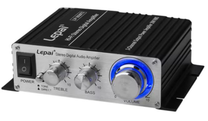

3) I had a leftover Lepai amp from another project I did for fun, just 20wpc but enough for this application, it's popular on parts express for simple stuff like this, I'm sure you've had these small digital amps and been amazed at their value for the $'s

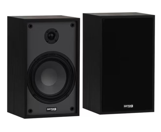

4) I had leftover Dayton bookshelf speakers I had "won" via charity raffle at a local gtg amongst 20 other HT enthusiasts , we get together every 3-ish months and rotate hosting them / attending them, these are HT and audio room demos / sessions. We also contact some vendors to get swag and hold a fund raising raffle at each gtg for some local group in need. Kinda like a pay-it-forward thing.

I didn't know all that about you and that it was a conscious choice to put the TV under the left speaker, etc. I too have fairly significant expertise in home theater and saw the opportunity to not just potentially help you make a set up better (if you didn't know) but also 100 or a 1000 other people that might be reading this thread up to years from now who might see those photos and think TV under left speaker is fine for them too.
For example, LOTS of people think they want to put a TV in the corner of a room... which then complicates the speaker layout if they want a good surround sound setup too. Yes, it can work and yes they can do it if they really want the TV there but it often helps to clarify about where left, (center) & right should be relative to the TV. Your post did that by showing them the triangle image... but then your picture showed the TV not centered between them. To the "not A/V installer/knowledgable" that might imply get the speakers spread as shown in the triangle but put the video screen anywhere.
Now that you've shared additional detail, THEY will know that you were not going for optimal but just "using leftovers" etc. for "decent" sound, which is good enough for a teenager bedroom. Nothing wrong with that if they are doing the same. However, if someone is really going for ideal, now they also know a few other things to help them achieve it in their environment.

Wired as shown behind the beam, nobody really sees it as you have to be by the closet looking up.
That little digital amp is actually impressive for cost and sound it drives the speakers to.
