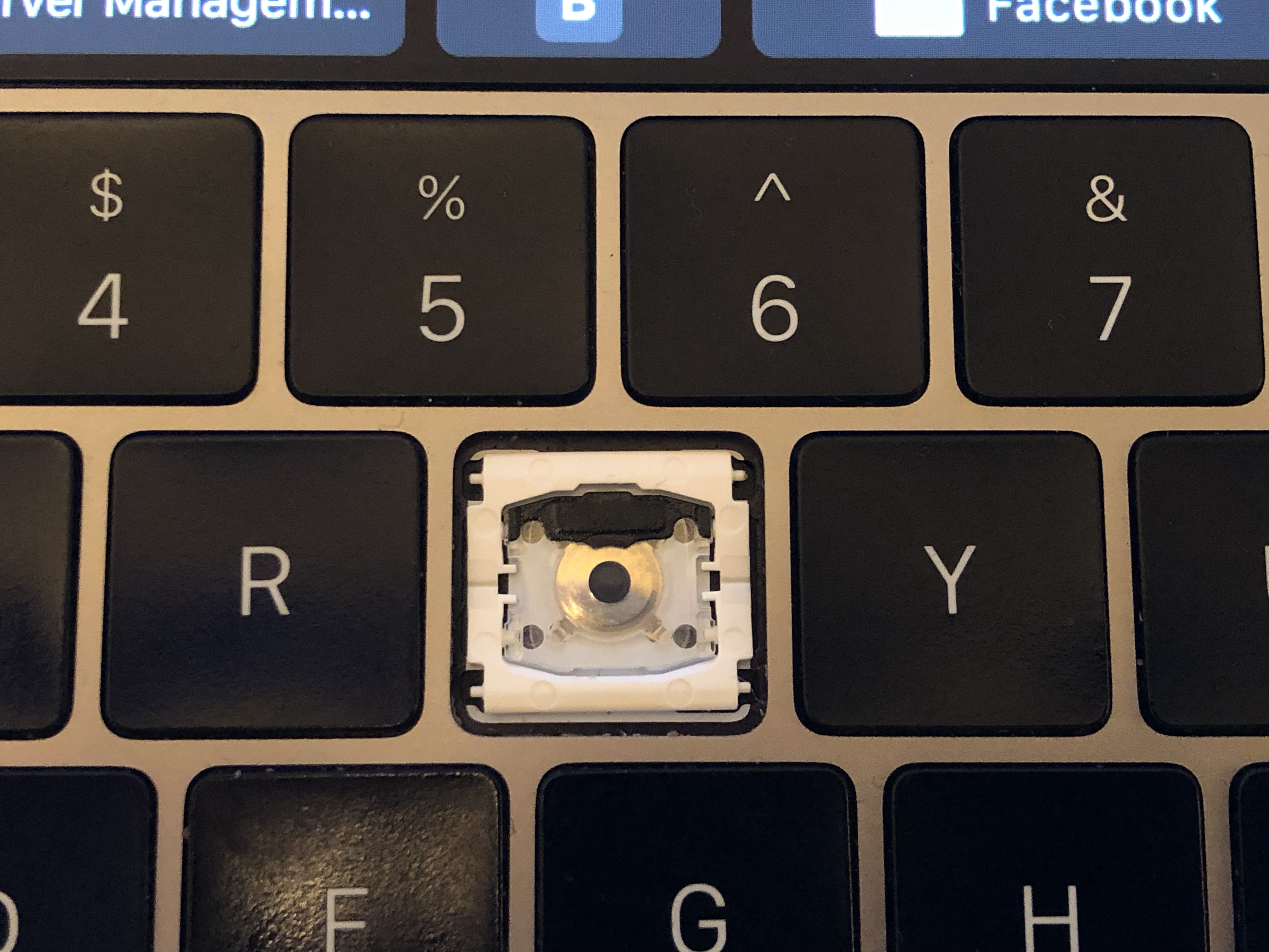

I had a 2016 MBP whose keyboard that I completely abused as an experiment. It held up. Apple has said that the silicon barrier was done for acoustic reasons and not to protect against dust. I think they're actually telling the truth.
See the photo below. That's a first gen MBP butterfly from my 2016 MBP. The switch is in the center. It does not need a silicone barrier. It already has a barrier. It's also nothing more than a low profile rubber dome membrane switch. A little bit of dust is not going to jam this and if you take a closer look at that photo, it is an embarrassingly unsanitary portrait of a keyboard that is not being pampered in any way.
The butterfly mechanism is not actually part of the switch in the sense that they cause actuation. They're just there to create tactility and to stabilize the keypress so that the membrane dome switch gets actuated no matter if you hit the very corner of the key or right smack in the center. Some dust probably could make the stabilizers move less smoothly, but you'd need a pretty good layer.
I think in the most of the cases when the key "jams" it's because something is affecting the alignment between the keycap and the butterfly stabilizers so that the keycap no longer depresses the membrane switch cleanly.

Dust isn't going to affect the butterfly mechanism and the switch itself is a regular sealed low profile rubber dome.
