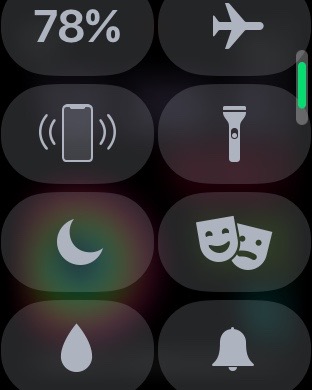

Is that wOS 3.x you are still running or is it an older pic? here is wOS 4.
