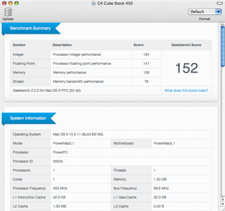

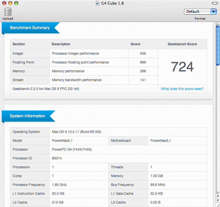

Before:
After:
This should extend its usability quite a bit over the original processor. Next step is to get and flash a GeForce 6200 (I wanted ADC support, but a good ADC card won't fit without a VRM move, and a GeForce 4Ti is pretty much out of the question due to its size).

Edit: Retested with the new CPU installed and got 811, closer to the OP's score. I think Spotlight was indexing during the tests, probably because I hadn't yet bothered to set the correct date...
