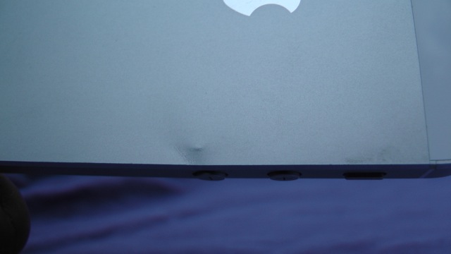

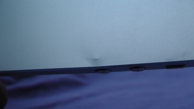

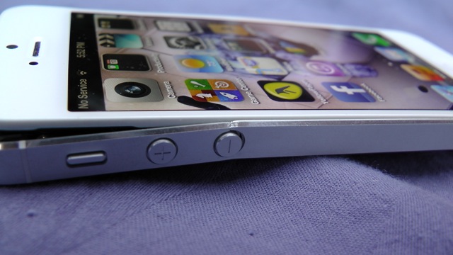

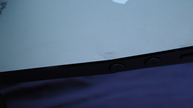

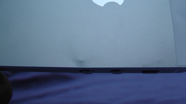

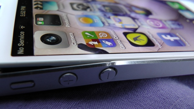

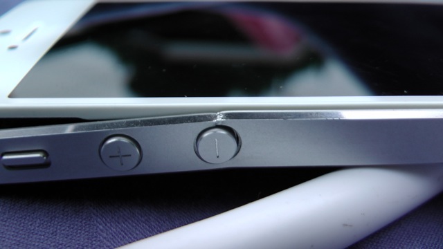

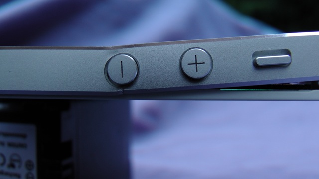

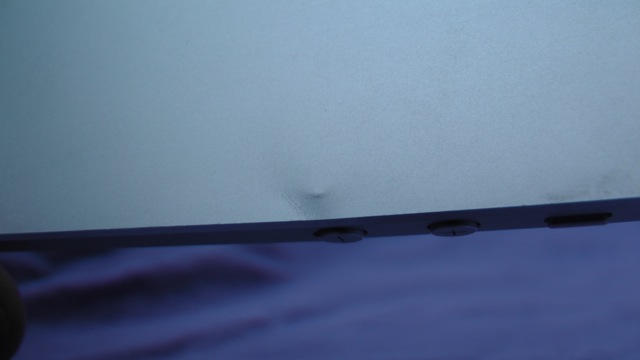

Yes this is my first thread/post but long time reader of macrumors. Never had burning issue that prompted me to post - but when this happened I knew I had to post. Happened last nite around 11 30 pm - I'm in Vancouver BC hence the time stamp. My ace in the hole is that I bought apple care at time of purchase - I planned not to use a case. My prev phone was a 4. I'm at work and will post better macro shots after I get home and before I take it in. The other pics that Novemberwhisky pointed to show remarkablly similar marks at - button. There is no damage to screen edge (which I will show better later) which would make a hit unlikely - note the marks are on either side of button and do not include button. ttyl
Please also provide pics of the back of the casing, including close ups of the bend point. Looks like this would appear to be just at the bottom of the Apple logo.

My guess is it was in front pants pocket and the OP works in IT or something and leaned over someones desk at work, and the phone came in contact with the edge of the desk and bent with the pressure from his body.

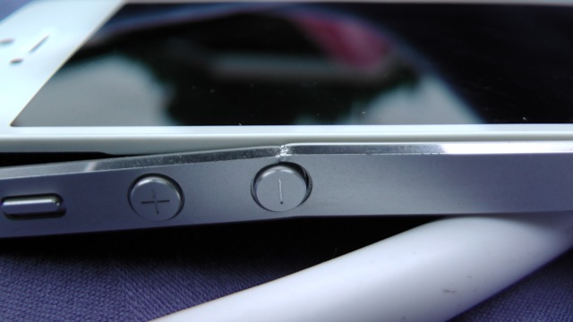

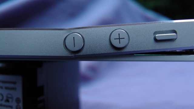

i frankly wondered if the iPh 5 would be prone to structural failure of the perimeter frame adjacent to the volume buttons due to being sat on. Bending stiffness of the iPh 5 has to be way down due to changing the perimeter and inner chassis from steel to alu and also substituting alu for glass in the rear panel.
For these reasons, as well as sensitivity to scratching, I decided not to buy an iPhone 5 despite the fact it's beautiful and fast (I've been a first day purchaser of my last 2 iOS products.)
I don't buy into the theory that residual or thermal stresses are causing the chassis to spontaneously distort; if this is the case, Or if Apple didn't or mis specified, or their sub suppliers have omitted or botched, an annealing operation, Apple better find the incompetent materials, process, and mechanical engineers on this project and fire the lot of them.

More photos 1
Here are 4 more photos, 4 more to come

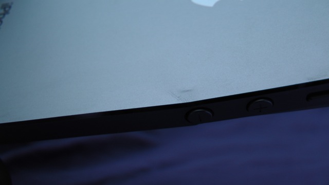

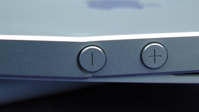

more photos 2
the last 4 photos
note the protrusion on the back as if something pushed it outward from inside.

Apple store and whoever your cell provider is, is gonna call BS on you bud. Sorry. You might as well destroy the phone and claim it on insurance as lost or stolen.
