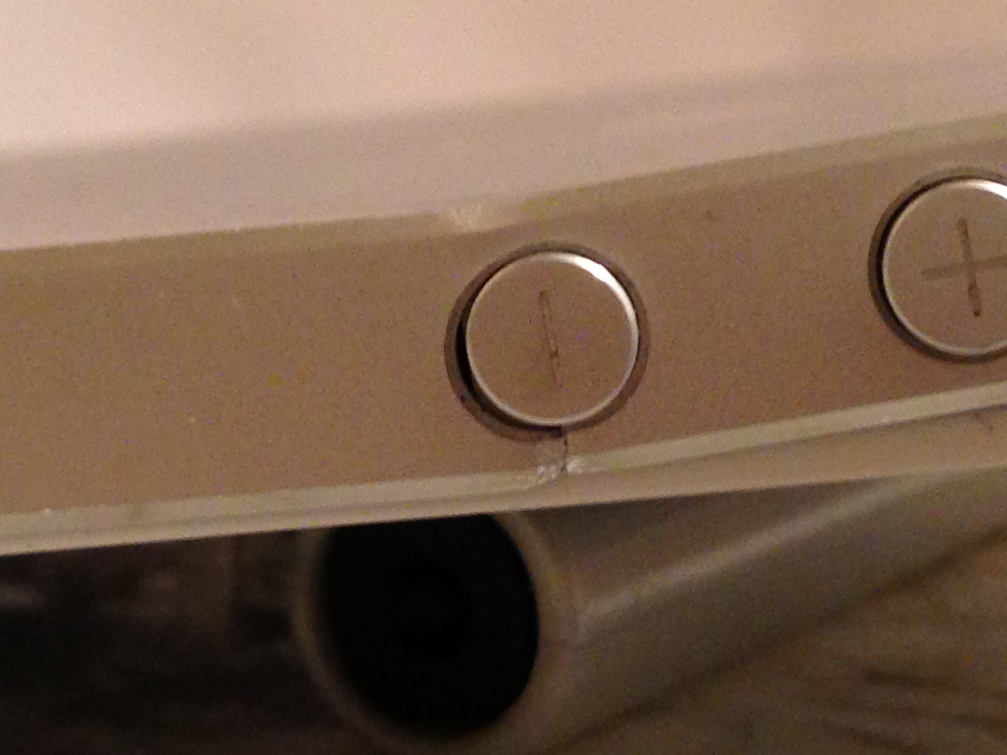

What interests me more is this tear point at the volume button. Say what you want about aluminum, but it would take a lot of force exerted on both sides of the bend to tear metal like that... kinda like putting the back against the edge of a hard surface and bending from both ends of the phone.
For a "spontaneous separation" to do that, there'd have to be an amazingly strong fastener holding the phone together at that point, and that point only.

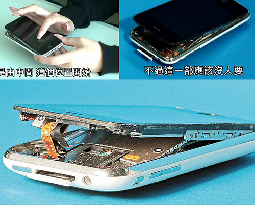

The same way you explain why the glass didn't break from something pushing from INSIDE. If an internal part sponateously bent this phone, it had to exert equal force on both the glass and casing. So why didn't the glass break, from either scenario?
One possible explanation...
http://www.youtube.com/watch?v=r4vvQq7BpiE
The effects of these stresses are not always immediate, in other words the metal can essentially store the energy of the stress, only to release it at a latter time. To deal with this we may need to quarantine certain components for a period of time, usually 6 months or more. We then compare the pre quarantine visual, dimensional and NDT findings to the post quarantine findings and look for variance. Typically we do not find a variance, but occasionally a component that was within tolerance pre quarantine will be out of tolerance post quarantine
So it is conceivable that the bending is related due to stresses imposed in the body, but not the face plate, during manufacture. I'm not saying this is what happened, only that its a possibility.
So it's taken up to 6 months in some cases. Did the metal just bend itself six months later at a very rapid clip? The OP mentions literally feeling the metal bend itself in his hand, which I would assume occurred very suddenly and somewhat rapidly. Have you ever seen anything like that?

I believe you, and I guess about the possible cause of this damage - THE MICROCRACKS.
The microcracks are invisible without a microscope, so you couldn't see them earlier -
when buying or using for the first few days.
The item with microcracks could came apart (fully or partially) AT EVERY MOMENT.

And in the last photo I posted you can see the irregular striations that suggest stretching (or buckling) not cracking and certainly not impact.
Yeah, about that photo... I'd like to see whole back plate. Including the other edge of the phone. Clearly the whole end of the phone bent backwards, so why can't we see the crease at the other edge?

You're right that it'll assert its force on the weakest point, but that's neither the aluminum nor the glass. It's the seam BETWEEN the two that's the weakest, and should be the first to give, resulting in a clean separation of the two pieces.
