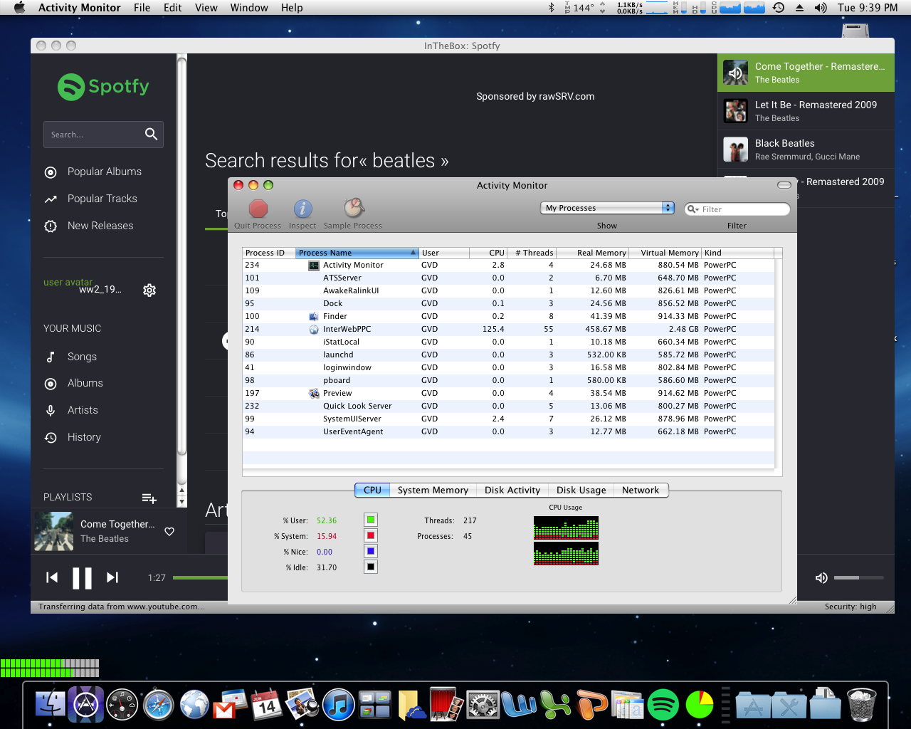

WOW what a find! It works even too good to be amatorialI use this site as a Spotify replacement on my beloved 12" PowerBook: https://spotfy.one
Found it recommended on ytprivate (an Invidious instance) as a privacy oriented Spotify alternative. The site retrieves the tracks from youtube and works great, the interface is very well done. You can even create an account (which i did) and create playlists, mark favourites, etc.

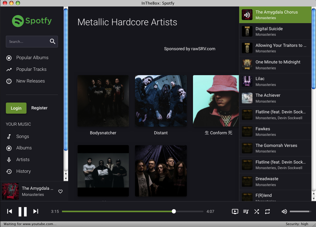

It works well on InterwebPPC, but if you want better speed and recreate a Spotify client app in your dock, you can use a tenfourfoxbox like myself:

I tried that last year and it wouldn't load then forgot about it- "oh ye of little faith" 😀I use this site as a Spotify replacement on my beloved 12" PowerBook: https://spotfy.one
Whoa! You've done a TFFB for InterWebPPC!!!? Is this available for general use or does it require compiling per site?I've attached an "InTheBox" spotfy.app for those of you who use InterWebPPC. It's based off of a modified tenfourfoxbox.app specifically for InterWebPPC.
Yeah. Not fully done with it yet, but if you'd like to give it a try before it goes "public" it's attached below.You've done a TFFB for InterWebPPC!!!?
Great stuff! Works 100%Yeah. Not fully done with it yet, but if you'd like to give it a try before it goes "public" it's attached below.
PowerPC miracles are in abundance. So cool & thank you 😀I've attached an "InTheBox" spotfy.app for those of you who use InterWebPPC. It's based off of a modified tenfourfoxbox.app specifically for InterWebPPC.
