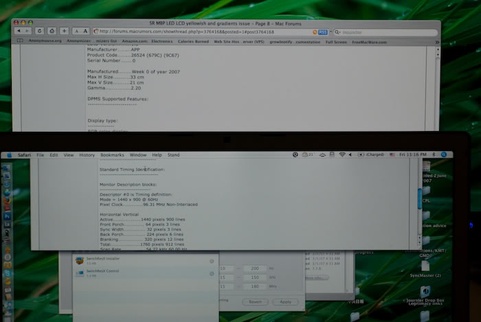

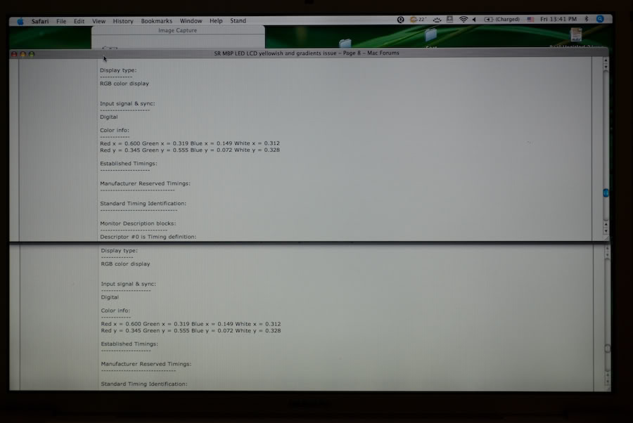

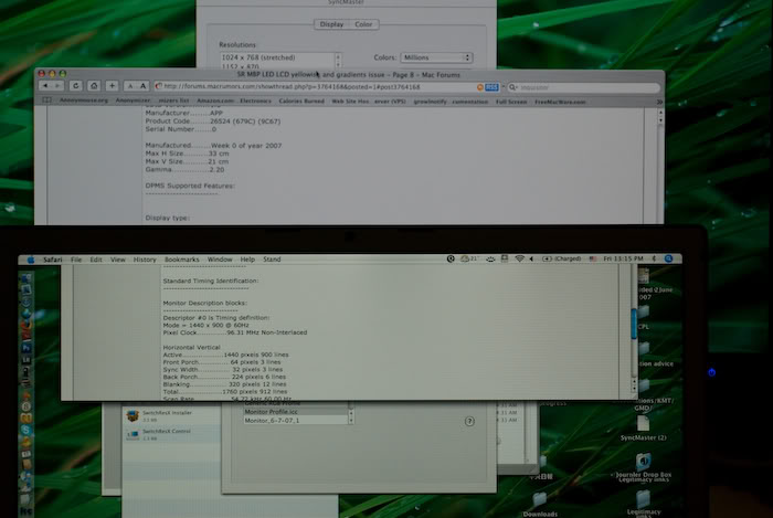

I don't think matte vs glossy had anything to do with it, althought I don't know.
Here's mine. Bought first day in store. Glossy, with the yellow tint on lower 3rd of screen.

Ok, I've tried to take some pictures here.
The first one is the default ColorLCD profile underneath my desktop Samsung 215Tw :
The second one is using the colorsync profile posted on macrumors underneath the samsung display:
The third picture uses the calibrated profile and try to show the difference between whites at the top and the yellowish whites at the bottom, especially left half. It's VERY hard to captures this and what I did capture does not quite show what it looks like. In real life, there's more of a very translucent yellowishness' to that area. Now when I look at the photo it's really difficult to see - damn. it's easily visible in reality.
http://i189.photobucket.com/albums/z111/nycpde/colorLCDprofile.jpg
http://i189.photobucket.com/albums/z111/nycpde/6-7-07_profile.jpg
The third and fourth pictures use the calibrated profile and try to show the difference between whites at the top and the yellowish whites at the bottom. It's VERY hard to captures this and what I did capture does not quite show what it looks like. In real life, there's more of a yellow 'glow' to that area.
I see the yellow tint from your picture. It also seemed there is a slight uneven lit bleed from the bottom edge of the screen? Or was it camera angle?
I tried to keep a straight angle in order not to get into the problem of viewing angles and the yellow tint caused by that. It's possible that I may have been slightly off, but not enough to be in a bad viewing angle. There's actually not much bleed at the bottom, more from the top.
