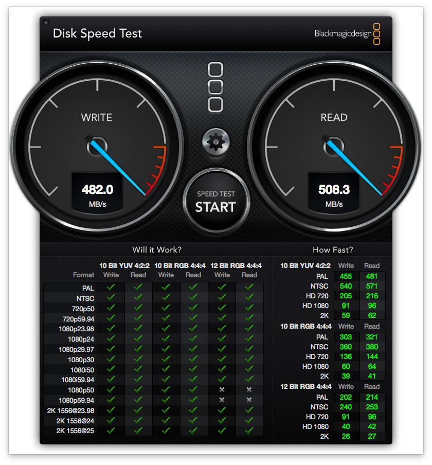

I chose the Samsung 850 EVO for my MacBook Pro mid 2009 (with the NVidia MCP79 chipset). It was a close call vs. the Crucial MX200. But the Samsung 850 EVO is supposedly faster and more energy efficient according to reviews.
I can also confirm that I am getting a "negotiated link speed" of 3Gbps (SATA II).
Blackmagic speed test:
210MB/s - write
267MB/s - read
The machine is performing much better. Faster boot-up and apps launch. Lower CPU usage. Happy with it so far.
