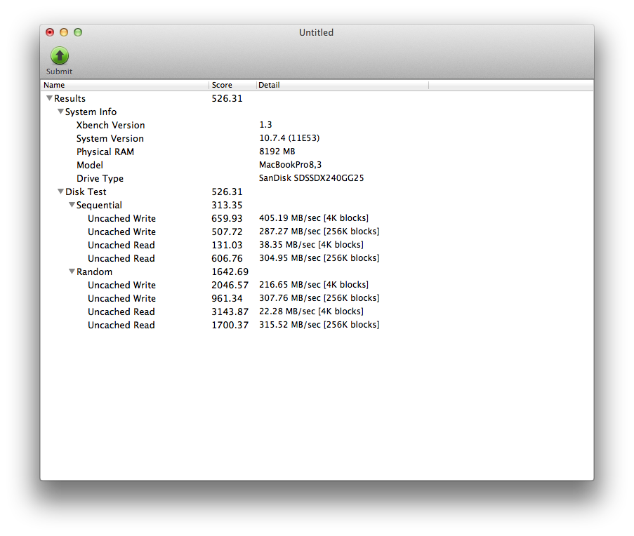

I've installed the Sandisk 240 Gb extreme with no issues.
However, performance is far from expected - on par with my previous m4 128 Gb
Certainly nowhere near this mactrast review http://www.mactrast.com/2012/03/review-sandisk-extreme-ssd/
Any ideas why? Link speed is 6 Gbit, I reseted PRAM and SMC, speed is the same with or without TRIM activated.

The new BlackMagic uses incompressible data whereas previously it used compressible from what I have read. That would explain the discrepancy between your test and that of Mactrast. I'm not convinced of the BlackMagic test to be honest. There are plenty of reviews showing the Sandisk performing very well, many even higher than that review you have linked to. I would try some different benchmarks or even make some up yourself to satisfy. Also, what settings did you use for your Blackmagic test?

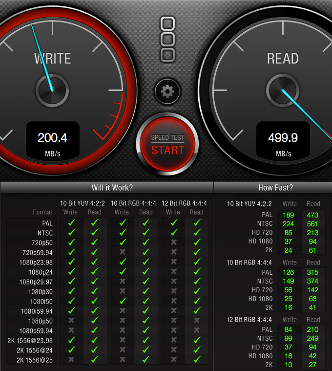

I used v.2.1., default settings, 1Gb file.
Here are some Xbench results:
As I figured. Two different benchmarks and two entirely different sets of results. I'll test mine again in a bit and feed back.

I would say your getting the advertised speeds. Below is my 256GB M4 in which I get 250write and 490read on the BlackMagic test.
