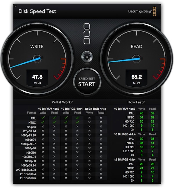

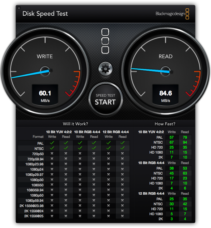

Here's what I'm working with at present, so even if I can only bump that up to the lowly limits of my SATA II MBP, it should prove to be a huge seat of the pants improvement. 🙂

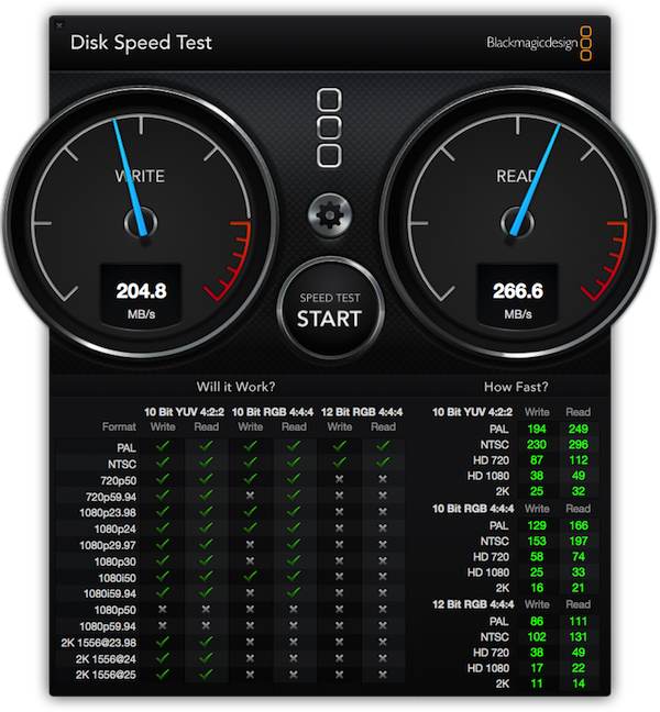

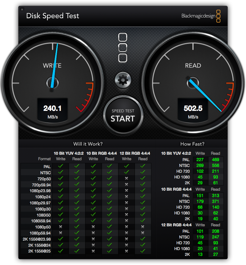

And here's the first test of my refreshed old MBP's speed...

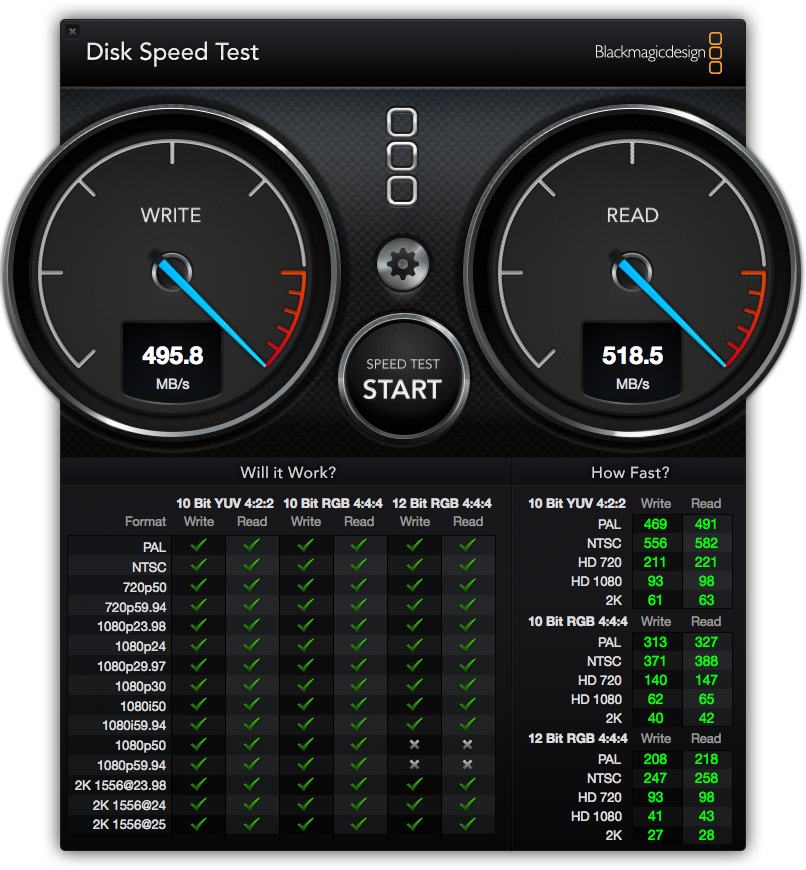

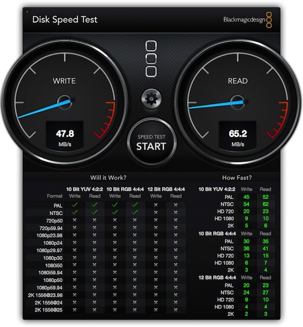

Here are the numbers I got on Black Magic with the new SSD

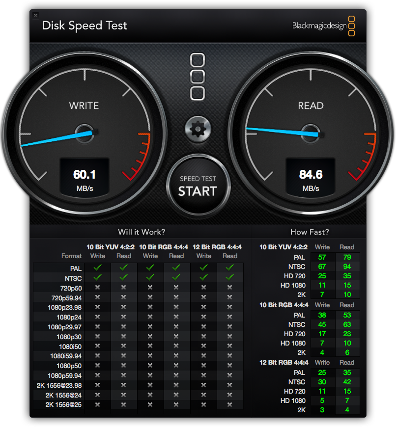

and My old Baseline from the original HDD

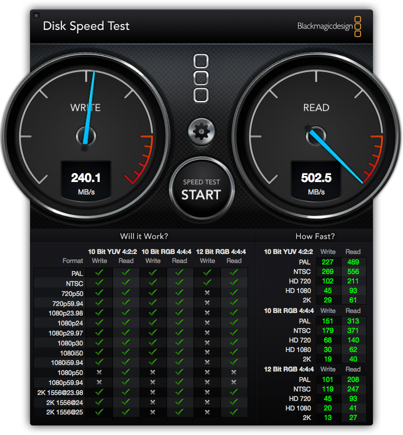

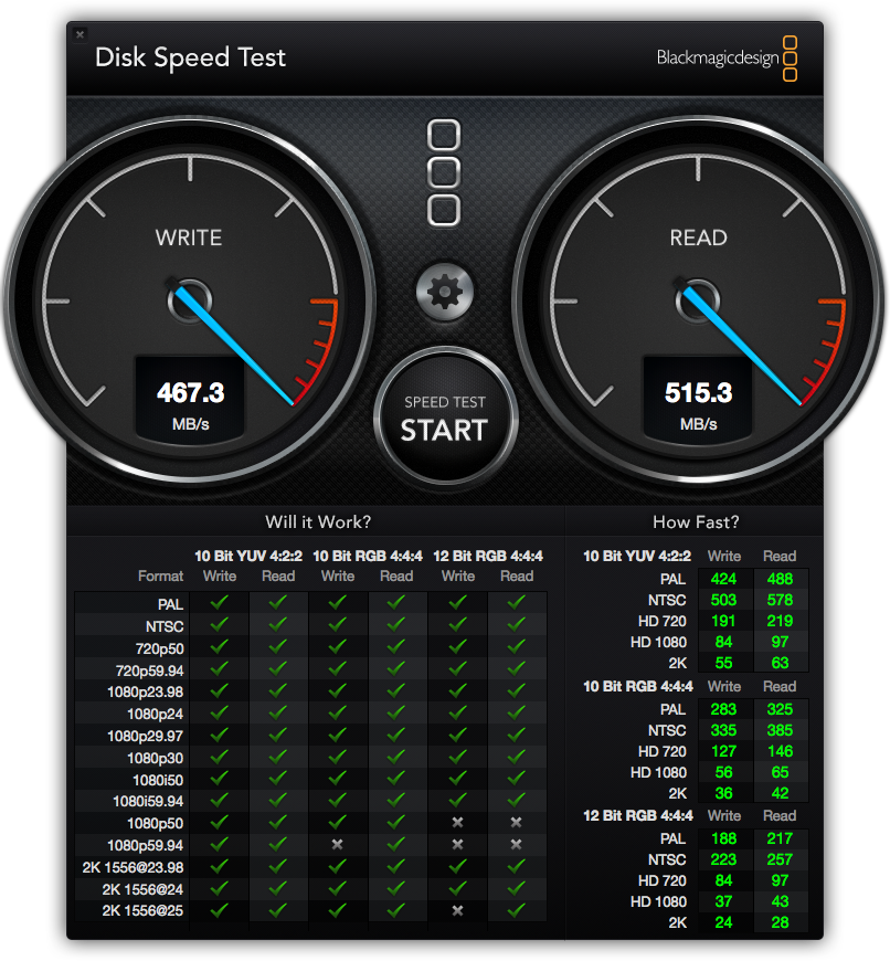

the 840 Pro (256) is a fast drive
Mine is an early 2011 MBP 15", 16GB RAM, 2.2GHz.
The speed test results are very satisfying.
