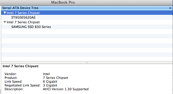

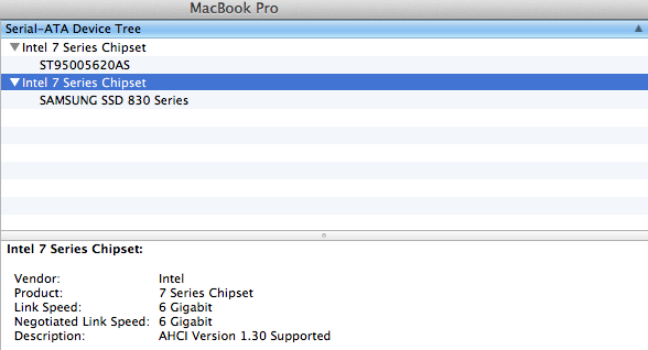

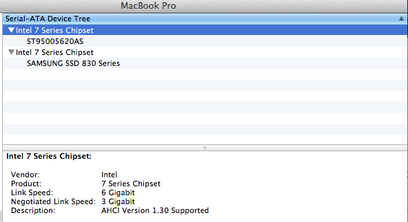

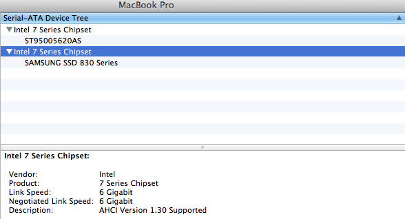

Ok, not too sure if i have set up my ssd/hd in my 2012 mbp right.
I have put the ssd where the superdrive was and hd left where it is for the sms sensor.
The ssd has the following...
Link speed - 6 gigabit
Negotiated link speed - 6 gigabit
The hd has this -
Link speed 6 gigabit
Negotiated link speed - 3 gigabit
Is that because the hd is a slow drive? It is a momentus xt 500gb 7200rpm

Yeap, a 7200rpm HDD wot even e able to my out a 3gb connection.

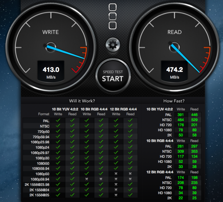

I also enabled trim as well with trim enabler and that is showing in system profiler as Trim enabled.
Here are the numbers I got on Black Magic with the new SSD
and My old Baseline from the original HDD

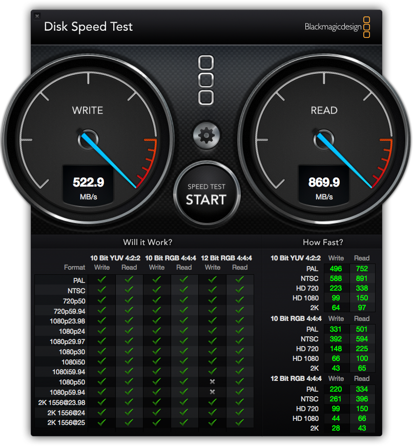

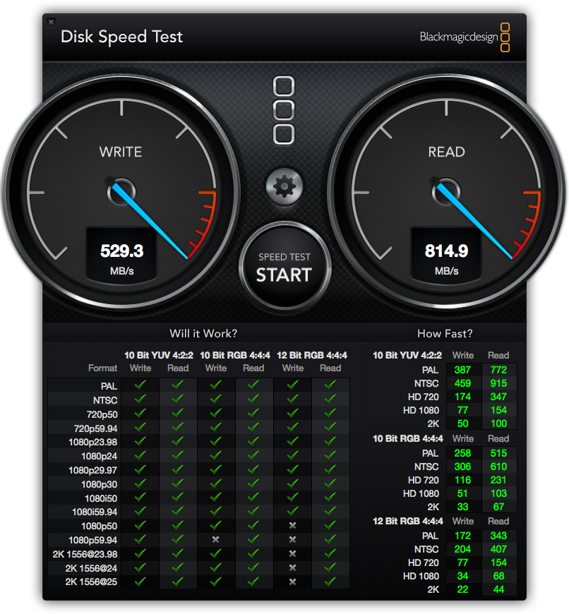

RAID two SSD's (raid 0 striped) with working bootcamp
I just wanted people to know that it is possible to raid two SSD's from different manufactures (same GB storage) and have Bootcamp working with Windows 7.
First I backed up my software on external drives (carbon copy cloner for Mac).
Then I installed the second SSD using the "data doubler".
I booted into the Mac OS and performed a bootcamp install.
Then I used the mac utility (before booting into OS X) to RAID (0 striped) the two SSD's together.
This wiped out everything except the "windows (bootcamp) drive". I then took out the SSD and reinstalled the optical drive to utilize the Windows 7 CD to restore a prior backup after re-formatting to NTFS. Once I verified that Windows 7 was working, I reinstalled the Second SSD, and connected my Carbon Copy cloner drive (external bootable backup of OS X.)
After booting up from the backup (external drive) I used the carbon copy cloner to install to the pair of SSD's I configured to RAID.
All I can say is... every bulletin board I read stated that this wasn't possible. I haven't noticed any obvious improvement from day to day performance, but the read and write speeds have doubled: Write in the lower 530's, and Read in the 830's. The volume for both drives on RAID 0 (less the amount I have partitioned for windows around 272GB) is 722 GB.
The two SSD's I utilized are the Crucial M4 (firmware 010G) and Vertex 4 (firmware 1.50). Both have TRIM enabled. I have a late 2011 macbook pro with 16GB of corsair ram.
Just wanted to let people know about this.
