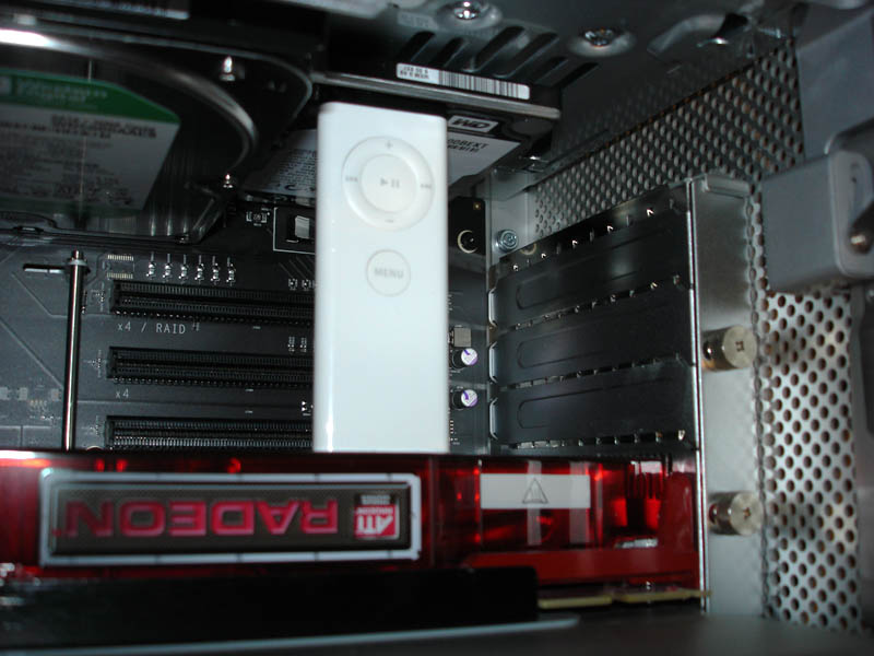

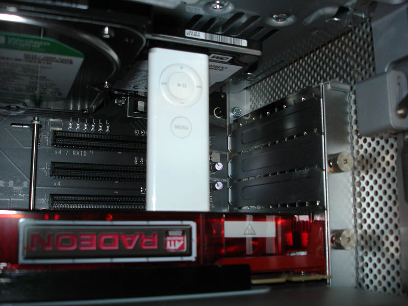

Actually I have no idea what might cause that issue. All six SATA ports are completely equal (besides the fact that the lower 4 can be used for SAS drives with the Apple RAID card as well, but that doesn't matter here), hence you should be able to swap the drives between the ports.
I can do that with whatever drive connected to my Pro and I never had any issues.
But as you said, maybe the drives does not fully connect to the port (unfitting mounting holes for example). I always use 2.5" SSDs so I can't say that for sure. You might wanna compare the alignment of the holes with a mechanical 3.5" drive.
However, just to test it, try to connect the drive without the sled and see if the Pro boots from it.
Just make sure to support the drive so that it doesn't bend the port.
This works very good 😉;
