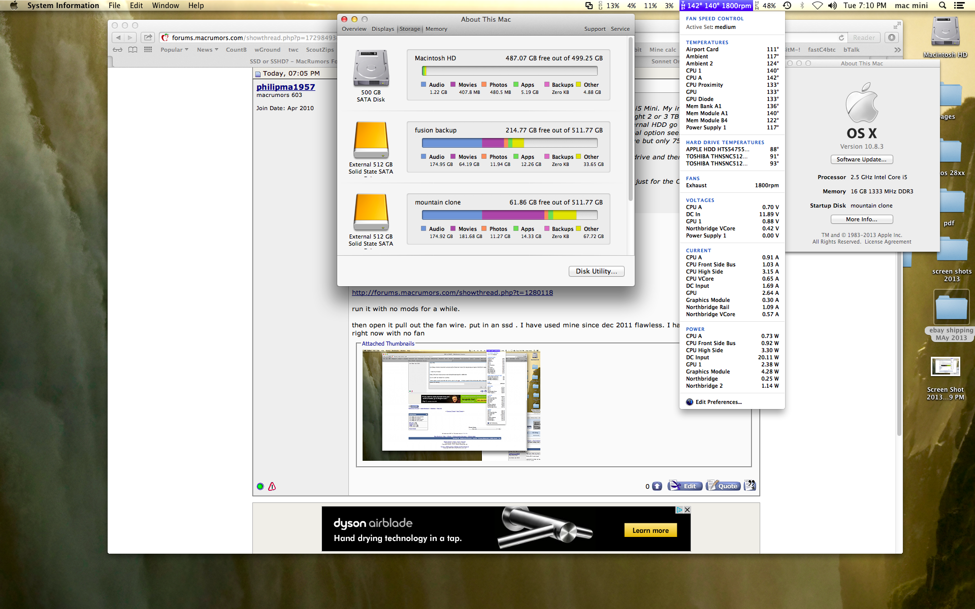

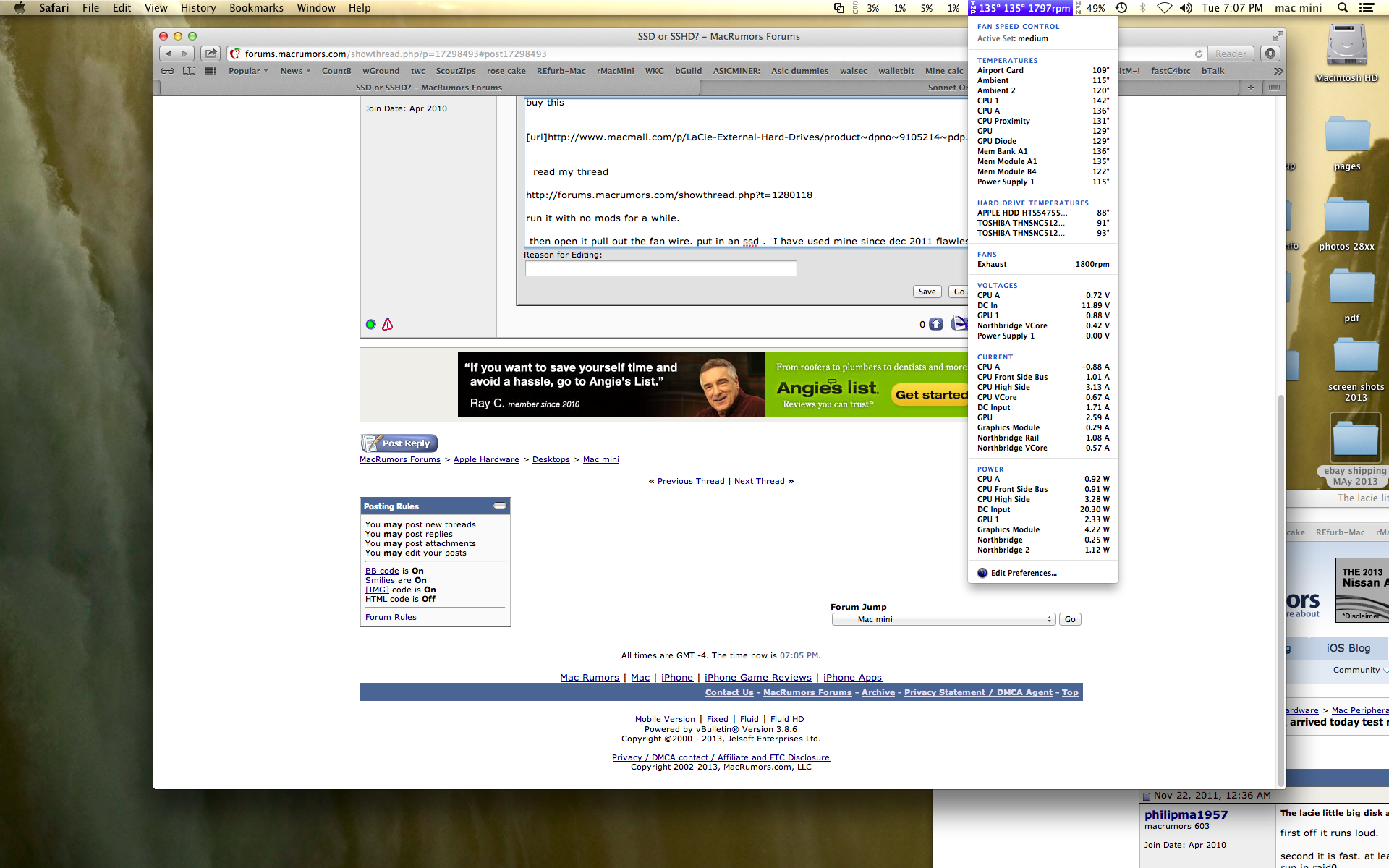

run it with no mods for a while.
then open it pull out the fan wire. put in an ssd . I have used mine since dec 2011 flawless.
I have 2 tosh ssds in it right now with no fan. one boots one is a backup.
the temps are low under 100f see the tosh temps in the screen shots.
