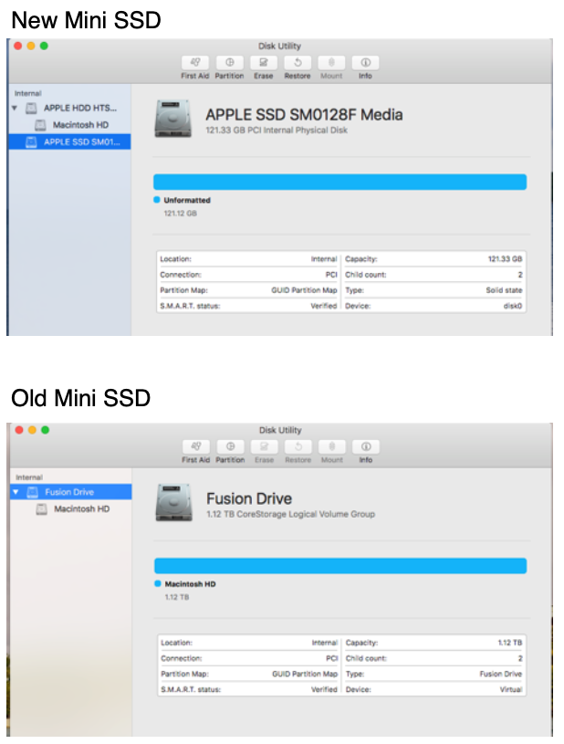

I have 2 minis 2014. Both have 1tb SSD drives. The newest one boots much slower than the older one. The Disk utility says the newer one is unformatted. Is that why it's booting so slow? How can it safely format it?

Isn't the Mini 2014 equipped with a Fusion disk, usually a bit larger than 1TB? Such disks are only roughly 10% SSD, where the system installs the OS and the user cannot control that action. Please, correct me if I'm wrong.

This is just one of our less tech-savvy members, nothing malicious. Here's the image he tried to post.
Looking at that quickly, it appears the New Mini has a fusion drive and you are showing only the 128gb SSD portion of it, which is unformatted. The old Mini also has a fusion drive. So, my guess is that you are actually booting the new Mini from the 1tb hard disk and not an SSD or fusion drive.
As far as I can tell, neither Mac has a 1tb SSD.

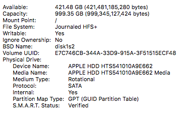

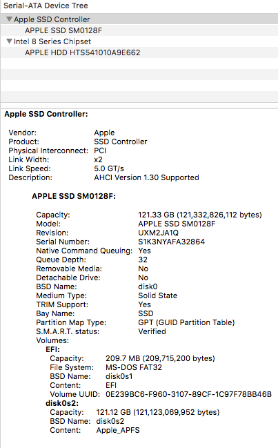

Hello Boyd,
Don't know if this helps. From the system info.

I think both of your Mini's have 1tb fusion drives, I have a 2014 Mini like this myself. The fusion drive consists of two separate physical devices: a large, slow 1tb hard disk and a fast, small 128gb SSD. Using software, these two drives are "fused" together such that they appear to be a single disk to the user. To improve performance, frequently used data is accessed from the SSD while the bulk of your files are on the slow hard disk. MacOS handles all of this automatically.
Since the fusion disk is created with software, it can be split apart into two completely separate devices such that the hard disk and SSD are accessed separately. My *guess* is that, somehow, they were split apart when you re-installed the operating system. This resulted in everything going onto the slow hard drive and nothing on the SSD, and that is why it is so much slower than the "old" Mini. But I could be wrong here, and I'm sure somebody will correct me if that's the case.

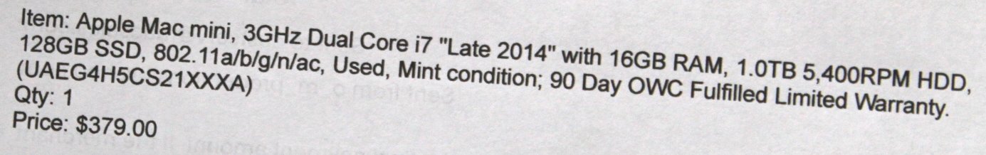

Sorry for all the confusion Boyd. Can't remember what OWC promised but I did ask them if they could install Sierra before shipping and they said "Sure, for another $$$". I'll check my paperwork to see and get back to you. As far as the drive (con)fusion status I haven't a clue. I just thought it would boot up like the old mini.

Found the invoice:
That shows the devices that belong to a fusion drive, which is 2 devices. One 1TB HDD (spinning hard drive), and one 128GB SSD. Those 2 devices are combined with software to form the fusion drive. Your Mac will see those 2 devices as a single drive (assuming everything is set up properly)

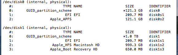

There's a quick way to find out what is really happening:
Open your Terminal.
Run the command "diskutil list" (without the quotes.)
Post the results here...
Found the invoice:
Interesting that the invoice says that it has a 1tb and a 128gb SSD instead of a fusion drive. DeltaMac knows more about this than me, but that invoice suggests that OWC split the SSD from the hard disk before they sold it to you and installed the operating system on the hard disk... which is weird!

OP:
The Mini that has the 1tb HDD and the 128gb SSD was probably originally sold as a "fusion drive", but at some point the two drives have become "un-fused" and now they are just two "stand-alone" drives inside the Mini.
The OTHER Mini shows a "fusion drive" together and working as such.
If it was me, I'd just leave the two drives UN-fused.
I'd set up the SSD to be the boot drive, with OS, apps, accounts (basic).
