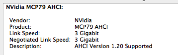

Well is looks like you are partially correct. According to the System Profiler on my machine, the 2009 Mini uses the Nvidia MCP79 ACHI which supports link speeds of 3 GBps but my Negotiated Link Speed is only 1.5 GBps and thus, the reduced speed.
Any idea what may be causing the lower Negotiated Link Speed and can it be changed?

Reinstalled the old 7200 rpm Seagate HDD and it achieves full 3 GBps link speeds so placed a call to OWC.
Per the rep I spoke with, it turns out that they are just encountering this problem with this specific model of Mini as well--problem is same as encountered with 2008 MacBook Pro 15" and 13" Macbook (all use same NVidia MCP79 AHCI for SATA) noted at the bottom of their product page.
They did advise me though that the Mercury Extreme Pro 3G will function at full SATA II speeds so the Electra is going back and I'll be trying the Extreme Pro 3G.

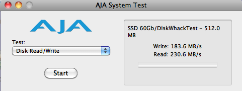

I am getting 100Mb/s write and 265Mb/s read through AJA System Test on my MM 2009 2.66GHz with Intel SSDG2.
I see 3GBps under Negotiated Link Speed so is this Intel G2 such a slow poke versus Mercury Ext. Pro 3G in writing speed?
