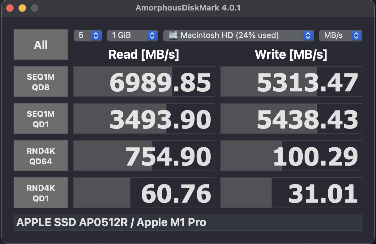

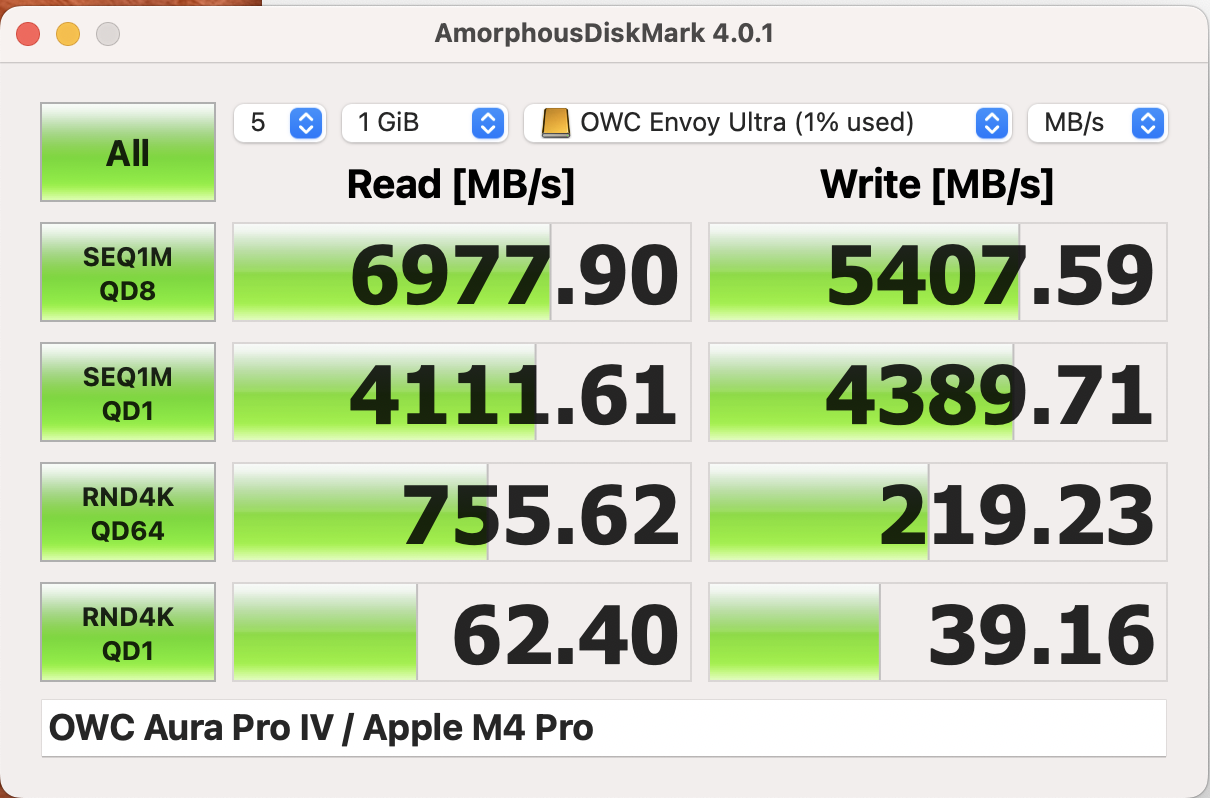

For reference, this is on my M1 Pro MacBook Pro with 512GB:

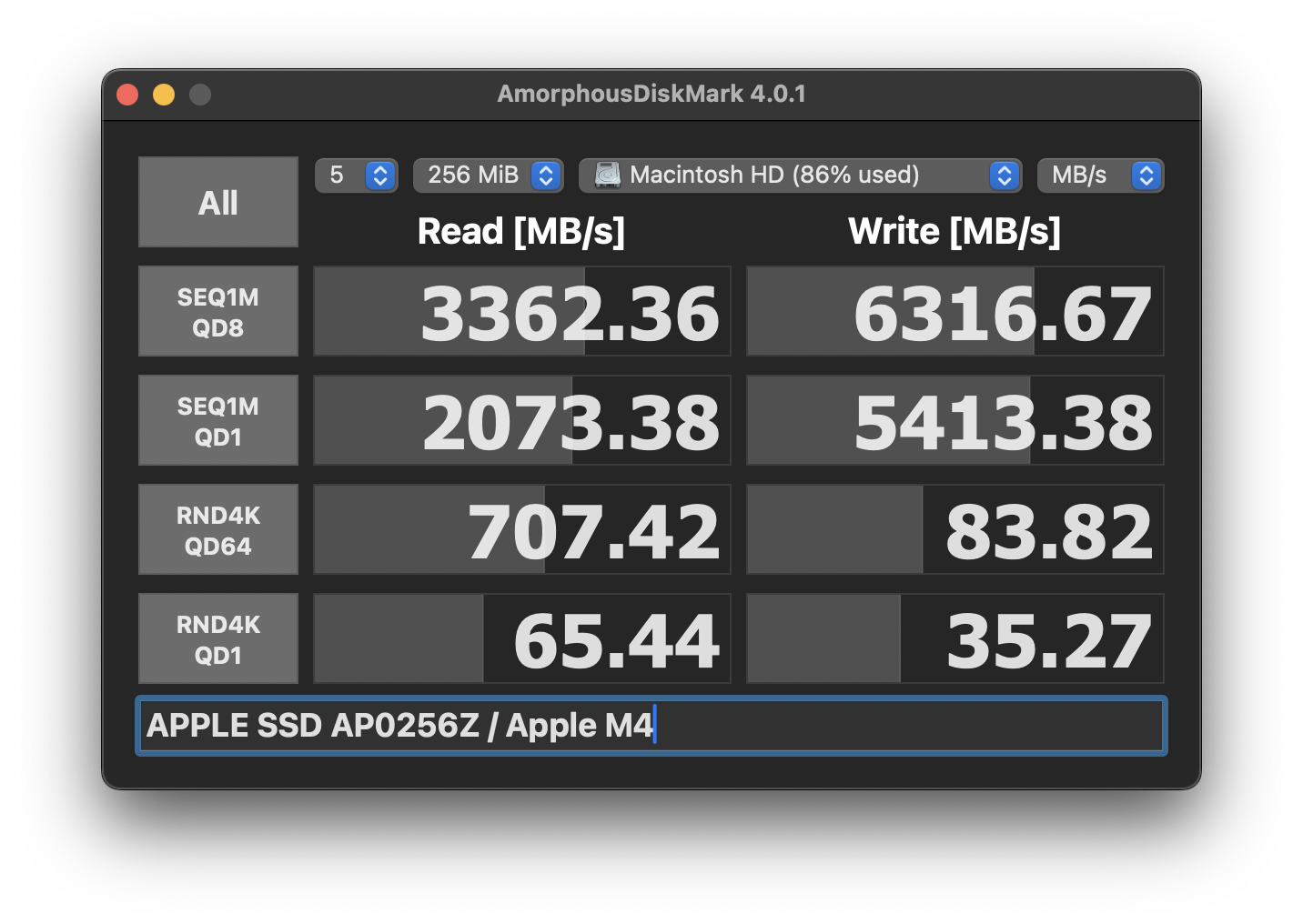

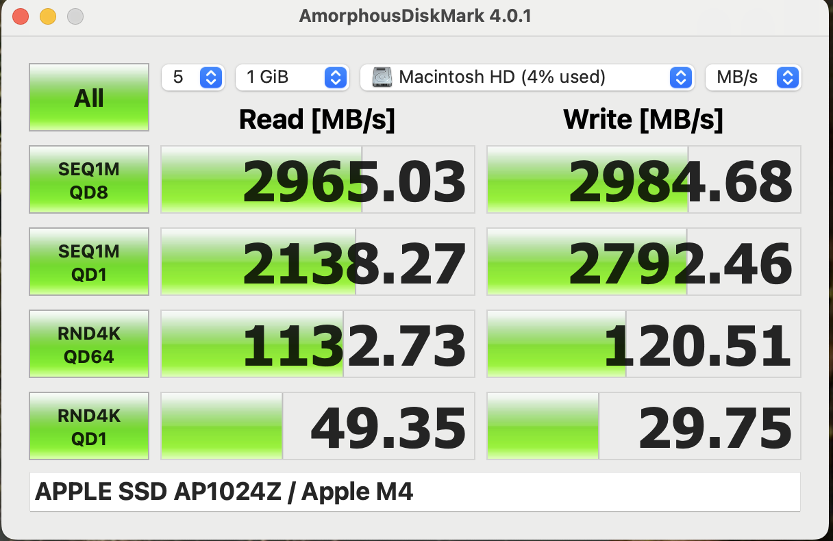

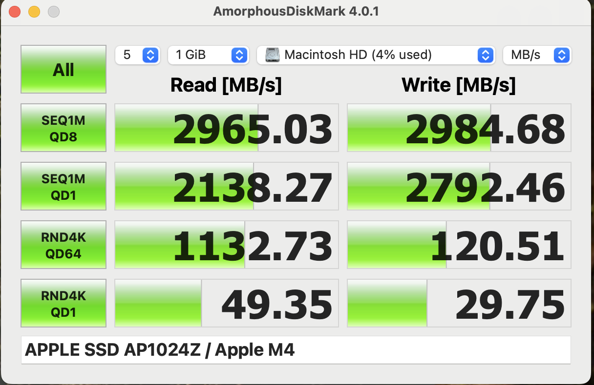

Somewhat underwhelmed TBH. M4 with 32GB and 1TB
ATTO
Having used the machine for it's intended purpose, which isn't anything strenuous (I have an MBP 16" M3 Max for that), I've decided to stop crying about SSD speed. This little box had dealt with everything I've thrown at it and the disk feels plenty fast, especially as it's the same speed as my MBP 16" i9 MBP (now retired) and much faster than the 500mb/s of the 2014 iMac it's replaced. I'd rather have the 1TB and 32GB RAM than be forced to M4 Pro which I don't need.
In the M4, if there's no speed advantage to upgrading the drive there's even less point - just stick to a TB4 external drive.

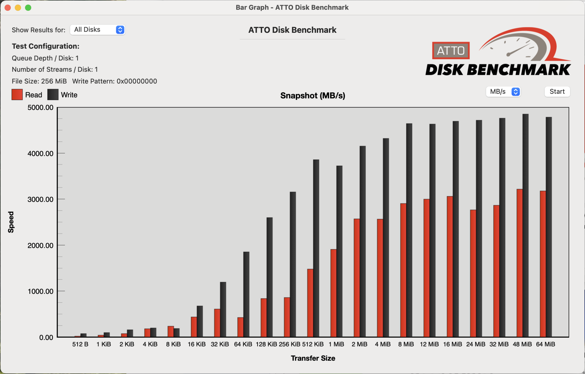

If picky, AmorphousDiskMark is considered just middle of the park but for the purpose of general sharing and comparison it is more than adequate. The added bonus is how it is virtually the same as CrystalDiskMark, so that you have a sea of data from the PC side to add against what's only on the Mac platform.
If you are inclined, use ATTO Disk Benchmark which gives even more control for your tests, shows you graphs, can export logs, and more.

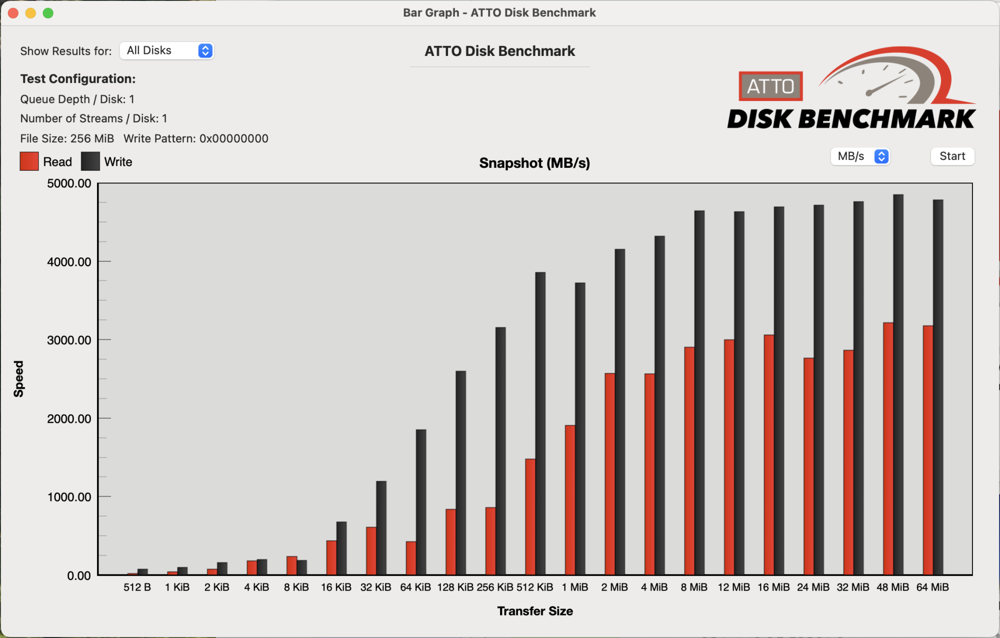

ATTO has give me strange results on all my tested apple silicon Macs (m1, m2) and seemingly unmatched result for M4 as well:
ATTO
Those two screen shots don't match because the Amorphous uses 1GB, while the ATTO uses 256MB test file size. Not saying ATTO doesn't behave abnormally sometimes, but the way it logs and present data is more detailed.

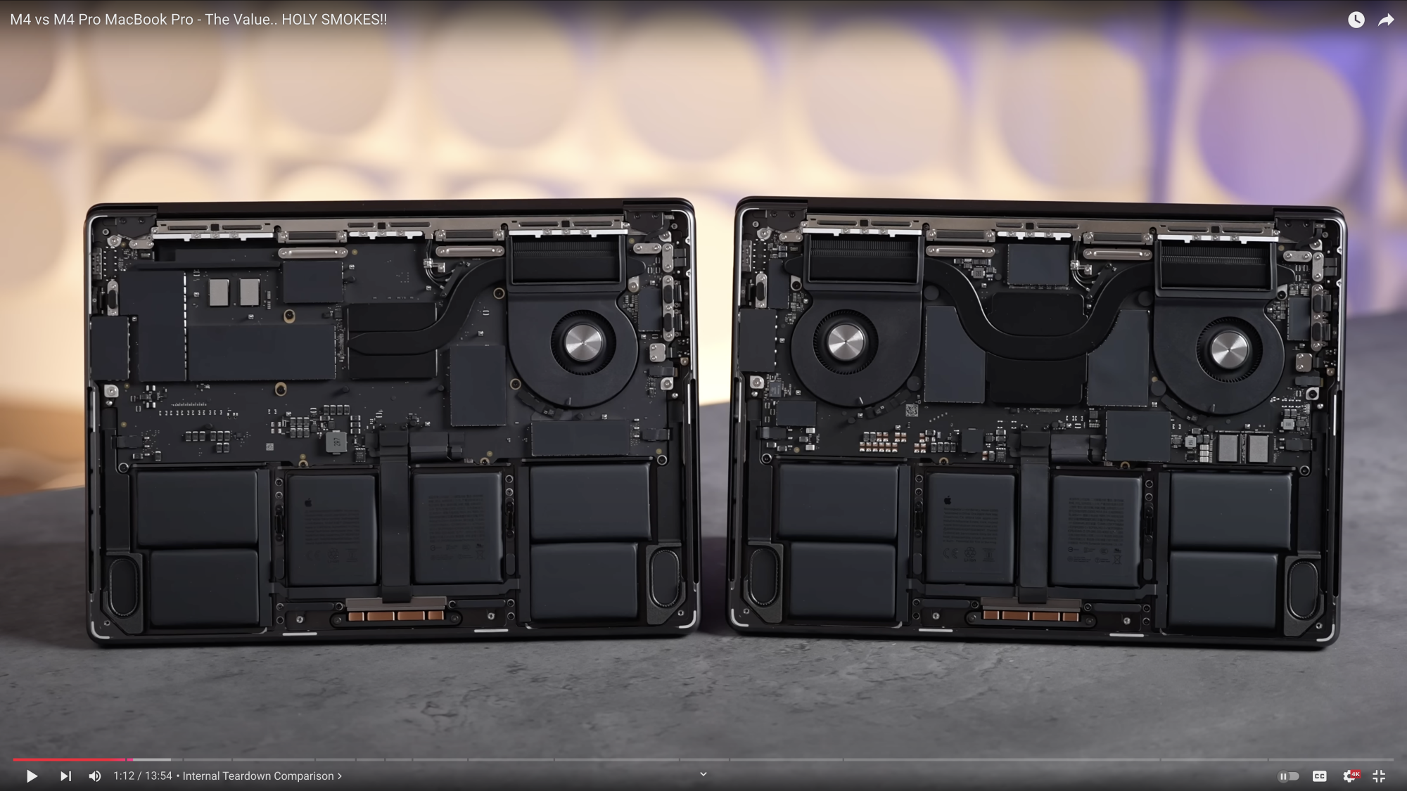

I did further digging; the following photos and screen shots are from:
Max Tech M4 MBP 512GB vs M4 Pro MBP 14" 512GB
The M4 Pro is using 4 x 128GB to achieve the speed, the visible side only shows 2 NANDs so the other 2 are on the other side, there are no unused soldering pads.

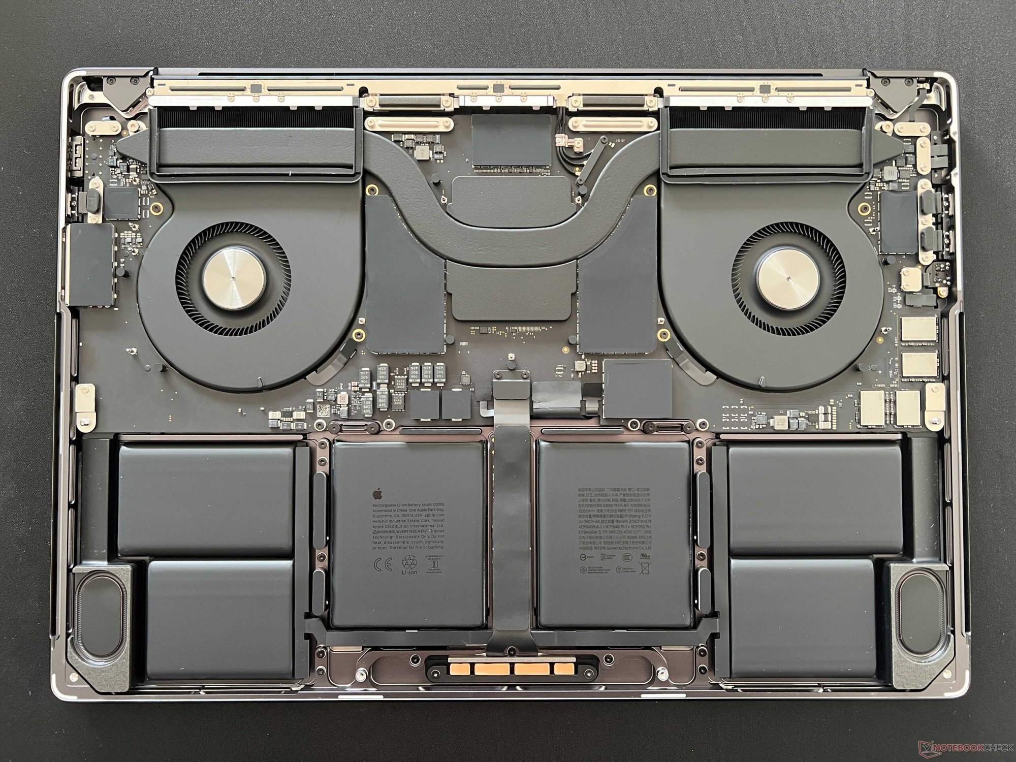

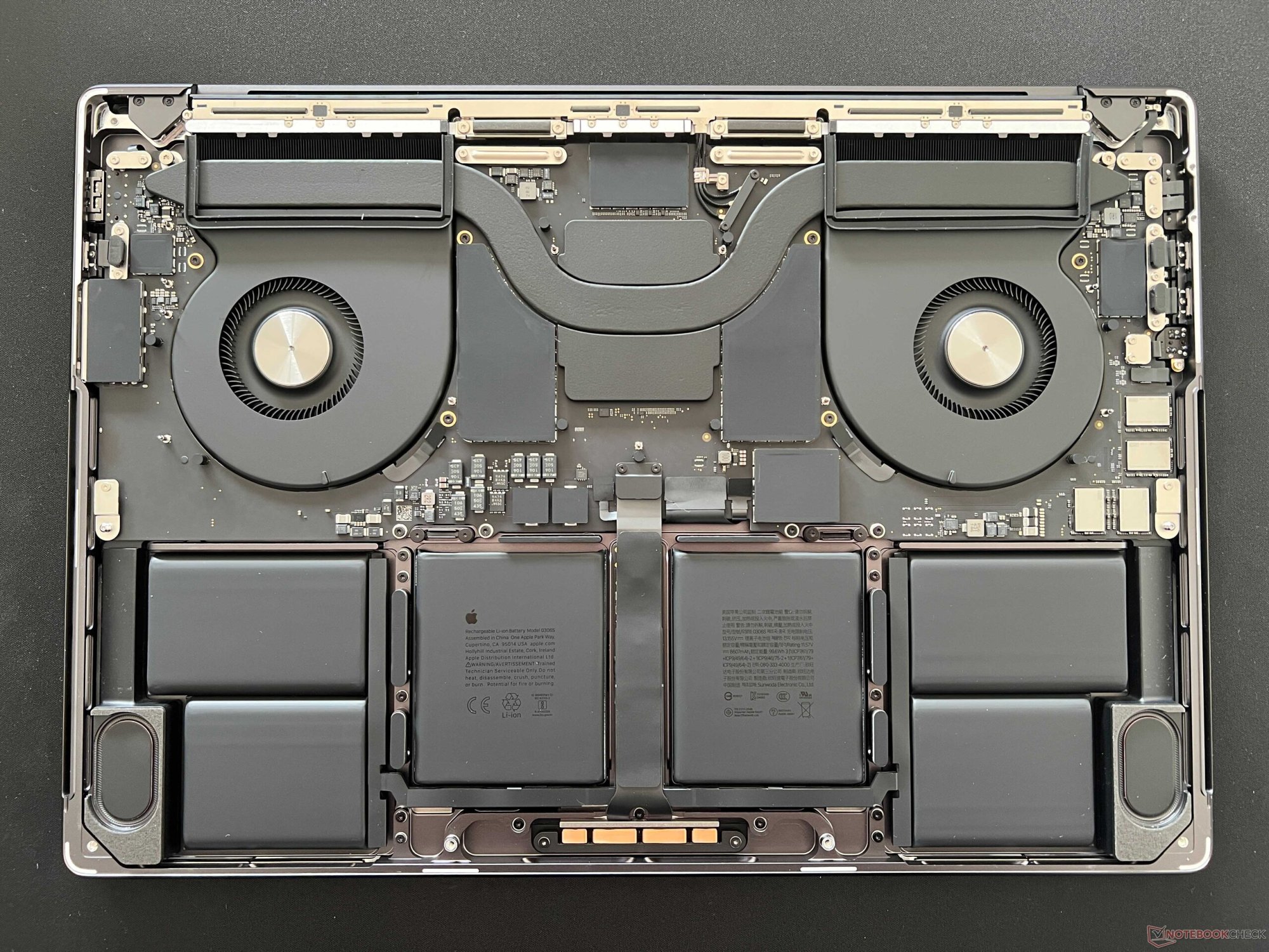

notebookcheck M4 Pro 16" 2TB
The review text noted the 4 NAND modules are 512GB each, the speed test reflects that. All 4 are visible so none are on the other side. Also no unused pads.
We already saw the same pattern in the M3 era of MacBooks, it is safe to assume the M4 Pro SoC does not have enough data lanes for 8 NAND modules. What we need is to visually confirm the 8TB variant of M4 Pro mini uses a daughter card board that looks no different than the one I posted in the other thread, it means Apple are using 4 x 2TB NAND modules, for the first time.
