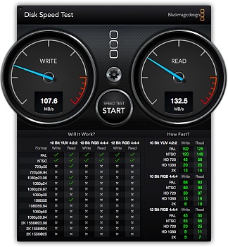

Just did the SSD upgrade on my late 09 imac. I replaced the original HDD with a Samsung 830.
Process took me about 1 hour from start to finish. It's actually not that hard at all.
My boot time went from 45 seconds down to 15 or so. Apps load up quickly and overall responsiveness is a lot better.
However, I did a read/write test with BlackMagic and the results left me pretty disappointed. I know the SSD is working and all but these results are slower than Sata I speeds!
Specs are: 21.5" iMac, 3.06 GHz, 12GB ram.

Go to Applications / Utilities / System Profiler (System Report) > Hardware > Serial ATA > your SSD > Negotiated Link Speed and tell us what it says there.

Your read/write speeds can't be correct - performance indicates that your new drive is running fine.
Are you sure you haven't accidentally tested another (slower) attached drive?
There is no other drive-intensive process/app running while you did the test?

I agree. I replaced the HDD so there is no other drive for it to test.
No applications or processes were running at the time either. Is there a way I can check to see what it is testing exactly?

What brand of SSD did you buy (whoops, I see you have a Samsung)? Different disk tests will show different results as a result of the testing methodology.
For example, SSDs with SandForce controllers such as OWC and others, compress data as written. They will appear to be slow using BlackMagicDesign "DiskSpeedTest" which uses large blocks of un-compressable data for testing. These drives will test much better with the AJA disk test program.
If it actually "feels" slow, regardless of what testing shows, then you probably do have a problem somewhere. Your disk test results do appear to be slow, however, for a Samsung 830..

I'm trying not to get too caught up in the numbers. My boot time is about 15 seconds now and apps load up almost instantaneously and everything is very responsive overall.
I'm just hoping its the testing software issue and perhaps a different program will give me the actual results.

Check the negotiated link speeds and see if its listed as 1.5, 3 or 6 (Gb/s). I don't think the 2009's were using SATAIII speeds, so you may see only 3Gbs as the max.

No, I said his test numbers seem to be a bit slower than others have seen with the Samsung 830 drive. The Samsung 830 is a great drive.

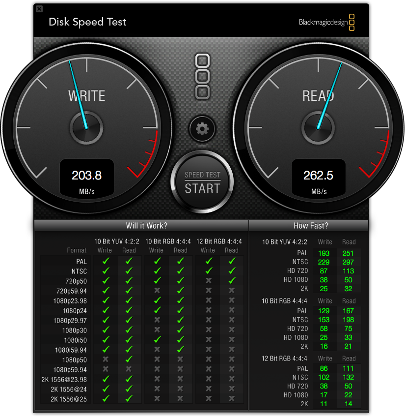

I replaced my 2010 iMac drive with a SSD (Kingston Hyper 3x) a couple days ago. Black Magic shows an increase from ~ 125 mb/s on the 1 TB platter disk to 245 mb/s which is in the ballpark for realistic channel performance for a sata II controller (probably a true max of 275 mb/s on sata II) on the iMac.

I am thinking that a 2009 probably does have SATA-II interfaces which would limit the speed. However, I found some DiskSpeedTest results from my Mac Pro (also SATA-II) which are double (204/263) what he is seeing. I think the SSD I was testing at that time was a Crucial M4 in the standard Mac Pro disk tray.

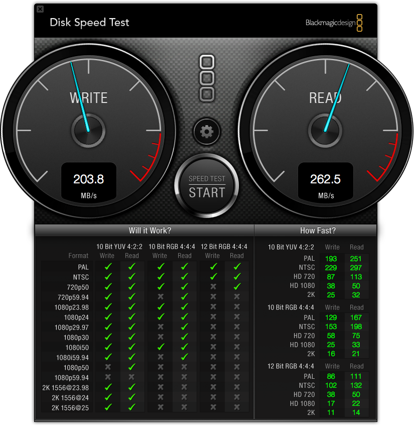

Yep, I was expecting between 200-300 mb/s. 107 mb/s seems WAY too low for Sata II speeds.
If it helps, I'm running a Crucial M4 128GB in a Seagate Thunderbolt sled (STAE121). My speeds are actually right around 300MB/s read and around 150-175MB/s read. Its connected at 6Gb/s.
I just checked: my negotiated link speed is 1.5
The link speed is 3.
I did a pram and smc reset and still the same. WTF.

I didn't change any cables. I used the original SATA cable from the HDD and plugged it into the SSD. I'm only getting 1.5 negotiated link speed.
