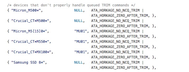

I have a late 2009 macbook with an ssd (adata, cheapy)
Trim on some samsung SSDs in mac will cause problems it is only one or two models (cant find link right now)
there are a bunch of SSDs which are trim blacklist in mac and should not have trim enabled.
Like I said it is very few.
I have trim enable personally.

found it.

https://blog.algolia.com/when-solid-state-drives-are-not-that-solid/
You are mistaken. This queued TRIM issue was a bug in the Linux kernel and never impacted OS X.

That is the same issue in the article I linked and it has nothing to do with OS X. This was a Linux kernel bug related to queued TRIM commands.
From this quote in your article, it appears the author is speculating the Linux bug (and blacklist) would apply to OS X, but it does not and the author is mistaken.
In fact, the Linux kernel contains a blacklist of SSDs that don’t support TRIM properly. You probably shouldn’t activate trimforce if you have one of the SSDs that appears on this blacklist in your Mac.
