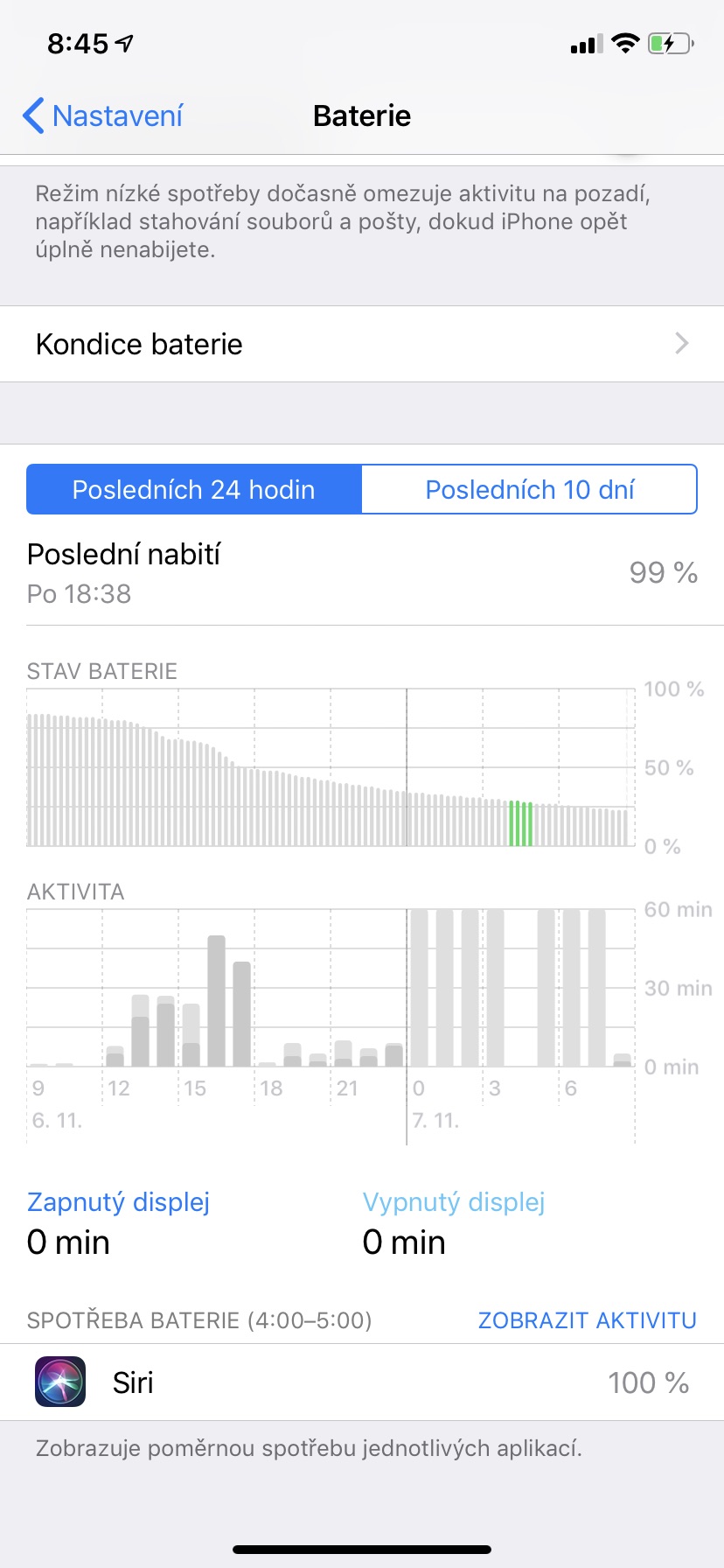

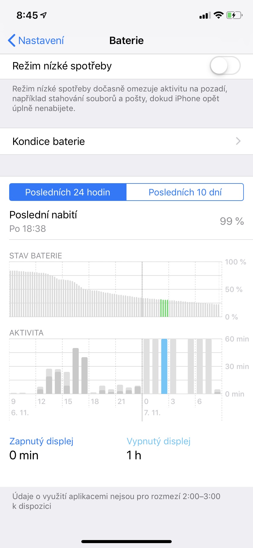

So with turned off screen time. 9 hours long night.
iPad Pro 10,5” 4% battery drop
iPhone Xr 13%! battery drop
Only between 4-5 AM it shows Siri using battery. Any other hour it does not show any app.
