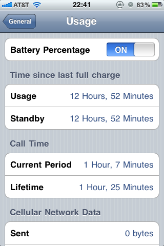

My gf's iPhone 3gs for some reason never fully goes into standby, as in when it's in standby it still thinks it's being used. This causes her phone's battery percentage to drop 40% over night. It is a recurring event, and I have tried restoring from a back up, and the problem went away for awhile but it is back again. Here's pictures of what I mean.
Before Bed

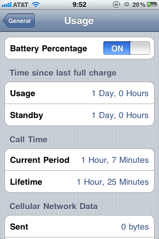

After Bed
As you can tell battery dropped 40% and when the iPhone wasn't in use it still thinks it was.

I would think that there is an app or something running that is causing this. What apps are running in the Multitask bar? Have you tried clearing the Multitask bar and retesting?

You might also put it in airplane mode at night, if that clears it up, then that would prove that something, has been using the internet, when you are not expecting it to.

She tried the airplane thing and it worked. So is there a way to check to see what is using the internet continuously without being open? I mean the only thing I can think of that would do that is mail, but it's set for fetch every thirty mins and not push.

You might turn fetch off, and just set it to manual, until you get this figured out. Without knowing what apps that you have running, it would be just a guess. The only thing that I know to do now, since we know that it it most likely an app that is doing it, is by the process of elimination. Start removing apps until you find it.

I agree about the location services, the arrow would certainly tell you. What is strange about this though, is that whatever it is allows the phone to sleep, but not to go into standby. It acts like the ipod, but when the airplane mode stopped it, that totally eliminates anything that doesn't use the internet. How many apps does she have on there that use the internet? Another thing that you might do, is close any open Safari pages.

Does it still persist for you when airplane mode is on? I might check that about wifi and cell data off to see if it persist with that setup because it doesn't persist with airplane on.
Hey I just checked with wifi and data off and the problem was still there. That means that it's not an application using internet, because the internet is off. This means that it has to be a cell tower communications thing. Like you are in an endless loop of getting some sort of cell transmission be it a voice mail, call, or text.
Wow...That really narrows it down. My money would be on Voice Mail. I don't think that it would be trying to resend a text that failed.
