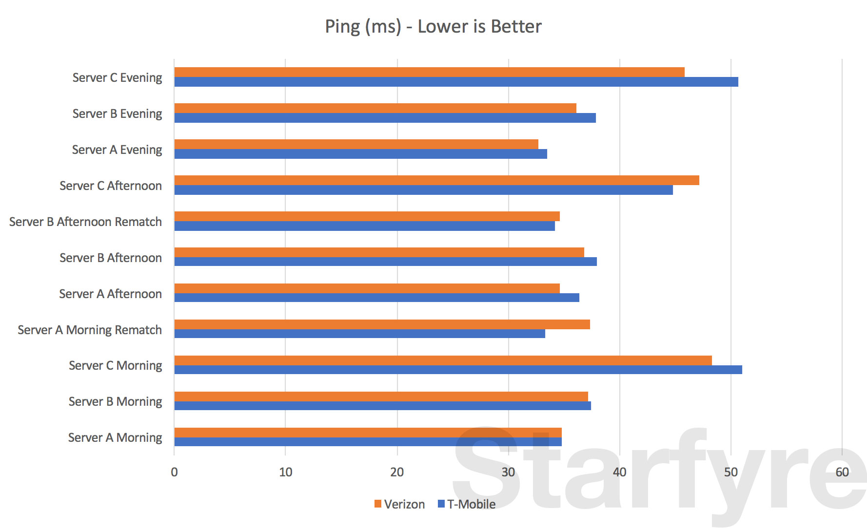

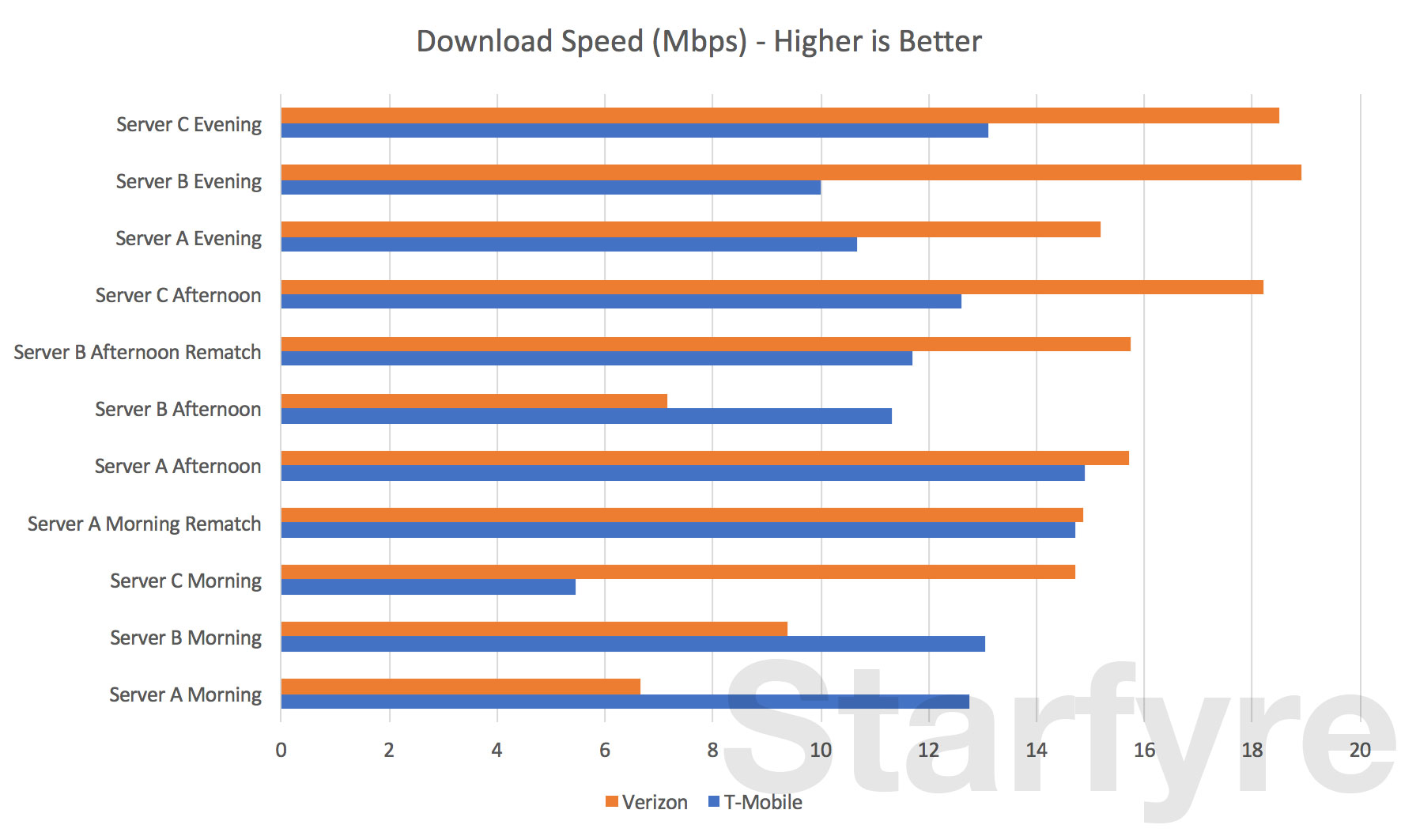

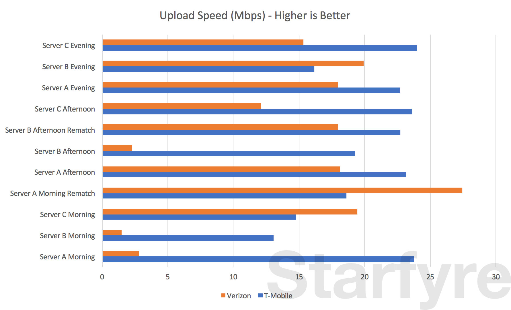

Pretty Results Up Top (Graphs), 11 Rounds Total, names of each round on left side
Download Summary:
Qualcomm beats out T-Mobile/Intel on 8 rounds. Intel wins 3 rounds.
Download Winner: Qualcomm
Ping Summary: Qualcomm beats out T-Mobile/Intel on 7 rounds. Intel wins 3 rounds. Qualcomm is tied with Intel in one round.
Ping Winner: Qualcomm
Upload Speed Summary:
Intel wins 8 rounds. Qualcomm beats out T-Mobile/Intel on 3 rounds.
Upload Speed Winner: Intel

Round 1
T-Mobile Server A
Avg Upload: 23.776
Avg Ping: 34.8
Verizon Server A
Avg Upload:2.784
Avg Ping: 34.8
Round 1 Results:
The Verizon/Qualcomm lost badly on all fronts except for ping, which is tied. T-Mobile wins.
Round 2
T-Mobile Server B
Avg Upload: 13.046
Avg Ping: 37.4
Verizon Server B
Avg Upload: 1.478
Avg Ping: 37.2
Round 2 Results:
The Verizon loses yet again miserably to T-Mobile and barely wins on ping.
Round 3
T-Mobile Server C
Avg Upload: 14.773
Avg Ping: 51
Verizon Server C
Avg Upload: 19.45
Avg Ping: 48.33
Round 3 Results:
With the far off server, Verizon takes the lead and obliterates T-Mobile on all fronts!
Round 4
T-Mobile Server A Rematch
Avg Upload: 18.62
Avg Ping: 33.33
Verizon Server A Rematch
Avg Upload: 27.43
Avg Ping: 37.33
Round 4 Results:
Qualcomm crushes Intel on download speed, and obliterates Intel on all fronts!
Morning Summary:
Out of 4 rounds, the Verizon/Qualcomm model performed better on the download speeds on the latter 2 rounds, the T-Mobile/Intel won the first two. Qualcomm seems to perform better on the "far off" Server C compared to T-Mobile. There is some variability, as in Server A, the Qualcomm lost the first round, and won the rematch.
Afternoon
Round 5
T-Mobile Server A
Avg Upload: 23.146
Avg Ping: 36.4
Min-Max Download: 12.11 – 16.48
Min-Max Upload: 21.93-25.69
Verizon Server A
Avg Upload: 18.11
Avg Ping: 34.6
Min-Max Download: 11.22 - 17.68
Min-Max Upload: 12.24 - 20.81
Round 5 Results:
Qualcomm had the higher average download speed, though T-Mobile was better on the upload. The max download was higher on the Verizon/Qualcomm.
Round 6
T-Mobile Server B
Avg Upload: 19.25
Avg Ping: 38
Max-Min Download: 6.03 - 18.2
Max-Min Upload: 18.64 – 19.61
Verizon Server B
Avg Upload: 2.25
Avg Ping: 36.8
Min-Max Download: 5.35 - 9.27
Min-Max Upload: 1.99-2.58
Round 6 Results:
No contest. T-Mobile wins Server B. Verizon wins on average ping.
Round 7
T-Mobile Server B Rematch
Avg Upload: 22.718
Avg Ping: 34.2
Verizon Server B Rematch
Avg Ping: 34.6
Avg Upload: 17.95
Round 7 Results:
Verizon outperformed the T-Mobile version for download speeds, though T-Mobile beats out Verizon in upload speed. Verizon was barely slower for average ping, but only by 0.2.
Round 8
T-Mobile Server C
Avg Upload: 23.614
Avg Ping:44.8
Verizon Server C
Avg Upload: 12.104
Avg Ping:47.2
Results of Round 8:
Verizon beat out T-Mobile in download speeds significantly. T-Mobile won on upload speeds by almost double!
Evening
Round 9
T-Mobile Server A
Avg Upload: 22.68
Avg Ping: 33.5
Min-Max Download: 5.58 - 14.12
Min-Max Upload: 19.28 - 24.33
Verizon Server A
Avg Upload: 17.97
Avg Ping: 32.67
Min-Max Download: 11.74-18.87
Min-Max Upload: 9.43-21.67
Results of Round 9:
Qualcomm wins out again on download and ping, but loses wins on upload speed!
Round 10
T-Mobile Server B
Avg Upload: 16.18
Avg Ping: 37.86
Min-Max Download: 4.79-15.00
Min-Max Upload: 1.09-24.06
Verizon Server B
Avg Upload: 19.92
Avg Ping: 36.14
Min-Max Download: 14.31-24.02
Round 10 Results:
Verizon wins in all categories, and beat out T-Mobile severely on download this time. It even wins on upload speeds too! The minimums and maximums are higher on Verizon too!
Round 11
T-Mobile Server C
Avg Upload: 23.97
Avg Ping: 50.67
Min-Max Download: 10.48-17.91
Verizon Server C
Avg Upload: 15.326
Min-Max Download: 14.37 - 21.04
Round 11 Results:
Qualcomm wins out on ping, and crushes Intel on download speed, and beat out Intel severely on download again. Intel makes a comeback with a vengeance on the upload speed.
Congratulations and thank you for reading to the end! Post what you think! Let me know if you have any questions!

T-Mobile Server A
Avg Upload: 23.776
Avg Ping: 34.8
Verizon Server A
Avg Upload:2.784
Avg Ping: 34.8
Round 1 Results:
Round 2
T-Mobile Server B
Avg Upload: 13.046
Avg Ping: 37.4
Verizon Server B
Avg Upload: 1.478
Avg Ping: 37.2
Round 2 Results:
Round 3
T-Mobile Server C
Avg Upload: 14.773
Avg Ping: 51
Verizon Server C
Avg Upload: 19.45
Avg Ping: 48.33
Round 3 Results:
Round 4
Avg Upload: 18.62
Avg Ping: 33.33
Avg Upload: 27.43
Avg Ping: 37.33
Round 4 Results:
Morning Summary:
Afternoon
Round 5
T-Mobile Server A
Avg Upload: 23.146
Avg Ping: 36.4
Verizon Server A
Avg Upload: 18.11
Avg Ping: 34.6
Round 5 Results:
Round 6
T-Mobile Server B
Avg Upload: 19.25
Avg Ping: 38
Verizon Server B
Avg Upload: 2.25
Avg Ping: 36.8
Round 6 Results:
Round 7
Avg Upload: 22.718
Avg Ping: 34.2
Avg Ping: 34.6
Avg Upload: 17.95
Round 7 Results:
Round 8
T-Mobile Server C
Avg Upload: 23.614
Avg Ping:44.8
Verizon Server C
Avg Upload: 12.104
Avg Ping:47.2
Results of Round 8:
Evening
Round 9
T-Mobile Server A
Avg Upload: 22.68
Avg Ping: 33.5
Verizon Server A
Avg Upload: 17.97
Avg Ping: 32.67
Results of Round 9:
Round 10
T-Mobile Server B
Avg Upload: 16.18
Avg Ping: 37.86
Verizon Server B
Avg Upload: 19.92
Avg Ping: 36.14
Round 10 Results:
Round 11
T-Mobile Server C
Avg Upload: 23.97
Avg Ping: 50.67
Verizon Server C
Avg Upload: 15.326
Round 11 Results:
