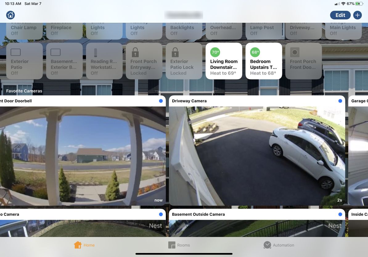

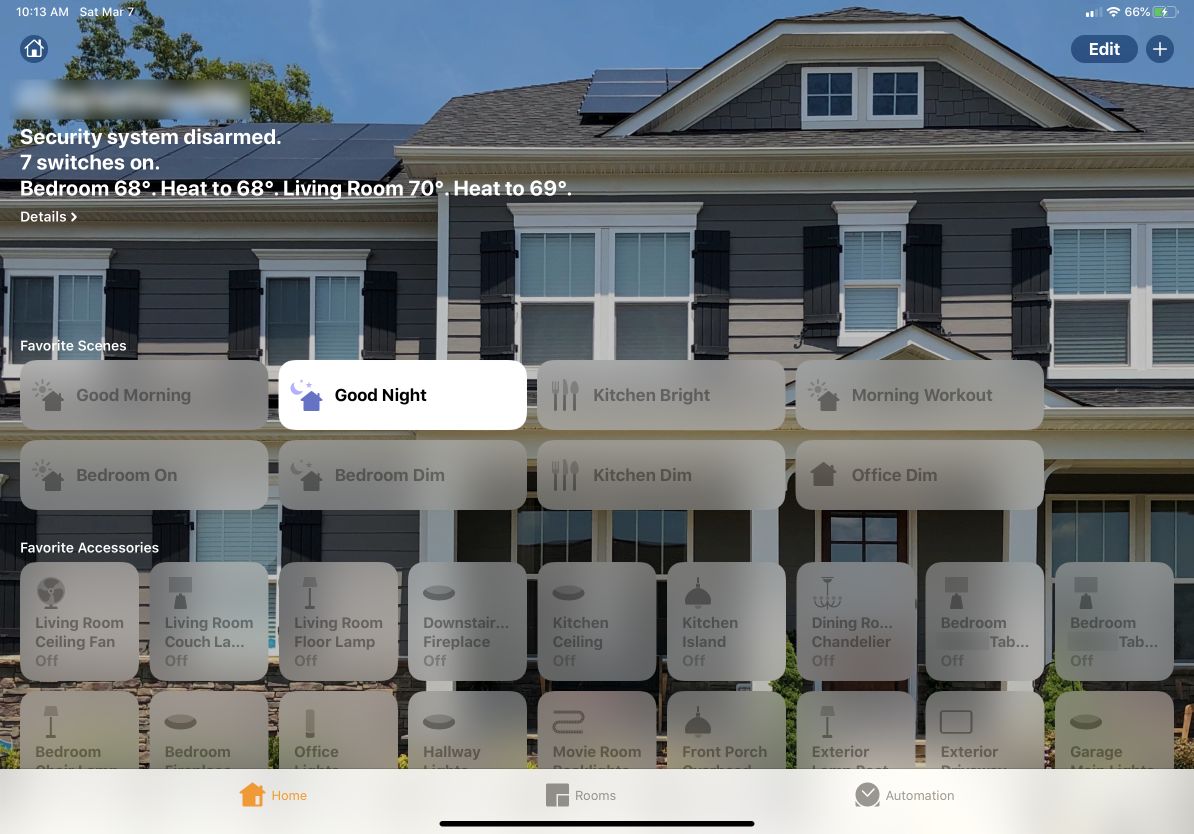

I ordered a Starling Home Hub a couple months ago and my device was finally delivered. The little thing is amazing. It's a 2" cube that connects to a home network with an ethernet cable and enables virtually all Nest products to connect to Apple HomeKit. Virtually plug & play - just need to authenticate the Nest or Google account.
Everything shows up on the Apple Home app on my iPhone/iPad. My two Nest thermostats, 7 cameras (including a Hello doorbell), two Nest x Yale locks and my Nest Protect smoke detectors. I can also arm/disarm my Nest Guard, and the occupancy sensors on the Nest Thermostats are even supported and their status is displayed on the status bar of the Home app.

3) The biggest and maybe only advantage to having the cameras in HomeKit is for automations and scenes. For example, I have my front door unlock when my Nest Hello recognizes my face. Can also have lights turn out outside, like a spotlight, if someone approaches that isn’t recognized. Maybe turn on a certain light when a package is delivered, etc... I also like to have all my cameras in one app so I can stream any one without leaving the app.
One thing to note with regards to scenes and automations is the developers at Starling just exposed the doorbell wall chime as a tile in HomeKit which lets you turn it on an off. I believe this only works with electrical chimes, which I use but not 100% sure. Where this feature shines, for me is I set up an automation where if the last person leaves, the chime turns off. This way if someone rings my doorbell, it doesn’t excite my dogs. No reason for the doorbell to ring if nobody is home anyway. Basically everything the Nest can do is exposed as a tile in HomeKit. Facial recognitions for each person, package delivery and retrieval, occupancy, etc...

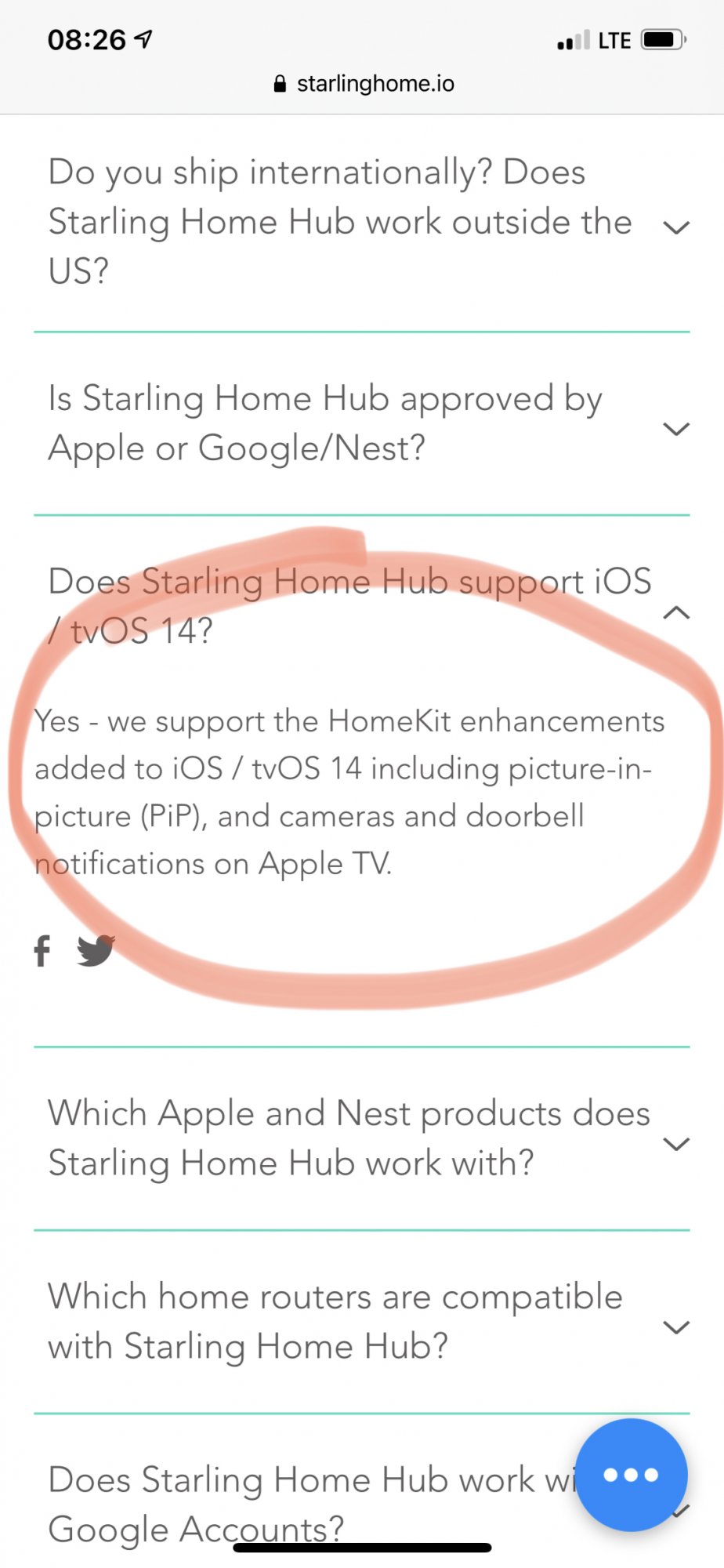

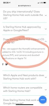

Came across this on their support page...
Thanks. I got my Starling and confirm it works connected via Ethernet to my Google WiFi point. I’m even powering it using a spare USB port on a nearby Airport Time Capsule (being used in bridge mode for Time Machine backups).
