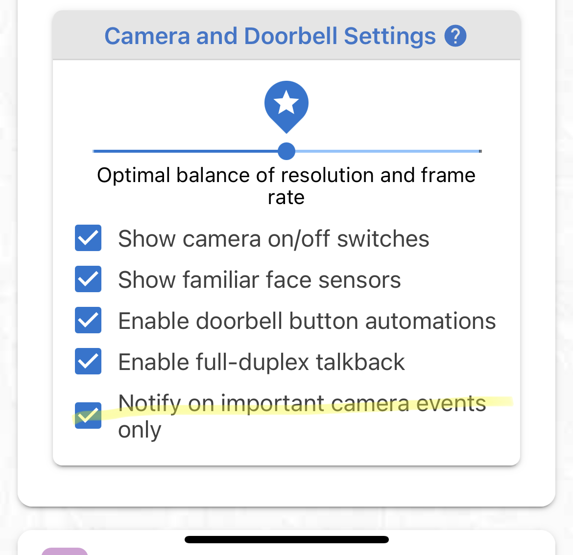

Are your Nest Hello camera notifications working at all in the Home app? For the past month or so, I can only get a notification when the doorbell rings. I get nothing when motion is detected. The accessory tiles do light up when it detects motion, person, etc. It just never sends a notification. I’ve contacted Starling Home Hub support, called Apple support, and I even deleted my home and re-added all of my devices. After all of that, it still won’t send me motion notifications. I’ve had to resort to the Nest app for the notifications.

Lastly, if you got to the online Starling Hub dashboard, there’s a setting that says “notify on important camera events only” Is yours toggled on?
It is toggled on. It does seem that somewhere during the life of iOS 14, something changed. I used to be able to “show separate tiles” in the camera to change notifications for each individual motion sensor. Somewhere along the way, that disappeared. And when they happened, poof…my notifications were gone. Here’s to hoping that iOS 15 fixes the issues!
Toggling it off might help then since it won’t limit which notifications you get.
