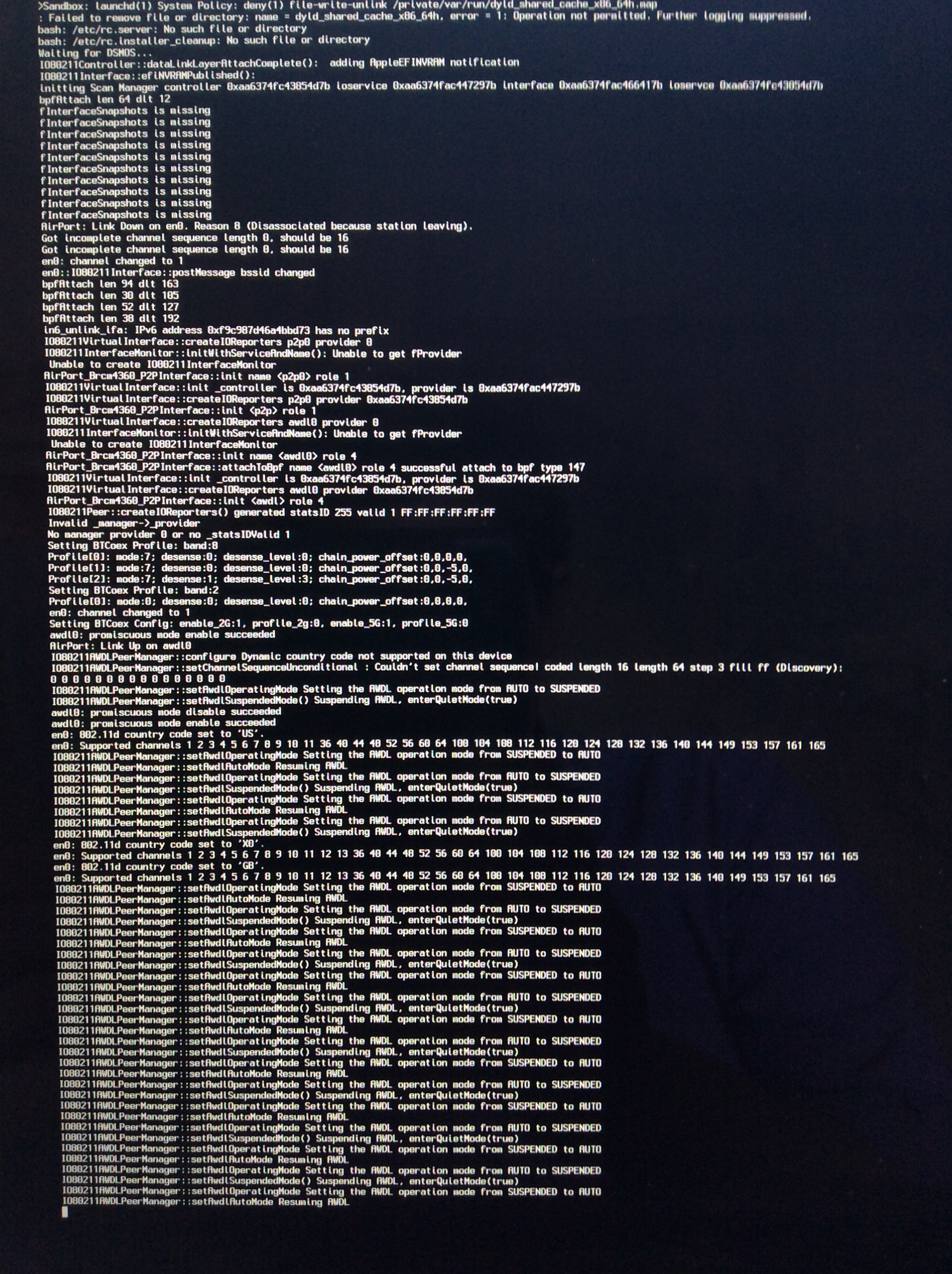

I'm having issues booting up my late 2013 rMBP having turned it off this morning and now back on!
The boot screen gets to the end of the status but hangs and doesn't go any further.
I've booted into Verbose mode and it seems the boot up until this point:
I080211AWDLPeerManager : : setAwdlSuspendMode() Susoending AWDL , enterQuietMode(true)
I080211AWDLPeerManager : : setAwdlOperatingMode Setting the AWDL operating mode from AUTO to SUSPEND
I080211AWDLPeerManager : : setAwdlAutoMode Resuming AWDL
The above message hangs and cycles through in a loop.
I've reset the PRAM and SMC but with no luck. I've attached a photo of the verbose boot screen.
Any ideas greatly appreciated!

DS is "don't steal" – see for example Slow boot caused by "Waiting for DSMOS" – but during that waiting period (as seen in your photograph) other things may occur. In other words, don't focus solely on the DSMOS symptom.
When you start Recovery OS and use Disk Utility, is the S.M.A.R.T. status verified?
When you try to start OS X, how long do you wait with verbose mode showing no progress?

So, having wiped my rMBP and restore from a Time Capsule, I have just updated El Capitan and on reboot, exactly the same thing has happened! It's still stuck on:
I008211AWDLPeerManager::setAwdlAutoMode Resuming AWDL.
I've got a genius appointment next week, but am at a loss as to how to fix this?
