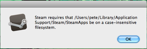

steam lost track of some of my game files.
I play eve the most which can be manually launched without steam however my symbolic link has gone missing and I got the following error when trying to relaunch steam.
I guess it should also be mentioned that moving my steam folder back to where it belongs did not result in steam working but rather an update box claiming to move game files that should already be where they belong
Well reinstalling hasn't worked, restarting didn't work now im asking valve
Ok Apparently this problem comes as a result of Steam Moving games to /Users/<username>/Library/Application\ Support/Steam/SteamApps
The Cure is to move the contents of the "Steam Contents" folder into the above folder.
This problem seems to only have occurred for me because i symlinked my steam game folders so it would not actually exist in my "Documents" folder.
Please note that before moving my games files I destroyed the first steam folder in application support which gave me an overly descriptive error which helped me figure this out.
