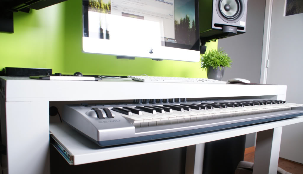

The Desk:

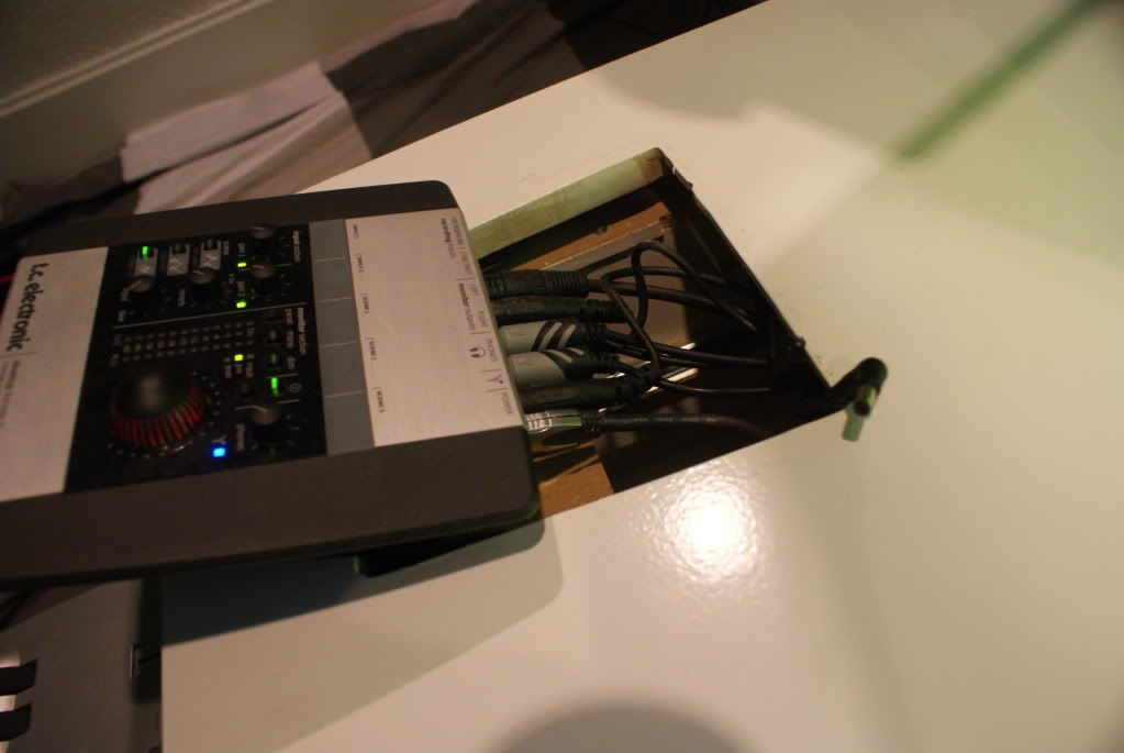

This was probably the most time consuming build i did. Got myself some MDF board. and started sawing. base coating and painting. it can hold my own weight. The audio controller is build into the desk, i needed some precision power tools to get a hole in it that would fit this device perfectly, and besides that. all the cables of the audio controller run through the wood of the desk. (as you see them coming out of the side of the desk) it runs on FW400 but since the late 2009 imac only has FW800 i put in a 400 to 800 cable to make it work.
cables from left to right:
Microphone XLR
L/R Line In (extended to side of desk)
Balanced Audio out L/R to monitors
Head phones out (extended to side of desk)
Firewire cable to iMac (400 to 800)
Power cable (not necessarily needed. since it also powers on FW)
(click to enlarge)
On the front of the desk theres a retractable shelf which has my keyboard on it. (it does not provide much space for your legs but u can still sit comfortable)

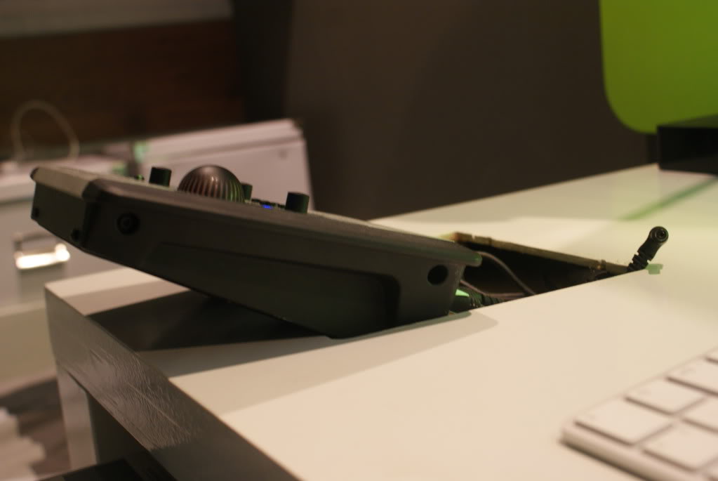

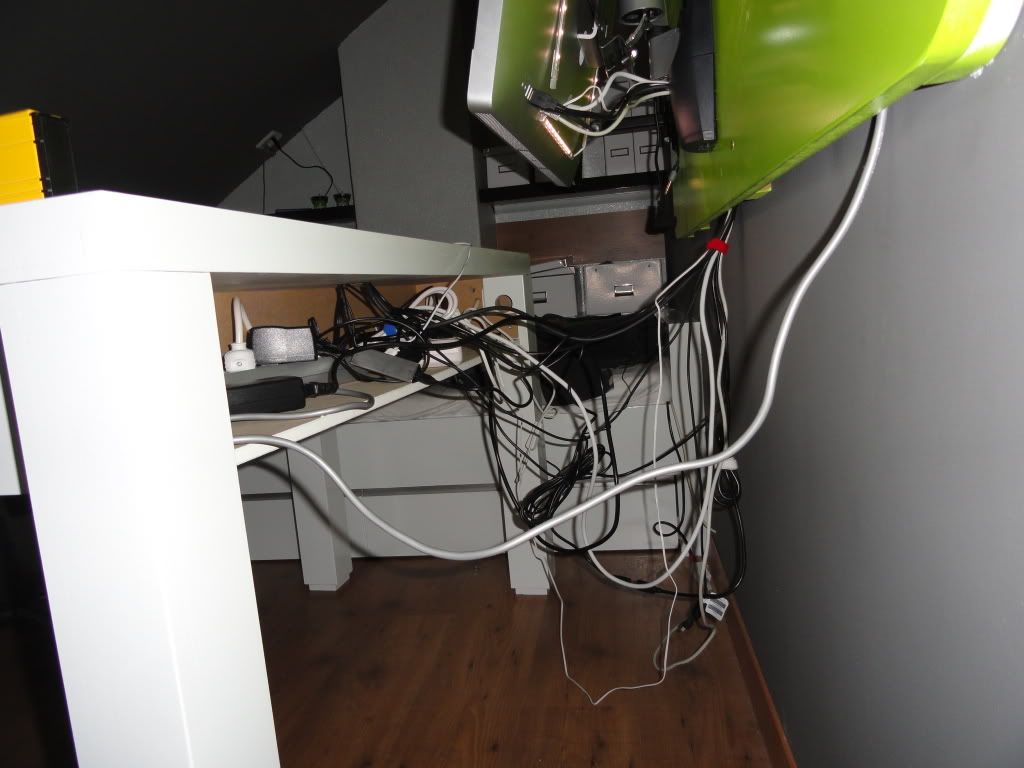

behind this board is a compartment which has all the cables of the entire setup. Also a ethernet cable runs down to the bottom of the desk. (100Mb/ps connection)
back compartment of desk: a 10 port USB hub, slave power switch (everything turns on at the switch of my mac) and a lot of cables.
(click to enlarge)

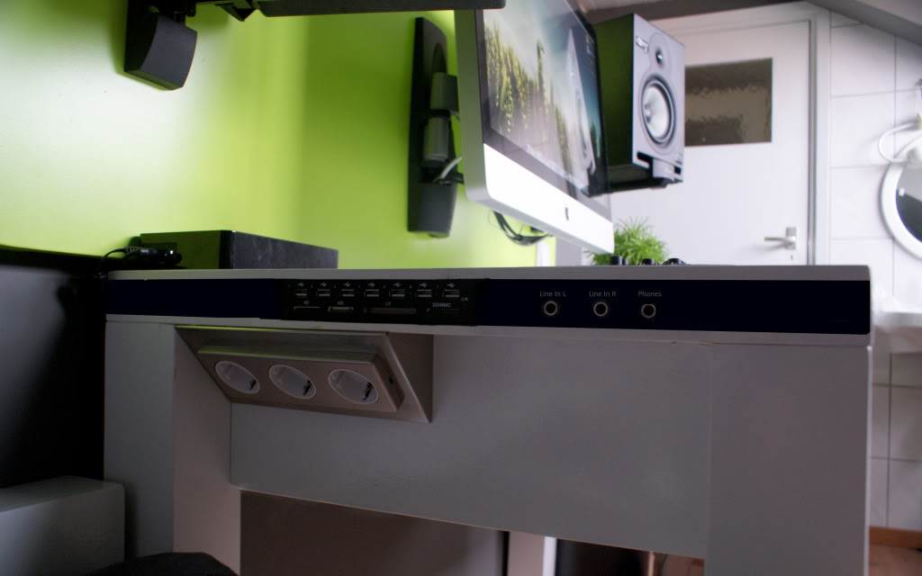

side of desk: for this i bought a 7 port usb hub wich had the card reader included. looked just like a black box with ports and nothing else. again used precision tools to get a hole in the side and glue it in. (running the cable through the wood of the desk to the back compartment)
3 power sockets where installed on the side. with a hole behind them to lead a cable with a plug to the back compartment. the L/R audio in port come from the audio controller. i just used an extension cable, drilled a hole in te side. and glued it into it. the same thing counts for the headphones output.
(click to enlarge) (the usb hub used to have red LED's soldered green ones inside 🙂

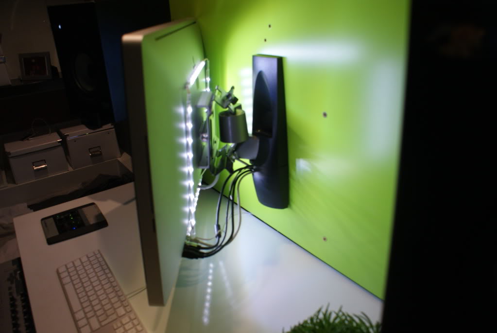

Mounting the beast:
why mounting? it gives an more open look and creates space. The mount i used is one by ''Vogels'' called the EFW6225. probably one of the only mounts that supports up to 35kg that has a VESA attachment. since the imac is only 15kg it is more then enough to support it. attaching apples VESA adapter is a hassle. but u do need one if u want to mount an iMac. After that i put some IKEA dioders on the back (the pure white ones). these give it a ''modern'' look instead of the colored ones.
(click to enlarge)

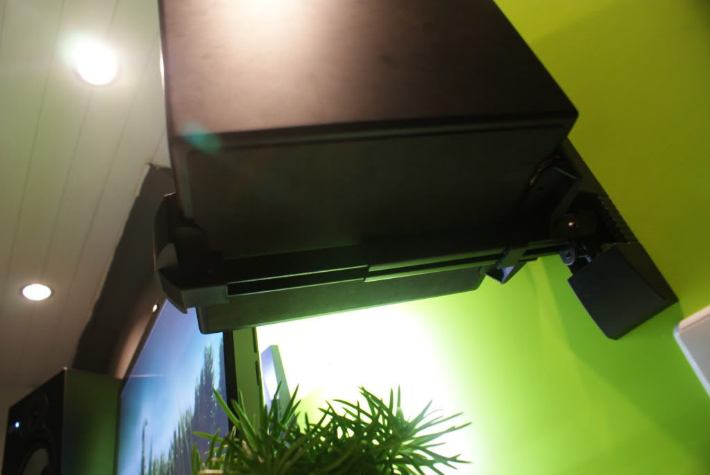

Sound mounting:
For my monitor speakers i used a lighter speaker mount by ''Vogels'', the VLB200. These mounts can hold up to 15kg per mount. Getting them on there was quite easy. be sure to level them out exactly. The speakers are connected with balanced TRS plugs. and they run behind the green board.
(click to enlarge)

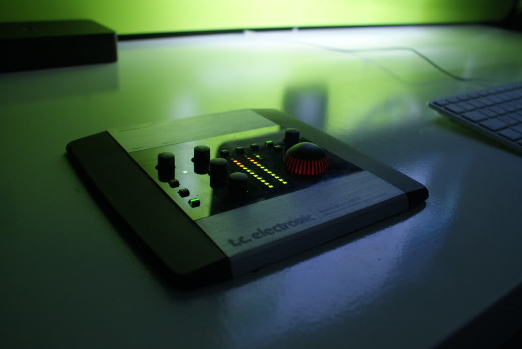

equipment:
27'' iMac i7, 8gb (late 2009 model)
KRK Rokit powered limited edition Classic (silver woofer)
Western digital Desktop elements 2TB
T.C. Electronic Desktop konnekt 6
