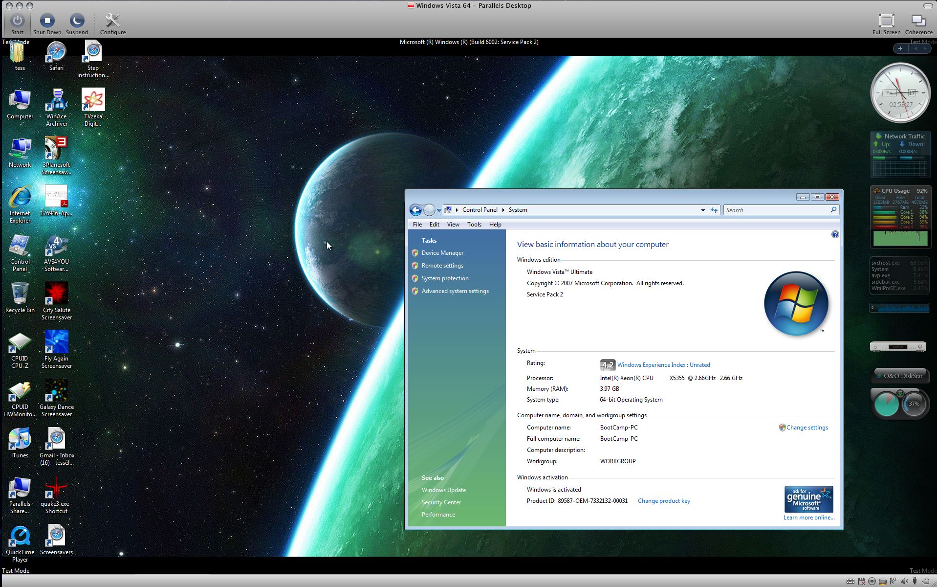

... Parallels will supposedly mount and boot from a BC drive
I found that Fusion is much faster and seems to integrate better. Fusion was written with Cocoa from the ground up. I believe Parallels has some legacy code in it.
It is a matter of preference though.
There's a strong possibility that you could be more right than I about this. I probably didn't give Fusion a fair try. I installed it and set up a VM. Booted and it hung and lagged so bad I just stayed with Parallels. But...
When I just now (in the post above) used Parallels again to VC the bootcamp drive it was the same story. Lag and hang. Until - I went through the settings and set it up right (for speedier performance). 😀 So I wonder what the experience would have been had I done that for fusion?
