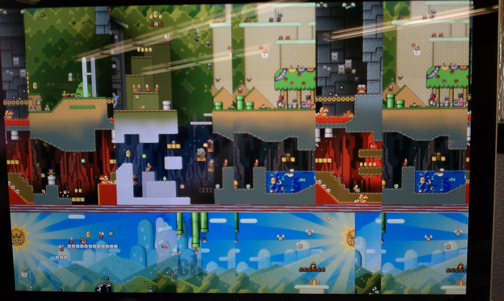

Before the recent Software Update 1.4 and EFI Firmware update, my external monitor (24" Apple Cinema Display) would occasionally go black for a few seconds and then the picture would return. It would do this just a couple times a day.
After the updates, it is still having this same problem. In addition, it is having a weird problem where the graphics look corrupted.

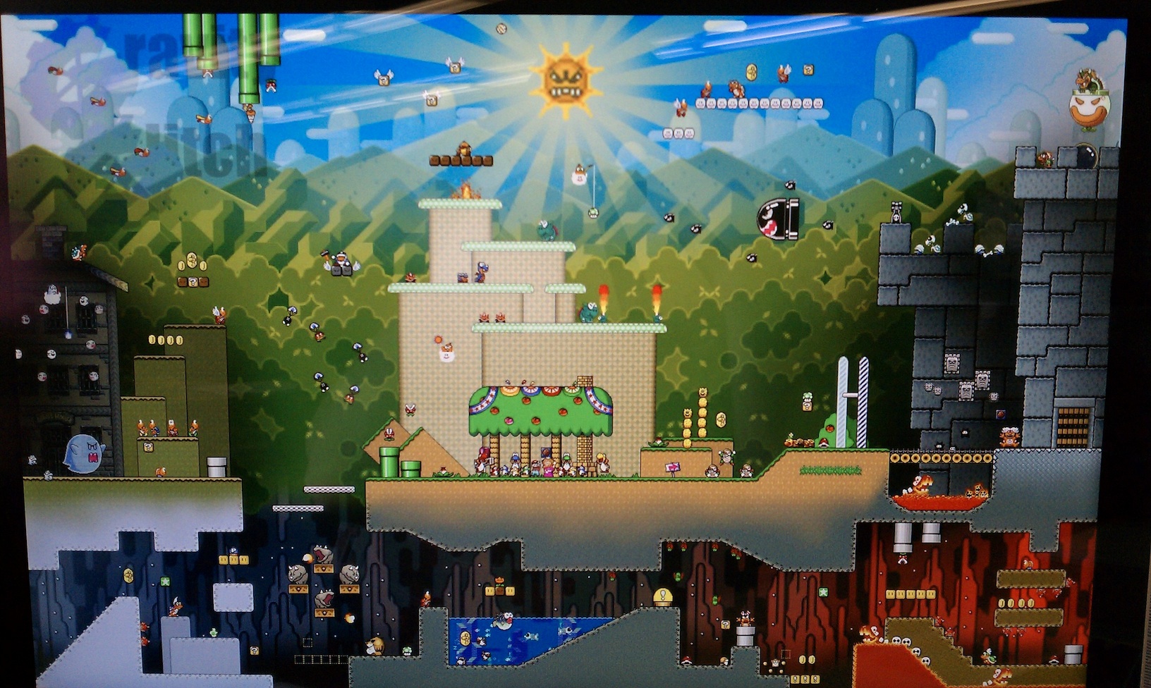

The second image is what it looks like normally.
So far, it seems all I have to do is unplug the mDP cable from the Thunderbolt port and plug it back in and it returns to normal.
Is anyone else having this same problem, even after the recent updates?
