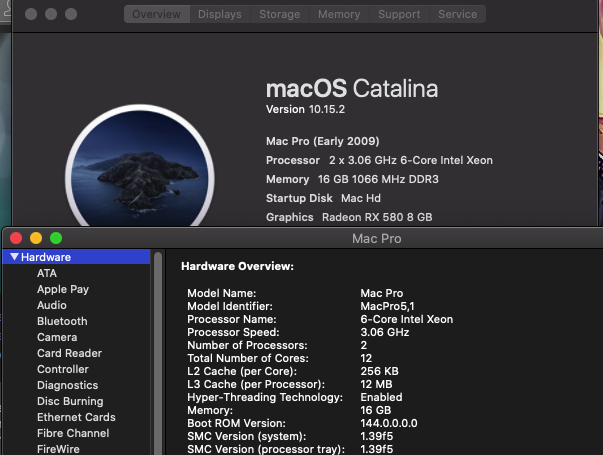

I would like to take a moment to thank everyone that addressed this audio dipping issue. I went out and bought a brand new rx580 8gb of ram :) having audio issue after this caused me to believe it was a power not being delivered right to my mac. Then i remembered it was converted from 4,1 to 5,1 so i thought it was a patch or something to do with the patcher patching my system for a 5,1 when i had a 4,1. but i ran across another thread somewhere where they also had audio issues so i was thinking its less to do with hardware and more to mac os. when i came across this thread i saw so many with my problem. so i bought 2 cpu @ 5675 for $22 bucks each. when i get it in ill put them in a vice and remove the lid on them. so this only set me back 45 bucks to do this fix. so if you dont think you you really need much cpu performance upgrade and just want to get a 4 more cores and a newer cpu its worth 45 dollars.
I'm only brining up 45 dollars to get 2 x 3.06 ghz 6 core cpu you wont break much of a bank. there are people who show a vice method to take the lid off and the vice method is said to be the safest. but you can find youtube videos showing how to install a lidded cpu in this mac and not break anything.
again Domo arigato!!!
[automerge]1577585768[/automerge]
here is my system information. its a 4,1 converted audio dipped as well.

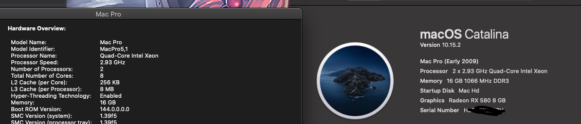

thank you everyone. when i was using clipstudio paint i would notice that i was getting a delay between strokes when i was drawing. but now with the new x5675 i dont get audio drops or any issues drawing. i think the cpu was choking not the audio. meaning that the cpu would stall this would explain why adding graphics cards and usb sound devices the audio would still be there. so this explains to me what happens with the x5500 series cpus. they would stall for a second causing the sound to dip.
again thank you guys for helping me out.
