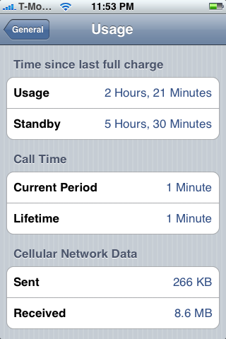

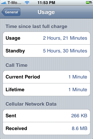

My battery is behaving very strange after updating to 2.1. So far since updating 2.1 this is what has happened:
1st time - I charged to 100% left it on standby overnight, all apps completely closed. I didn't use it until the next evening when I tried to turn it on it didn't respond. So I held down the power button and it gave me the no battery icon. I checked usage and it was way up around with the standby time, which I thought was strange because I definitely hadn't used it for that long. I didn't bother to screenshot it; I just dismissed it as a freak thing and I did a full charge (thus a cycle which should calibrate battery indicator).
2nd time - I used the iPhone the evening after I did the full cycle, and when I went to bed it had about half a charge and 2h. 21m. usage (see 1st pic). I wake up but I didn't use it until a slightly after 4:00 PM. So again I try to turn it on but it won't respond, I hold down the power button and once again I see the no battery icon. I plug the iPhone in the charger and immediately after it turned on I took a screenshot of the Usage stats (see 2nd pic) and as you can see it has 18h. 35m. of usage.
So I'm thinking something is running in the background, but I don't know what, I even did a hard reset after my full cycle to try and eliminate any background apps (or whatever it may be).
I know people are having cases of background processes running down their battery, but this has happened twice in a row, with a hard reset in between and a full cycle to make sure my indicator was accurate.
Tips, suggestions, conclusions? What do you think?

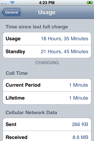

PS. If your wondering why in the 2nd pic I have no Carrier that is because I was trying to import SIM contacts from another SIM that doesn't work here hence no Carrier name.

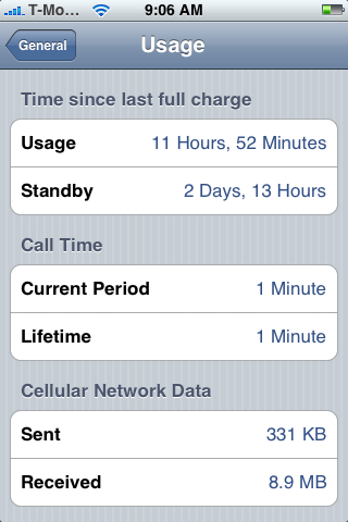

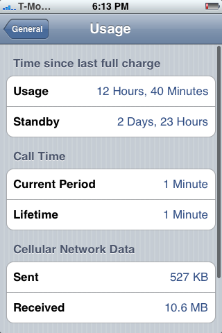

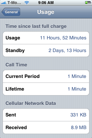

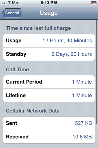

Update
I did another loose test:
9:06 AM: I took a picture of my usage (see 1st pic, take note of battery level) then put the iPhone to sleep.
6:13 PM (same day): I wake my iPhone and I immediately get the 10% warning, and my usage had changed and my data, so I suspect something was accessing data (see 2nd pic).
I had Push on, but I only received 2 or 3 simple text mails, but that doesn't explain the data usage. I mean 2-3 text emails can't equal 1.7 MB?
This is really starting to get frustrating. I'm going to do a hard reset, but if it persists then I'm going to try a full restore.

PS. I read a story where someone had the same problem, they restored but then the same problem occurred. If it was a software issue, wouldn't a full restore solve this problem? So does this mean it's something hardware related? I can't see how, but if it were hardware then it should disappear with a restore so... what is it?
