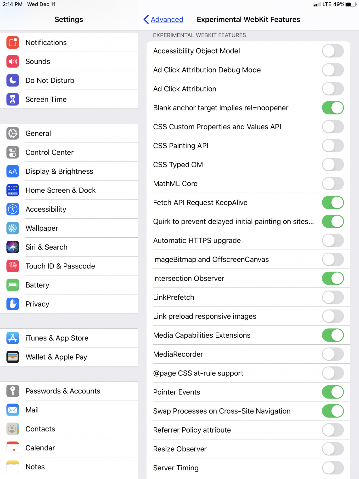

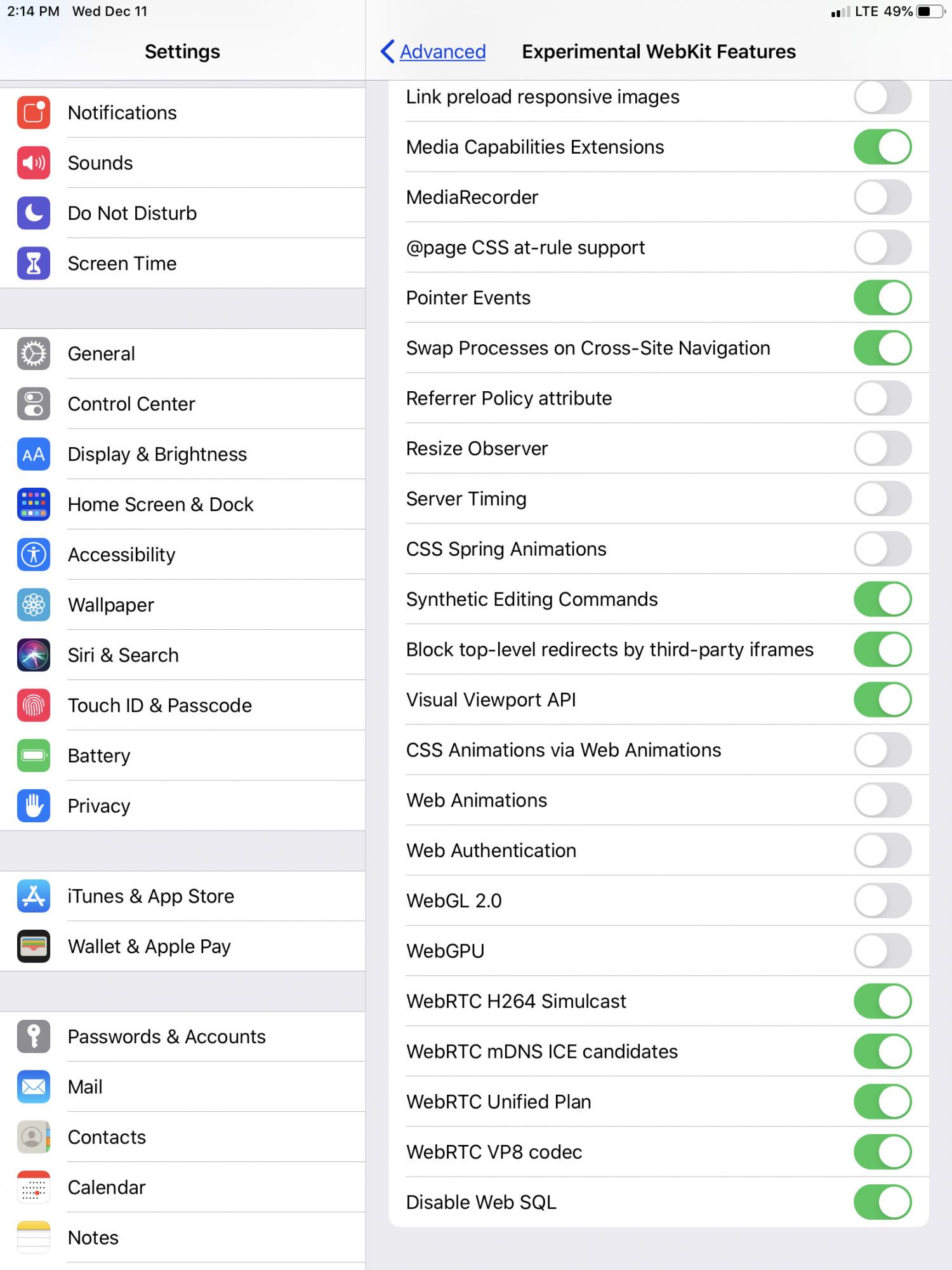

Curious, can you post a screenshot of Settings > Safari > Advanced?
My second gen 12.9 iPad Pro (A10X) renders the full animation in Safari.
