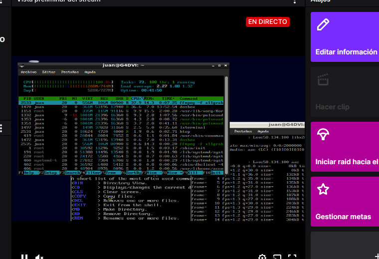

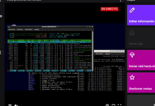

I have made it with my PB G4 DVI Running Debian 11 🙂 .. very unstable using wifi.. will try later with ethernet...
