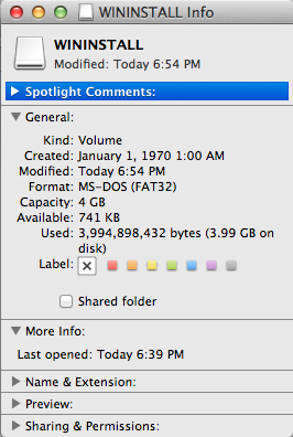

One tip for you guys. If you wanna know if you're stuck or not. Open the WININSTALL usb drive in your finder and go to SOURCES. Then right click INSTALL.WIM and click View Info, then check it's file size and remember it. This is the biggest file bootcamp has to copy to your usb and this takes long. If you check the file size of the USB drive itself, it won't update the used space because the file copy is not finished yet. If you check INSTALL.WIM a few minutes later, the file size should be bigger, it think the total size is a few gigs. If INSTALL.WIM isn't getting bigger, maybe reopen finder, but if it still doesn't get bigger bootcamp assistent might have a problem.
Thanks, that made me feel better that it's working! Actually mine hasn't even got to sources yet but I saw files being added. Nice to know. Damn, why is it taking so damned long though?
I just had this issue (have used bootcamp on this same computer without issue before) and just restarted my computer, and instead of having the thumb drive in a usb hub, I put it directly into the computer. Not sure which of the two solutions fixed my problem, but it's working now.
I was just having the same issue as it took a bit longer than I expected. Then I had an idea to check the actual progress by opening "Get Info" window for the flash drive. Right-click on your drive in Finder and select Get Info. Or simply select the drive in Finder and press Command + I. Screenshot attached.
You should see the available capacity getting smaller and that is when you know Bootcamp is actually copying the files. This the way you find out whether it's just taking long or if it's stuck for some reason. In my case I saw the capacity getting smaller, so thankfully it was just taking unusually long.

By golly, you're right.
Apple must be using the stupidest copying method of all time. They know they're copying to a USB stick, yet this insanely slow copy operation (here it's 1 hour plus and I'm at 40-ish percent) can only be explained by very small writes (e.g. the default 512-byte block size of olden times) with an immediate sync operation. Anyone even remotely knowledgeable about USB sticks (and other flash storage) will know that you need to update an entire physical storage block no matter the size of the write. And that block is at least 1 MB. Which means we might just be writing a 1 MB block 2000 times for each actual MB written. This is not just extremely slow, it's also really bad news for your USB stick.

I can confirm that you're indeed correct. I gave up on the flash drive (USB stick) after reading this and tried again with an external HDD. The transfer was done in <5 minutes instead of forever as in the case of the flash drive.
Solution: use magnetic storage
PS: The installation occupies approximately 4.8GB, so you'll need a 8GB drive at least (assuming storage steps are in binary).

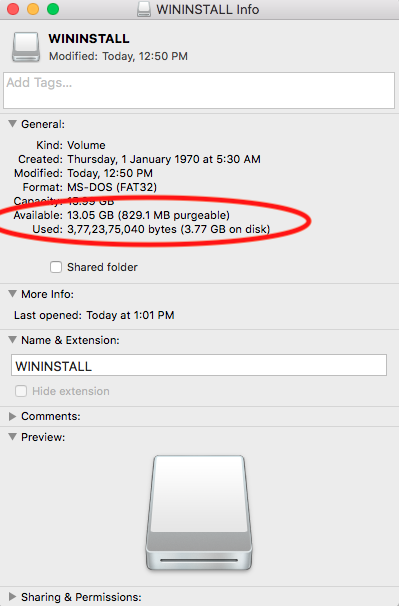

Actually, it's being downloaded the supported files. You can check this by right click on USB->getinfo and note down used file size and repeat.

The download depends, of course, on your internet connection.
The long wait time can be copying the files to your flash drive, both for the Win ISO and the boot camp support files.
