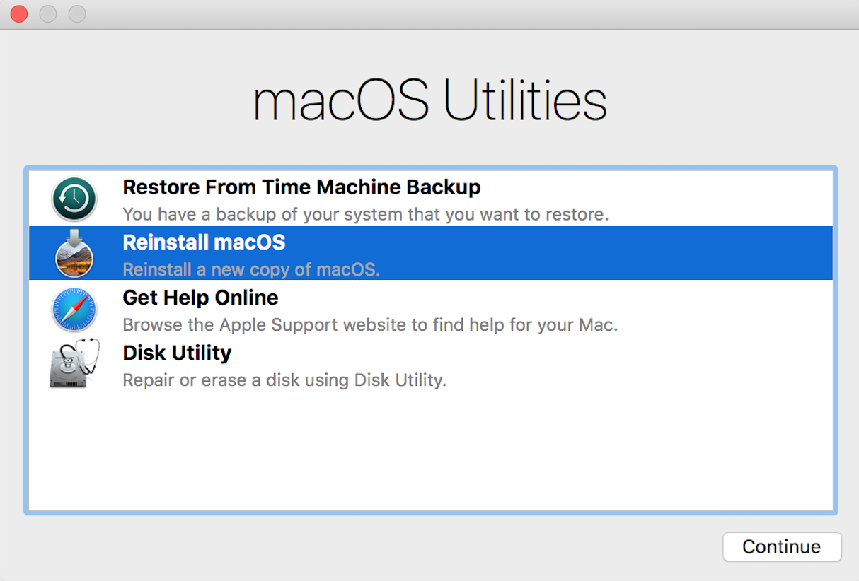

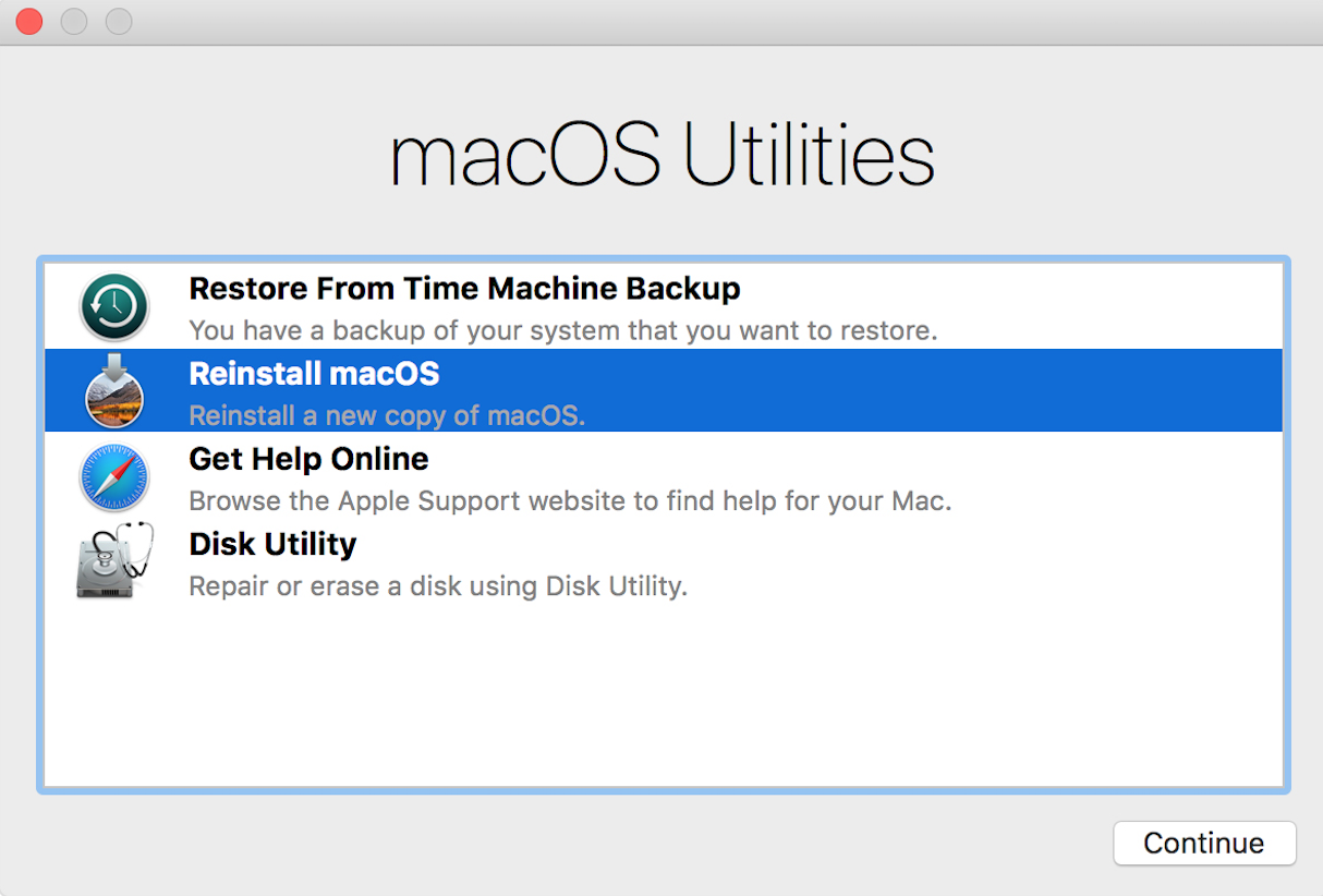

You should be prompted with "reinstall OS" through recovery as one of the troubleshooting options. Menu should look similar to this:
Is that not available to you?
As long as you do not proceed with a reformat, this installs a fresh copy of the OS on top of your existing. It tends to fix/resolve issues like you're describing.

It is available, yes. I was under the impression that it would overwrite everything with a fresh install, I'm gonna try it.

I ran the reinstall from recovery and that did the trick. So there was the solution, right in front of may face the whole time. As I mentioned, I just assumed that would install a fresh copy of the OS and I'd have to start from scratch, but everything appears to be right where I left it before all the troubles.
