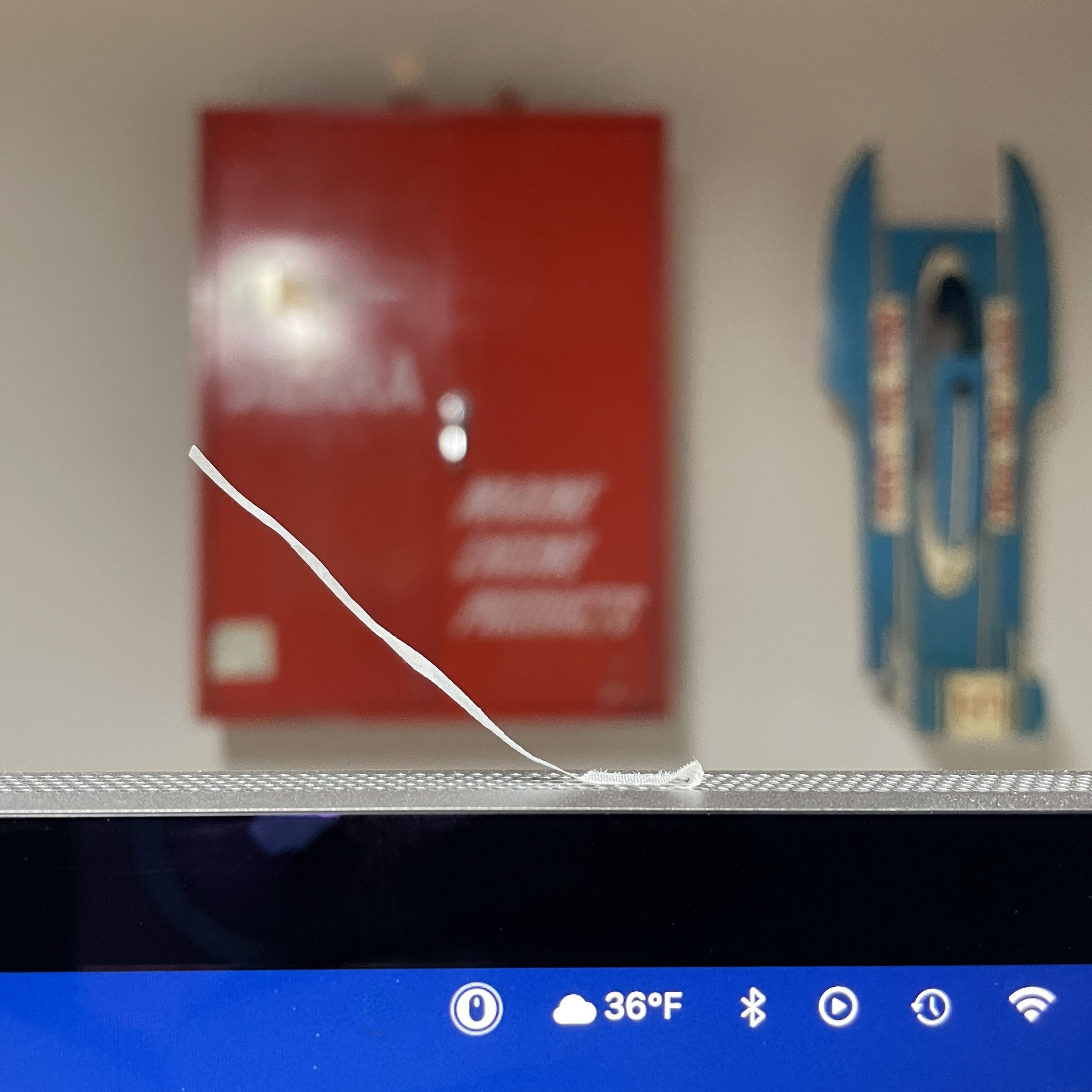

Issue: Both of my Apple Studio Display fans run 24/7 when connected to my sleeping Mac mini M4 (on all night long.)
Important: The fans are not audible. To see airflow, I have a thin piece of tissue paper attached at the vent about 5” from the edge. See uploaded image.
Resolution: The only solution I’ve found to stop the fans running is to unplug the thunderbolt cord, or to shut down the computer.
I’ve tried:
  • disabling “Ask Siri” and “Apple Intelligence”
  • unplugging all external peripherals
  • unplugging my Logitech G305 mouse
  • turning off bluetooth
Comments: In my opinion, constant fan operation when asleep is not intended – there is a bug in Apple’s software. I don’t see this as a serious issue – nominal energy use of say $10 USD per year plus added wear on display fans, which should last around 60,000 hrs. At night or when I'm away, I am curious what the best solution is... should I be unplugging the thunderbolt cord repeatedly, shutting down, or just letting those fans run all night long. I have vreported this to Apple from their feedback page but it appears others have tried that too.
Suggestion: Try the tissue paper trick before you decide if your fans are actually running.
I’ve tried:

last few days I've been testing this with the same method used above. thin piece of napkin taped to the top of the display.
every time I place the computer into sleep mode: fans go off
when I allow the display to time out itself to turn off: fans do not always go off. maybe 50% of the time.
one specific instance was I had a YouTube video playing in the background. display turned itself off after 5m. screen is off. audio is playing and the fans are on.
