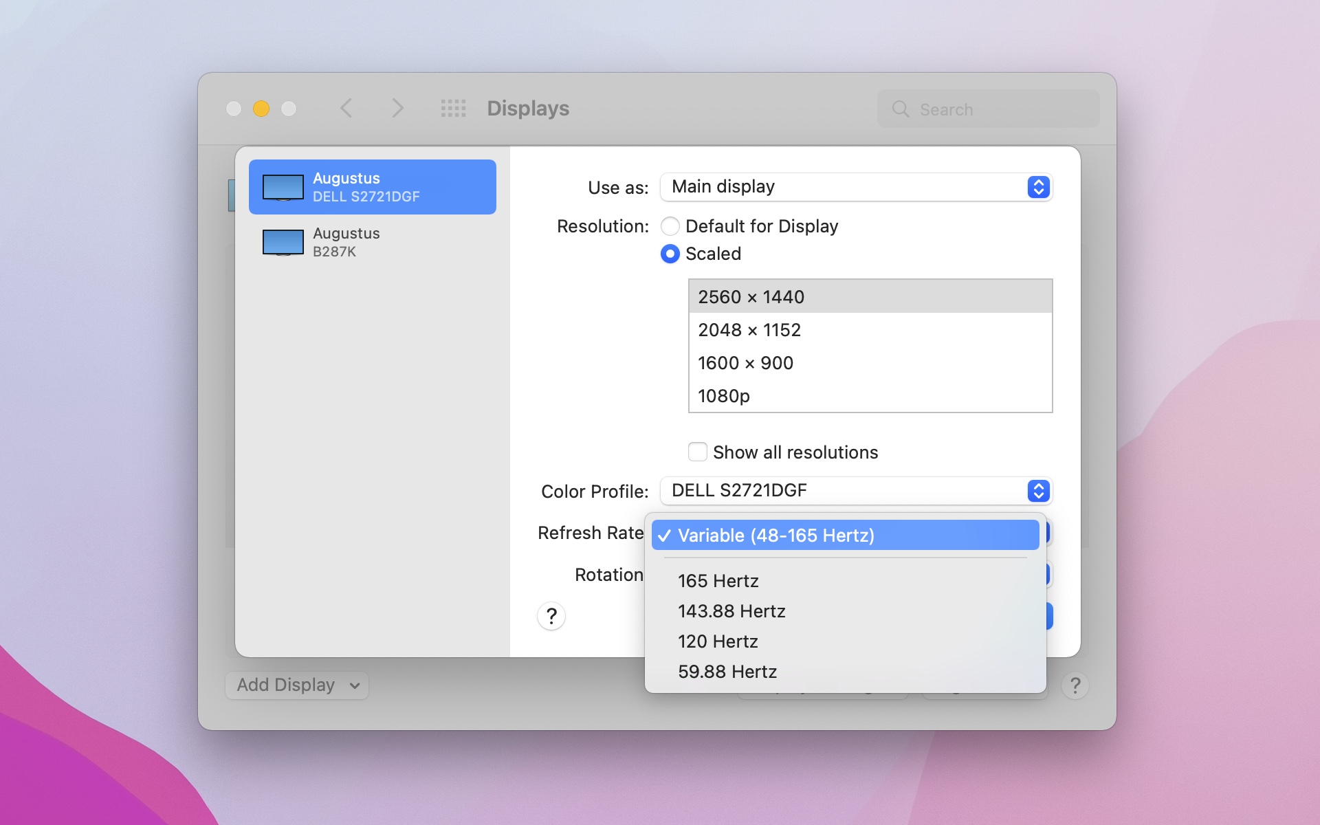

Do you have variable refresh rate selected in Display Setting?
If so, try to turn it off.
I felt a little hopeful when you suggested that (as it makes sense) but it's not an option when you select the display in System Preferences, and it doesn't appear at all on my Mac mini.
That said, the issue is definitely a lot worse on my MacBook Pro than the Mini.
Variable refresh rate is a known bug. It would look like this:
