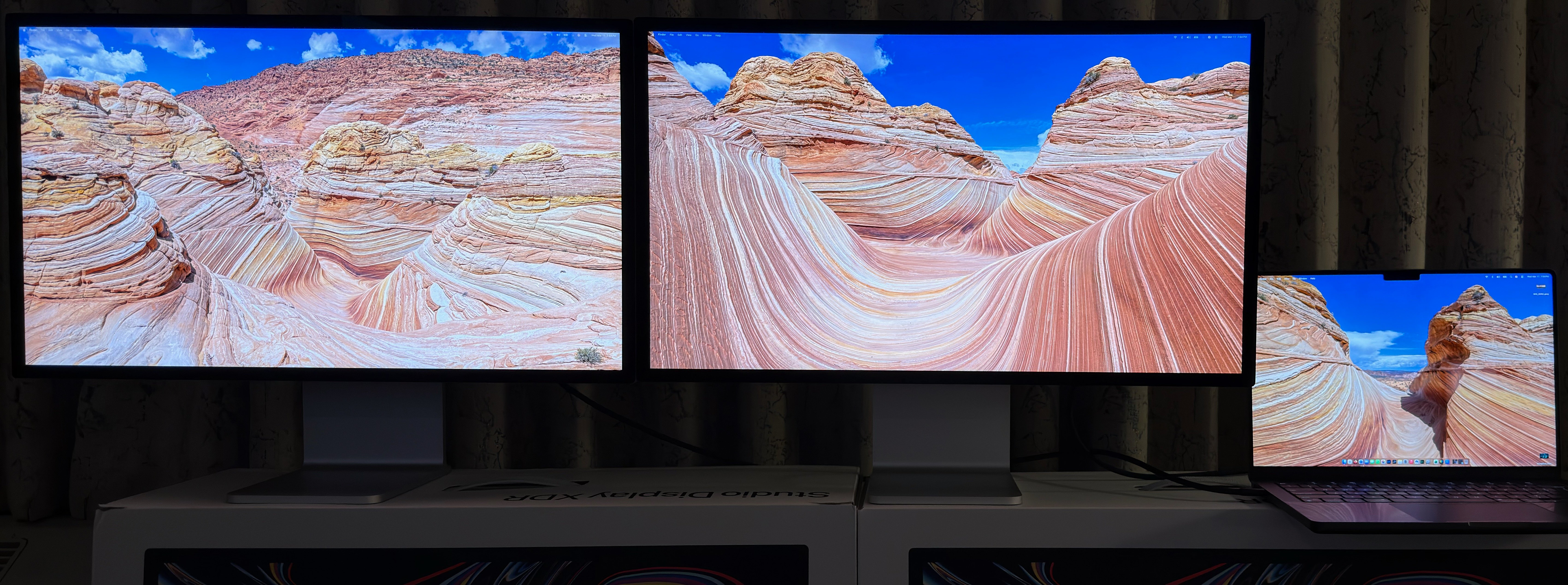

Got a pair of XDR. Connected to MBP 14" M4 Pro. On first try plugging both displays in directly to the MBP, only one screen would turn on (5K 47-120Hz). Unplugging the working XDR would turn on the other XDR. After rebooting MBP, both turned on, but each only at 5K 47-60Hz. I had thought, per Apple's description, one XDR would be 120Hz and the other would be 60Hz when both used together. Guess not? I have a M5 Max MBP14 coming next week. I have a M4 Max 16" MBP also but not on me right now, but that's supposed to support dual 5K 120Hz.
The XDR is really bright and stunning compared to the MBP. iPhone pics make the XDRs look washed out, but it's just a brightness difference. Speakers sound louder, bass a little stronger I suppose. Fans are silent, same as ASD, but by feel seems to have a lot more airflow output at max brightness.

I only briefly used dual SD XDR with M4 Pro MBP. Only reliable way I could get it to work was to unplug both monitors from power and plug them back in simultaneously while MBP was on and connected to both displays directly to 2 TB ports.
