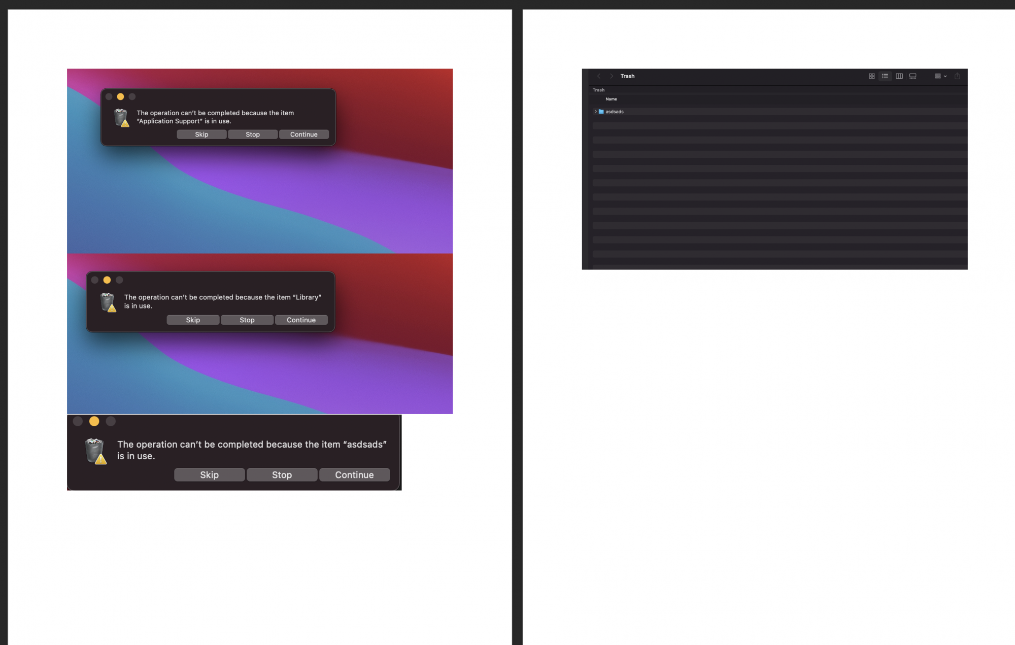

Looks like you trashed some things that should not be trashed...per Apple. They protect more and more with each OS, typically through hidden ACLs. One of the errors looks like a process or app is in use (file open, or app/service running).
If you can figure out what it is you can quit or kill the process. Then you may be able to delete.
First, are you sure these are not essential? If yes, you need to kill the process and/or change permissions to delete the files. Here is someone else wondering what about the same thing. If this is running (in use) you may be able to kill it via Activity Monitor.

the folder is empty in the trash and i cannot restore it? and i cannot delete it ?? i have no idea what process it belong to?

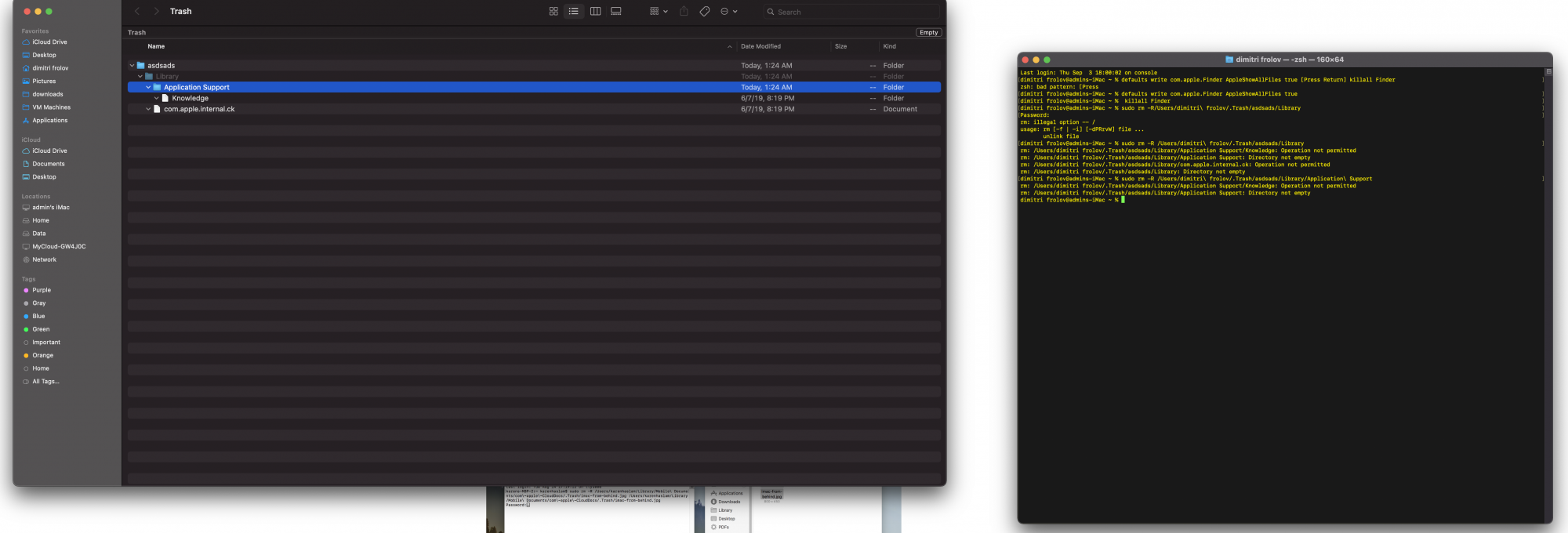

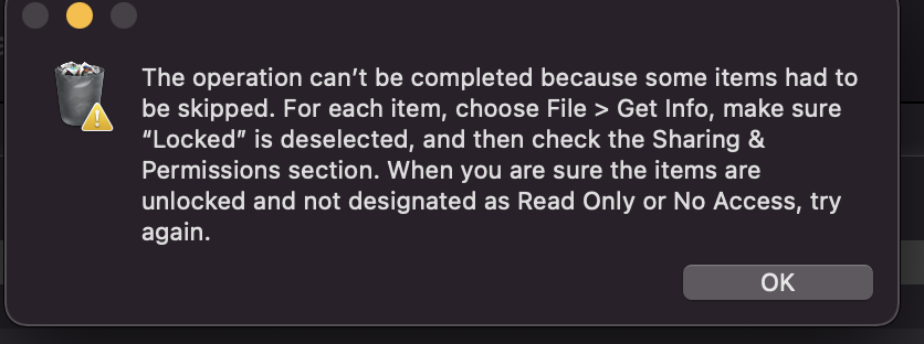

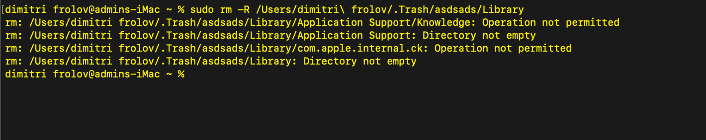

also get these if i try to delete the items but i only see a folder inside my trash can and i tried, to do this and its still same issue.... i need some hardcore commands via terminal, under root in recovery console maybe?

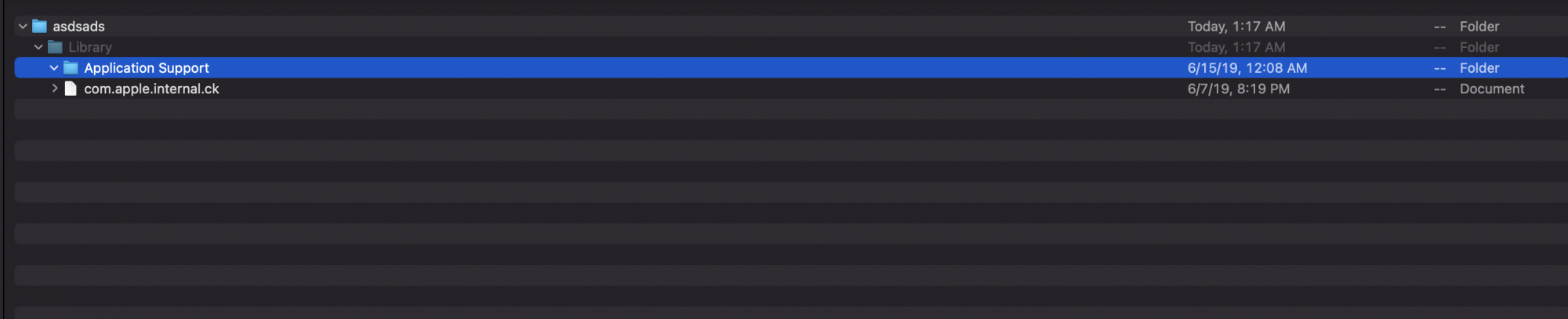

you right, now i see this?
As you have had these files a long time...have you already tried these options?
yes always comes back to not being able to delete them, but now since your commend i see entire folder and whats inside? maybe i should try again? not sure how it would make a difference but ill five it try again right now

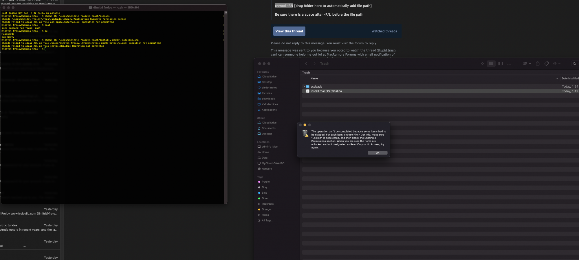

so i jsut now deleted an old installer and now i added another file to the bin that wont delete? its crazy, before it was just that one folder and other items would always delete, now catalina setup file is stuck in the bin also?
I would suggest sorting out the trash issue before adding more things to it. Keep the variables down.
