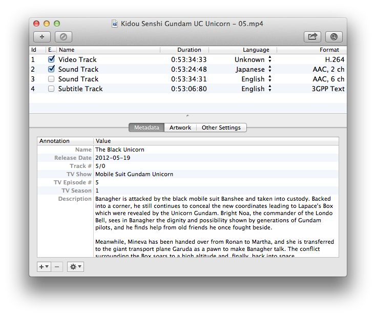

You need to enable only one track in this window:
If you enable more than one, of course you'll hear more then one audio 🙂
DASX are you following the correct sequence for
Subler.. It is simple but NOT intuitive
Each title you want to work is a project, so you must OPEN it, and then ADD the MKV you want to the window, there is a + sign upper left. Select the file mkv you want to convert. The file you wanted is now in the window. DO NOT mess with the sound tracks here... As long as they are all there, leave them ALL ALONE, dont worry about the right hand descriptors, they will be proper once you ADD the file. Once you click ADD lower right, that window appears to close and you are left with the window where you can modify or edit things. I found that you DO NOT mess with the sound tracks. you make sure that the Video and the FIRST sound track AAC are checked and then leave ALL of them as they appeared in the ADD window..In this new window you can highlight the video file which should be a form of H264. A window will open to allow you to change some parameters here. You will also notice in THIS window the sound track descriptors correctly identify the type of sound track you want. It is normally correct here. For ATV2 play you should show a video, an AAC track and some form of AC with the correct number of channels here. Under these will be any other tracks you wanted.
ALTERNATIVELY to begin, You can also drag a file to the empty subler icon or window and then hit the ADD button in the lower right. It will do the add function for you and leave you in the edit window described above.
IF you are working with a lot of 'Projects" you should use the que there is what looks like a curved arrow upper right.. hit it and another drop down offers a button lower right that "adds to the que". Once you hit that, go back to File NEW and open and hit the + sign to add a file or just drag a new mkv into the subler Icon and do the cycle again.
I was pulling my hair out with this thing for a long time, now have a great workflow, often doing 10 in the que at once while I just go away from it. The length of time to process depends on how you encoded the MKV files. They MUST be in some form of H264 for subler to work with them.
Good luck
