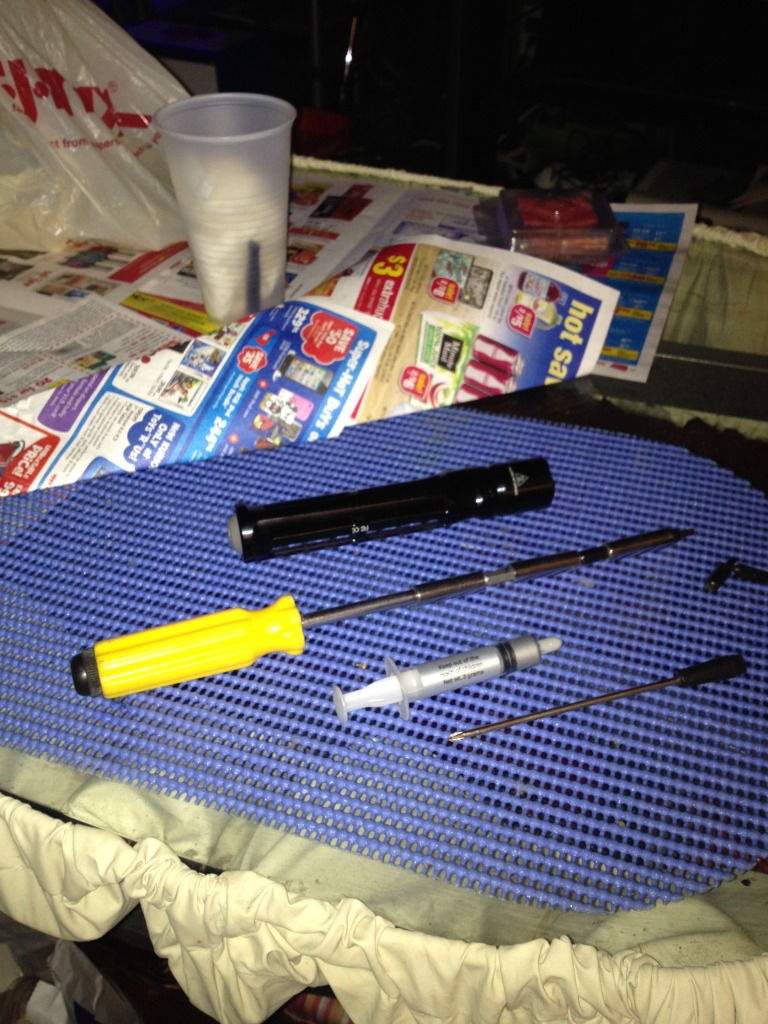

I successfully upgraded last night. Kudos to this thread! We followed that German video and man those two screws near the bottom are a sure-fire strip candidate. Even broke one of my screwdrivers haha. We were able to use pliers and get them off though. The combination of this and my SSD upgrade has things moving amazingly fast, thanks :). OH by the way...even if you are a knucklehead like me, please buy the long narrow torx or hex. I had to use two extenders with my screwdriver and miraculously (yet, barely) was successful!
